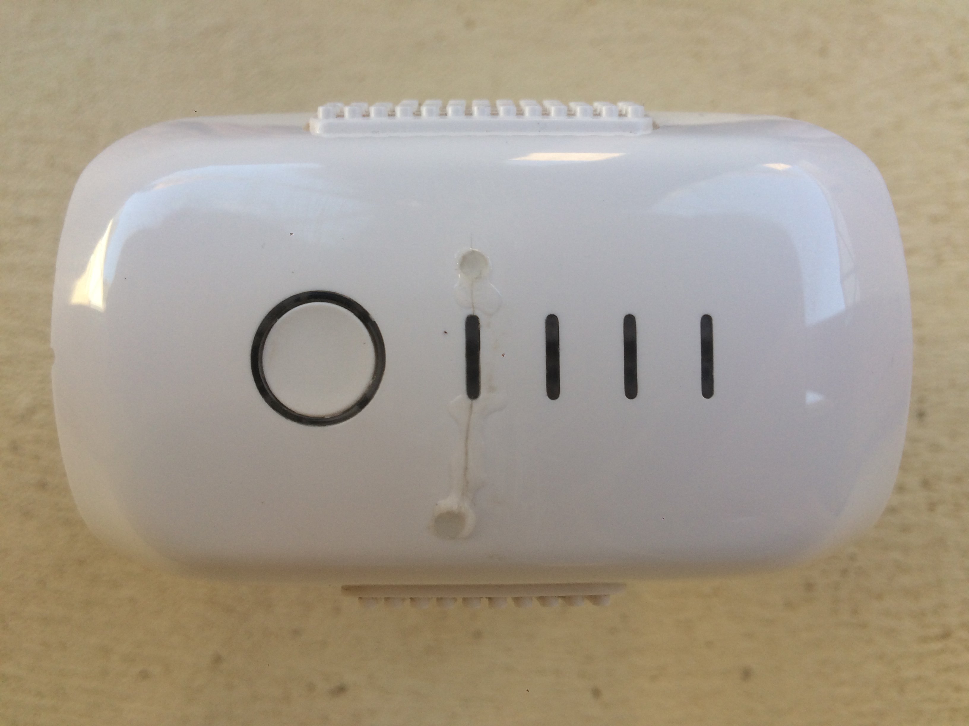

SAM_0736.JPG SAM_0736.JPG My P4 battery developed a crack too, less than 30 flights..not happy.
That crack isn't going to hurt anything. Fly them till the cells start to deviate.
Yes, but it's pretty crappy on an expensive drone with batteries that cost over $140 each. Especially when you realize that batteries of that size really aren't that expensive. You don't pay premium price for mediocre quality, just like you don't pay for a Mercedes where the leather on the seat rips within a few months and say, "Oh, that rip won't hurt anything."
