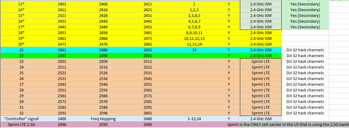

WARNING FOR THE 32-Ch HACK.
The channels 13 - 20 are the "stock" HD (Rx) bandwidths opened from the P4 to the RC. Some of us "hacked" the Rx RC band to be able to receive channels from 21 - 32..
Except for Ch 22, ALL the upper channels are used by Sprint cell carrier for the LTE 2.5G band. Sprint is the only cell carrier in the US to use the 2.5G band for their high band LTE data. The tower radios have an Tx/P output of 16W and a radius of about 1.5 miles from tower. If you set the RC on any upper channels and are close enough to the Sprint towers, the LTE signal will drown the RF from the drone to your RC. I have good luck with Ch 22 for now, but still have problems with GO app 3.0.0. If you have any questions about the upper channels ask me, I work for Sprint.
This is good to know, thx. However every time I fly, channel 32 is dead as a door nail, absolutely no traffic. Do you know if Sprint is discontinuing their 2.5 service soon, like other carriers?
Sprint is the ONLY US carrier with this band in use and no other carriers have/had it, no plans to kill it in the future.
2.5G was acquired by Sprint as it purchased Clearwire/Wimax Same was with 800MHz after Sprint acquired Nextel. Originally Sprint was (and still is) operating on 1900MHz (1.9G) but after some disastrous acquisitions in the telecom industry they decided to keep the frequencies...
2.5G is a high band with short wave and weak penetration but has the ability to carry a lot of data with little energy, well suited for video transmission on short distances. Variations of this band is used by the media trucks on location sending the video feeds to the news station. Disadvantages of this frequency is that is very close to the water molecule resonance frequency (cooking MW) and water absorbs it very fast. Also a long exposure to the 2.5G will make you see red since it will excite the water in the blood and affect the vision.
Remember that ANY connection that is not welded (soldered) is a loss of 0.75dBm to 1dBm. As you know, a 3dBm increase in power means the Tx power is doubled, as is any decrease of -3dBm the Tx power is cut in half.
I do not put a lot of faith is testing the Tx power through a solid connection (connecting the Rx meter to the RC by cable) since what you see is not the true RF power received by the drone. Also you can have the best and most ideal Tx RC reading BUT if the Rx in the drone is weak, all the calculations are off the table. Not to mention, is the P3/P4 equipped with an LNA (low noise amplifier) to filter out all the noise and unwanted RF in the area? What about the RC receiver (Rx) does it have an LNA? To improve Tx and Rx of any units, Rx diversity is needed and the Div Imb should not exceed 3dBm (diversity Rx is achieved by having 2 antennas capable of RF Rx and should be calibrated within 100mHz band separation). In DJI case, RC and drone have ONLY 1 Tx and 1Rx antenna which makes it a low ball RF unit.
