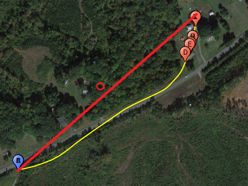

FOUND IT!! That's about the only good news I have. I went back through the woods again before it got dark last night and I found it laying props down with the battery sitting about 10 feet away. It wasn't far off of msinger's line at all which means I either walked right by it on the previous walk or it blew out of the top of a tree. I marked the area I found it in on the pic below. I'm still confused as to how it managed to clear 95% of the trees that were the same height as the ones in the area where it came down.

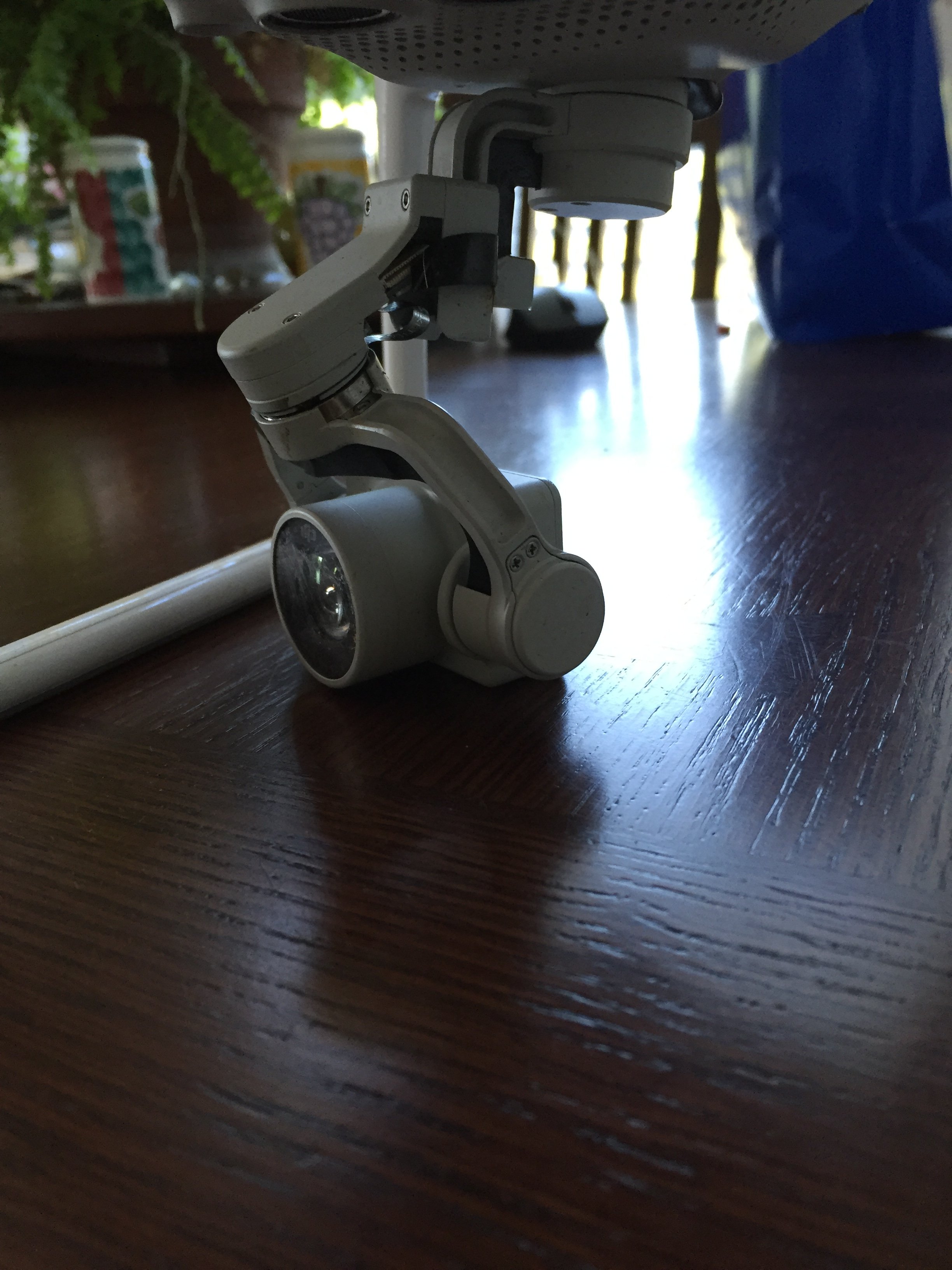

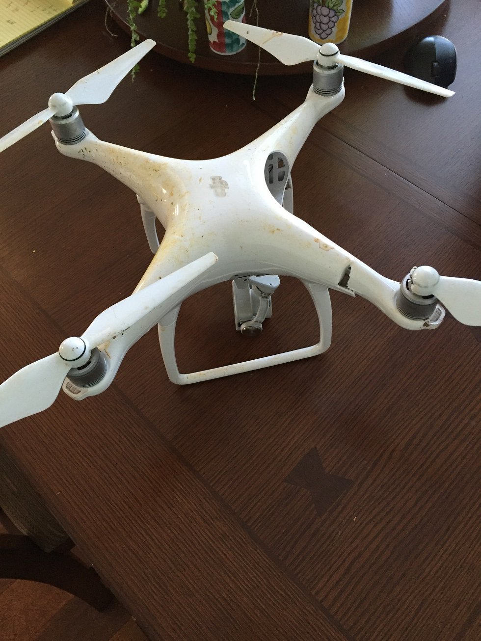

And here is the damage:
Broke prop and nasty gash on the rear left part of the body.
Busted Gimbal assembly

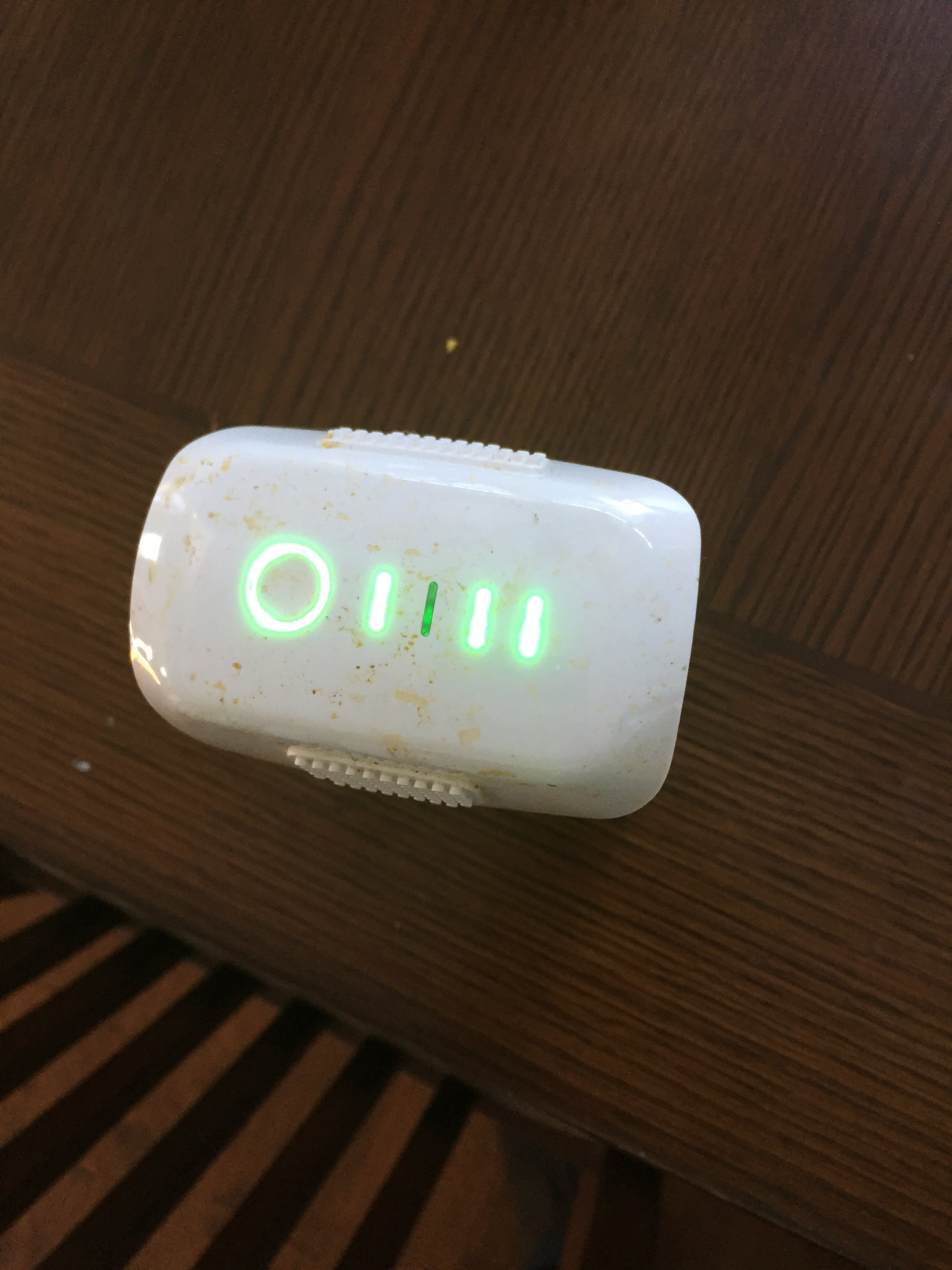

And the battery still worked but the third LED isn't lighting up.
I put the battery back in and turned it on. It went through it's full initialization sequence and actually gave me a Safe to Fly (GPS) on the DJI Go App. The only error it gave was that there was a hardware malfunction with the camera. I was hoping the flight log would update so I could see the logs after I lost my connection, but I had no such luck. So I'm hoping I get out of this one with a new body and gimbal assembly. I still have a set of spare props. It's boxed up and heading to DJI today.
