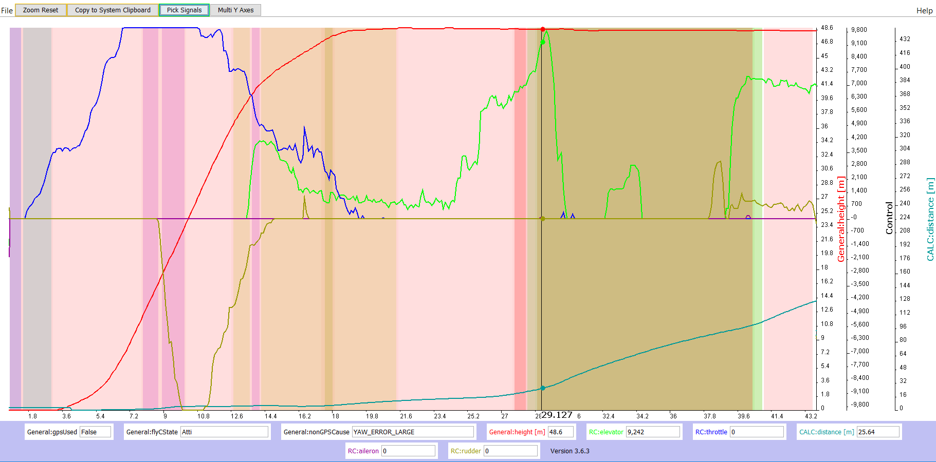

After the switch to ATTI at ~29 seconds,you continued to give forward elevator flying the aircraft farther away from you. You lost signal ~20 seconds later. There is no way to know what occurred after that without the aircraft data file itself.

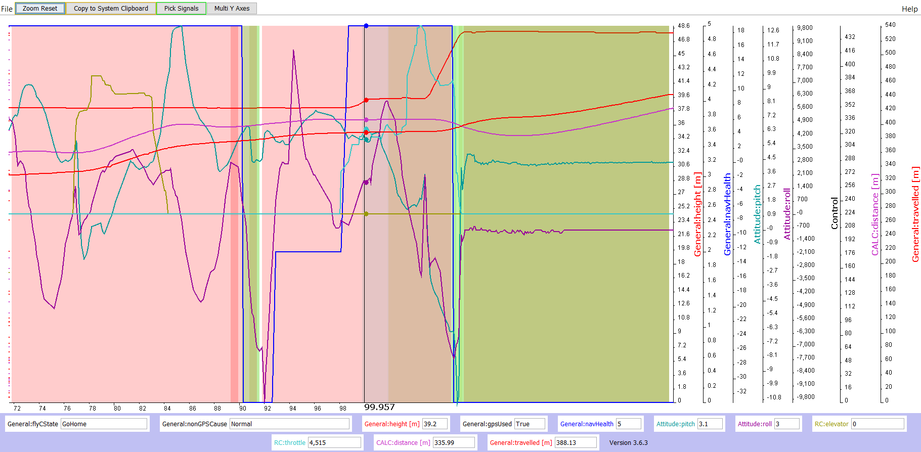

@~99 seconds you issued go home. It appeared to be responding, but the compass error came back and the aircraft re-switched to ATTI and began drifting until the end of the data.
After the switch to ATTI at ~29 seconds,you continued to give forward elevator flying the aircraft farther away from you. You lost signal ~20 seconds later. There is no way to know what occurred after that without the aircraft data file itself.View attachment 110772

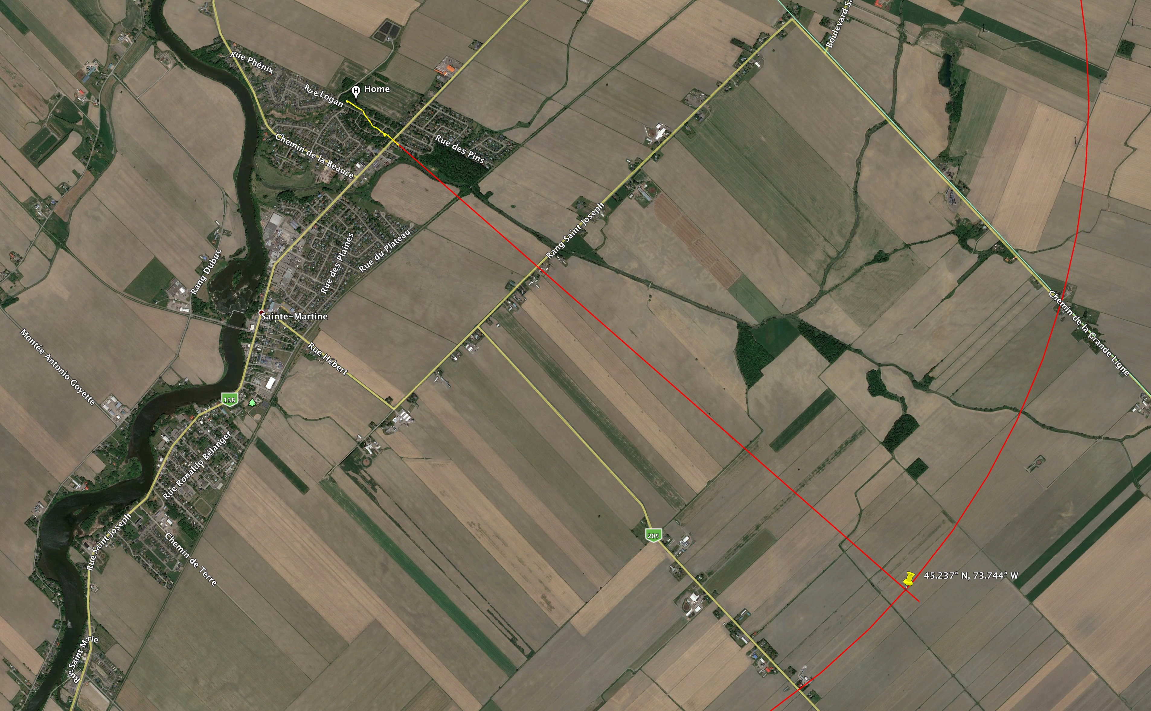

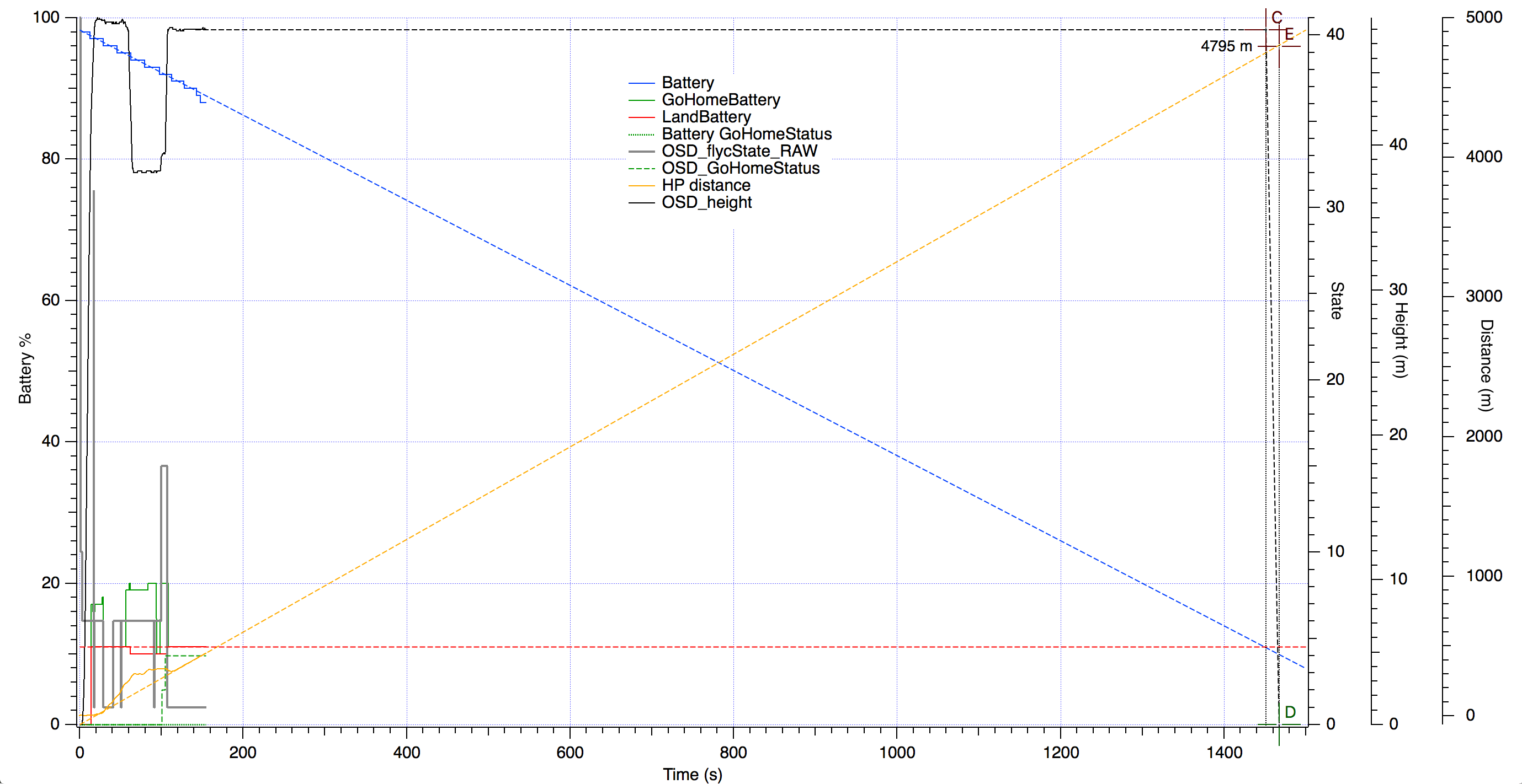

Actually we can do a lot better than that. The ATTI mode drift was pretty consistent at the end and so provided that it stayed in ATTI mode (that generally happens), we can extrapolate the battery level down to the SMART_BATTERY_landBattery level, and extrapolate distance and track to a predicted land point. The downside is that the connection was lost at 88% battery, and so there was a lot of battery left for the ATTI mode drift.
The result looks like this, with autoland starting at point C and finishing at point D. That gives a total distance from the launch point of around 4795 m on a bearing of 130°.
110775
110774
I'm reluctant to put much of an error estimate on that, but it could be several hundred meters in range and direction.

Your Phantom was warning you of problems early in the flight at 12.8 seconds with compass error messages.
At 27.8 secs, while the drone was still only 70 feet away, that changed to yaw error which is more serious and should have been a warning to end the flight.
Continuing after those warnings was not safe.
You would have to look at your launch point for the cause.
You've launched from somewhere that had magnetic distortion that caused the drone to get a false indication of where north is.
The usual cause is launching from somewhere very close to something steel and reinforced concrete is the most common but also things like wooden decks with bolts just under the launch position.
