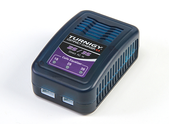

The following battery chargers allow 3 batteries to be hooked up. It does not decrease the charging time -- just frees you up from having to hook up the next battery once the first has finished charging.
The Smart Powercharge can charge 4 batteries simultaneously. These might be available on eBay as well.
Those are for the P2 (won't work with the FC40).
I'd just suggest getting another BC20-4 or two for $25 a pop (ebay).
