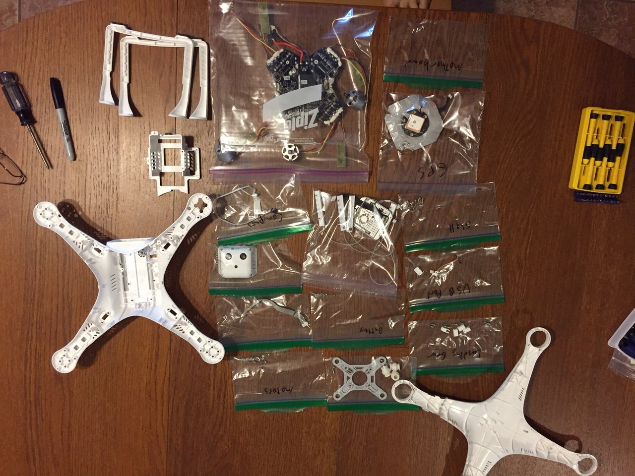

Here is my Phantom 3 stripped down. Ready for the new shell, motors and Bock gimbal repair kit to arrive.
The hardest part is taking off the top. I was very careful to label everything as there are many tiny screws that are easy to lose and forget where they go.
Just a thought, not a criticism... Not sure if I'd be putting the electronic parts in a ziplock bag. Electrostatic discharge can destroy those components.
Would a strong arm kit work as a repair kit in your scenario?? Just glue back the broken plastic of the motor (to keep the correct camber/cant) and use the strong arm as a brace.
And can you let us know if the new shell is a revised/redesigned shell or is it the same craplastic.
Thanks.
Good call on the ESD. I wouldn't risk it either. Usually it's more of a problem with IC's not actually soldered into boards yet but can still be a problem.

I thought about that. I wouldn't trust it for many reasons. Primarily because the motor wouldn't be properly positioned. The plastic tore free. The edges don't fit well.
I fly hard and far. Last thing I would want is the repair to fail with my bird 2 miles away on the summit of some inaccessible mountain. Air worthiness is critical for me and I'm not going to mess around.
I should have known better. I used to work in IT. Well too late now. I won't touch it until it is ready to be installed. Hopefully the electronics are rebust enough.
I used to work in Silicon Valley on IC's for years. Hated all the ESD shoes, clothes, smocks and wrist straps we had to wear. Better than a fab at Intel though...
