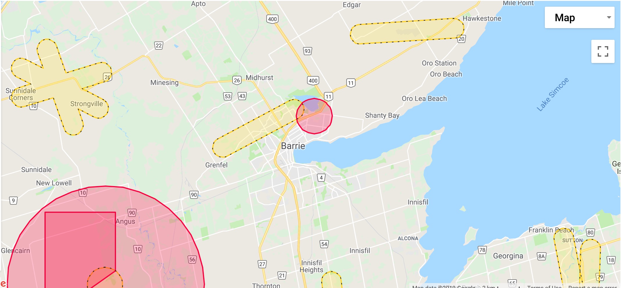

I took a look at Barrie using the National Research Council's drone site selection tool. It looks like you'd be legal to fly pretty well anywhere over the water except Orillia.
Heliports aren't 5.6 km radius, they're 1.9 km so the hospital's radius doesn't reach the water.
All the other airfields (except Borden) aren't certified so you have to 'exercise caution' but aren't banned. The zones around them are also showing as smaller ovals rather than 5.6 km circles, which I think show runway alignments and thus give you an idea of the axis planes will be landing/taking off. (Edenvale seems to have three runways, for example, while Springwater/Barrie Airpark has one.)
No idea how busy they are, which will of course affect how safe it is to fly near them, but it looks like the entire shoreline of Shanty Bay is OK for flights.

Thanks for your reply. I am aware of the 1.9km radius for the heliport. What I am confused by is that the National Research Council shows the whole waterfront as launch points …

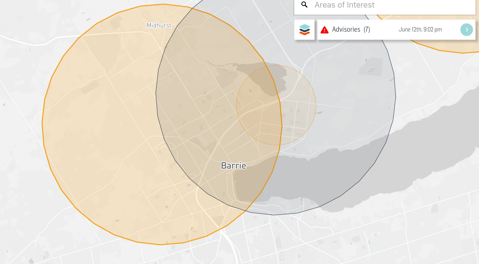

… whereas AirMap and AirData show that only portions of the waterfront have launch points outside the airport radius, so it is more limited. I have been using AirData and AirMap as my guide. Below is AirMap
The black circle is the seaplane radius. Shanty Bay is a small village and is too far from the Barrie City Waterfront to get any useable photo of the city lights reflecting on the water. Minet's point on the south side is a possible launch point but, it is a busy beach area and the parking lot is within metres of the shore so often people go there to sit and watch the sunset of have a coffee break.

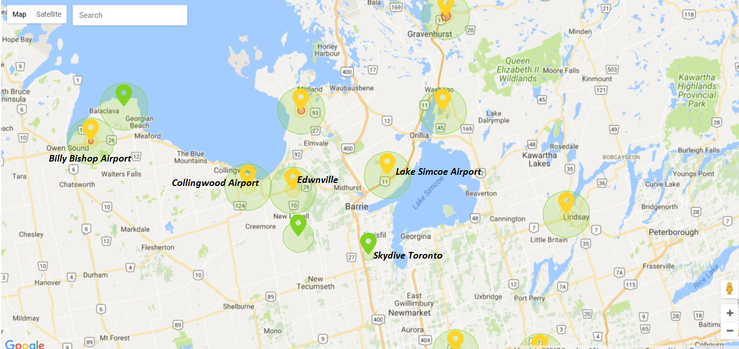

Nice picture Chris. Was that from the boat launch. From my Geospatial, downtown is a caution zone not a no fly zone like the Edenville, Lake Simcoe Airport authorization zones.

It can be confusing but believe not all airports have a 5.6 km restriction. Depends on whether a major airport like Lake Simcoe, Edenville or Pearson compared to smaller one, grass strips, or even Skydive Toronto. There are NFZ and warning zones. If your Phantom has the latest up date, try it and see if you get Geofenced. I have flown downtown Barrie and south shore with no Geofencing. I also was going to take a low (100 ft) picture of my friend house on the 3rd of Oro near the bay and it would not even let me
take off due to the Lake Simcoe airport. The yellow in this map are NFZ, the green Warning, caution zones.

I think what's happening is that AirMap is drawing a 5.6 km radius around every airport, whether or not it's certified, while the NRC is only drawing it around certified airports (which matches current regulations). As I understand it (and I'm not a lawyer) we are only prohibited from flying within 5.6 km of a certified airport. I have Canada Drone Pilot on my iPad for logging flights, and it does what AirMap does — draws a 5.6 km circle around every airport ‚ but distinguishes between prohibited (certified) airports and registered airports (where one can fly but with caution).
Does AirMap draw Borden in red?
(And I was assuming "Shanty Bay" was the name of the bay that Barrie is built on — I didn't know it referred to a small town. Sorry for misreading the map. I meant Kempenfelt Bay — assuming I read the map correctly this time!)

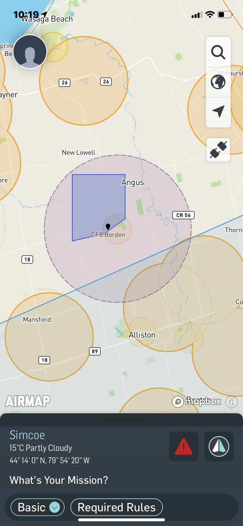

Here’s how AirMap shows Borden.

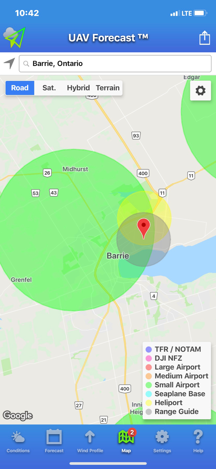

I also use UAV Forecast map feature to check places I fly.

Looks similar to Canada Drone Pilot's map. Assuming that's the case, red would be certified airports, orange registered ones. As I understand it, the 5.6 km prohibition applies only to certified airports; we can fly closer to registered ones if we exercise due caution.
