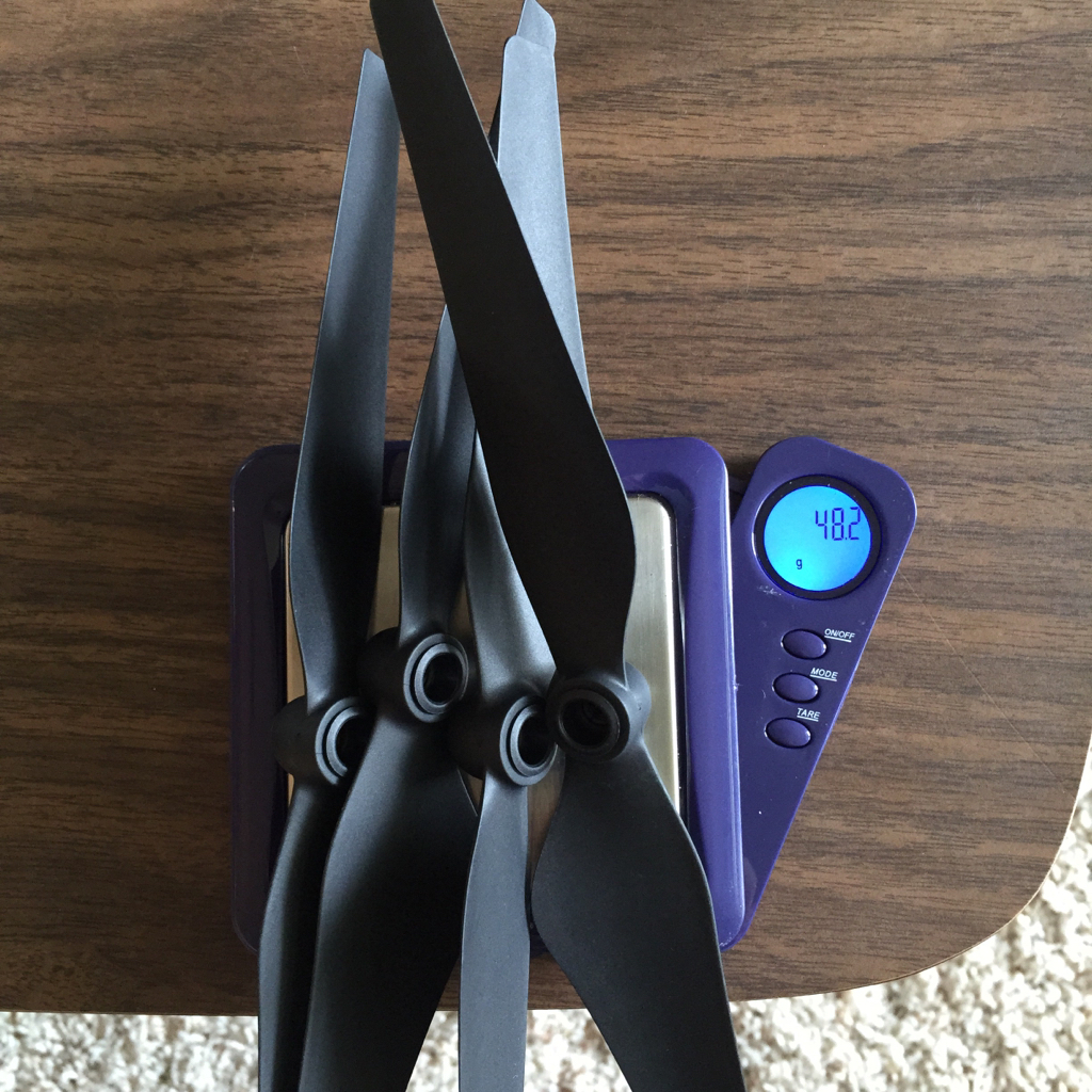

I absolutely understand. I will not be able to check the balance for you, but I can definitely get the weight and then update this thread. I suspect that DJI has updated this part from when they first released them, but that is simple speculation. Give me a day or two and I will get these weighed so you can see it.

Will have the video up today discussing the actual weights of these props. I will even measure the thickness and length, the see if they are the same overall dimensions of the factory white props. Stand by!

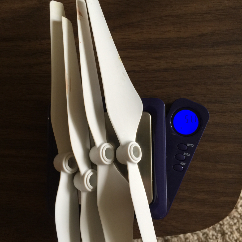

Ok guys, here is my video talking about the weight of these props. I determined that they are about 1 gram lighter per prop. This isn't a huge difference, but they are definitely lighter. They certainly felt a lot lighter than that when I first opened the package. Overall, these props are the same exact length, but they are a bit thinner. I couldn't get it on video clearly, but there is a difference in thickness. Stay tuned for more videos with the performance of these things.
