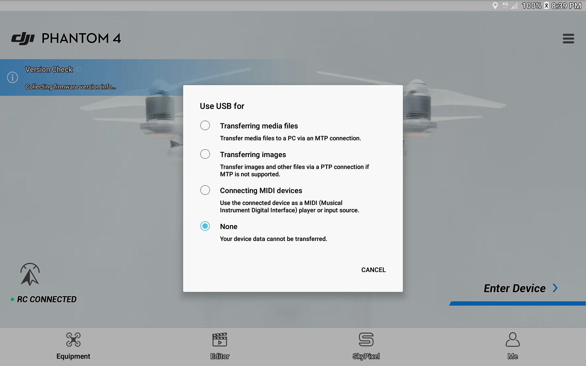

Yes, Am in developer mode. Although if I select RNDIS as the usb connection it often defaults back to MTP
Was just reading and I remember on my p4 just recent,,this tab A device and when I first had set up issue mine would not conect to app until late I had set it on T I,,this when MTP not avaliable, now after reading your post to get ideas I notice mine set on ""none"",,,as yours does mine also returns to this setting when trying to select,I remember I could change it before,,my developer option is off,,,does the camera get over hot when on for that short period,,,is this drone new,,,have you tryed a decent sd card in it,,can't not say it device cause I use Samsung aswell and have worked good ,this going to bug me all night now so I be thinking
