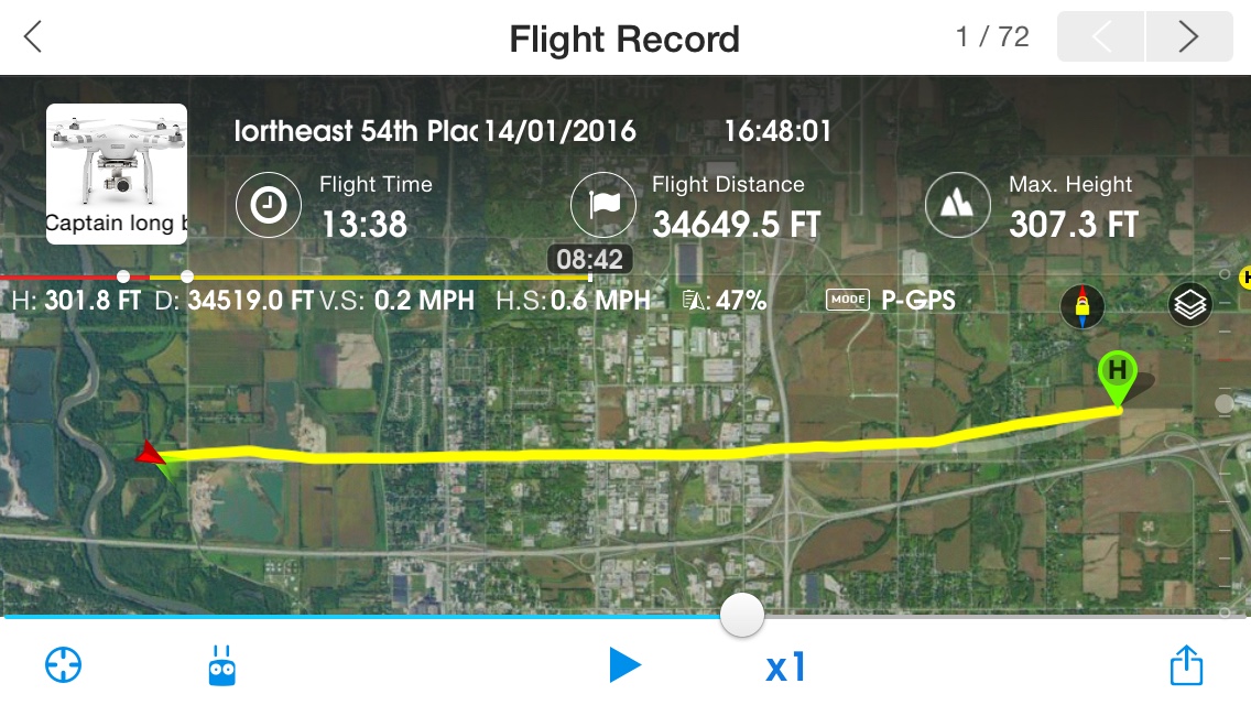

I believe the second one because it is 4.5 miles out and back. The first one - not so much. Even with an extreme battery mod, a live video feed wouldn't work 8 miles out thus the only way I could see this happening is a preprogrammed mission with a ridiculous battery mod (and no live feed through most the mission)
Is that enough proof for you? I'm the Flytrex distance leader I get 32 minutes flight time and I use an FPVLR V2
It's totally possible to go more than eight miles even 9 miles if you have the right set up so you can call BS all you want all the proof there pal
Please explain the "set up". After multiple battery mods it would be pretty much a custom quad I assume. And what type of antenna set up would you need for true live feed at that distance?
I am curious about the right set up too....I am getting less than 20 minutes flight time on fully charged batteries.
I'm using nothing more then a boosted FPVLR V2 3000MW sunhans x2 and a battery mod. Did you look at the screenshot that flight was over land and it was 8.5 miles away full signal at 400 feet I have flown 8 miles without the boosters and still had video feed. Light bridge is awesome bro it's not the same as the p2 the signal is so good it's like a given I worry about battery life not signal

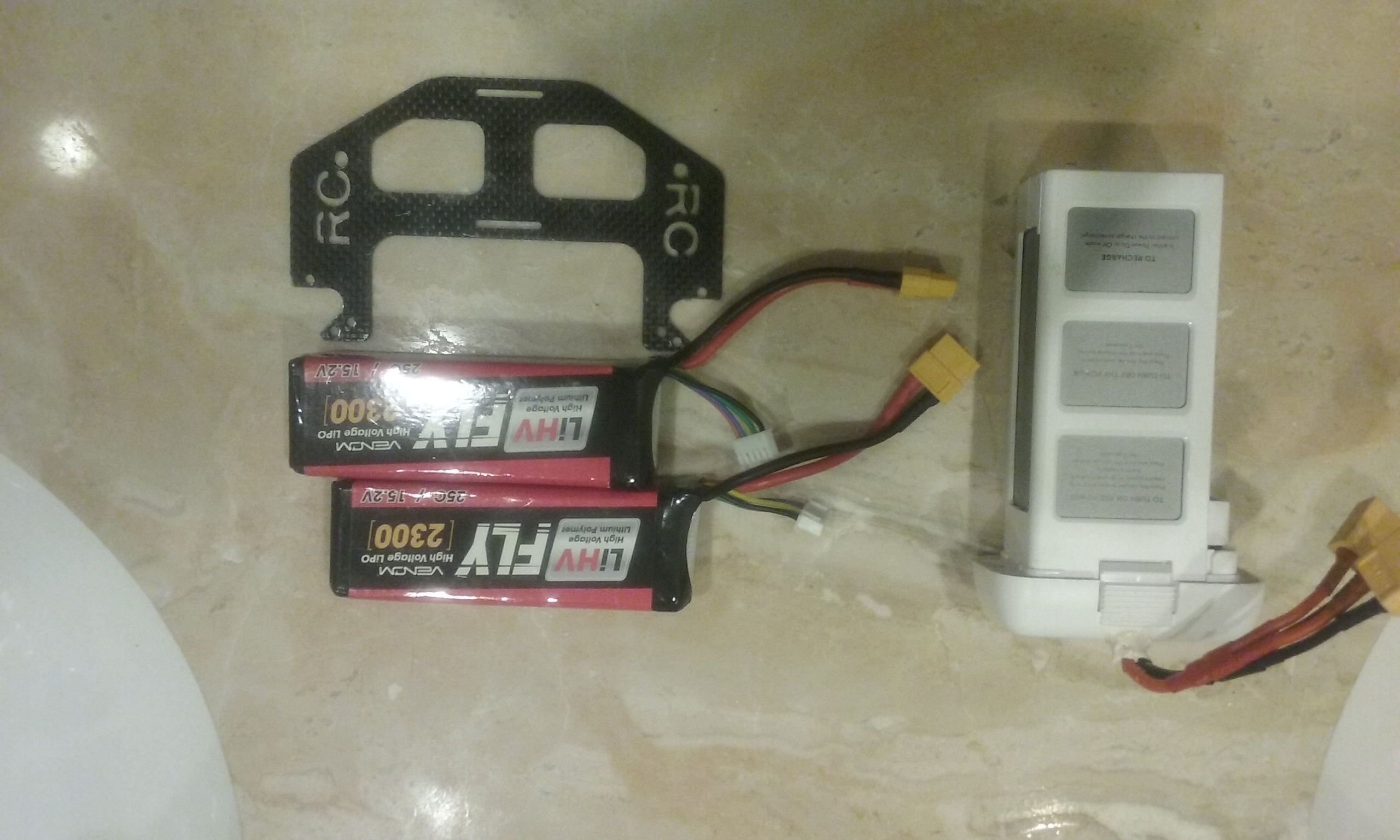

I'm sorry bro I didn't see you asked me a question you need a battery mod and a couple 4s LiPo packs to get more then 20 minutes flight time. FPVcustoms.com sell modded P3 batteries. For example this setup right here with these high voltage venom batteries this modified P 3 battery from FPV customs and battery tray will put you 29 min to 10%20160120_224319.jpg
I'm sorry bro I didn't see you asked me a question you need a battery mod and a couple 4s LiPo packs to get more then 20 minutes flight time. FPVcustoms.com sell modded P3 batteries. For example this setup right here with these high voltage venom batteries this modified P 3 battery from FPV customs and battery tray will put you 29 min to 10%View attachment 41320
Thanks very much, I did not know about these battery options...thankyou
Thanks again will order this battery mod.
