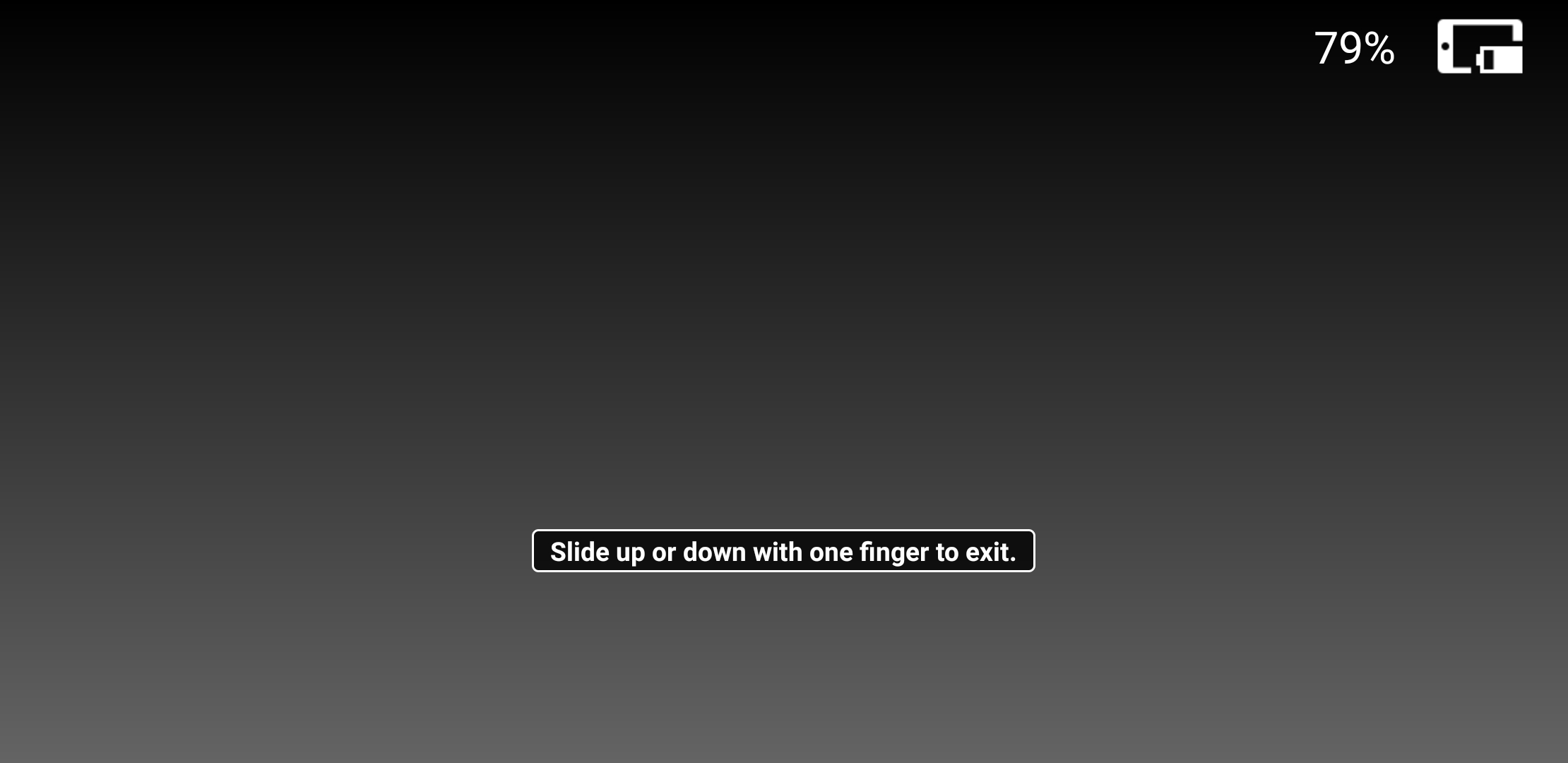

You can slide up or down with one finger on the screen to get a 'clean' screen (and back to normal screen again).
Is this what you mean?
(This screenshot was taken from the DJI GO 4 app without a remote connected !)
