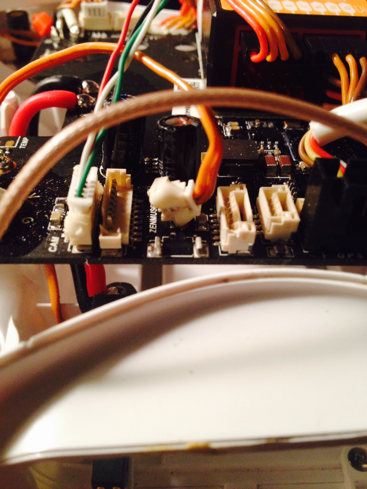

    Okey, I was too curious and popped Phantom open. What I found was really intresting :O
    [​IMG]
    How come there such damage is beyond me. Theres no wires to these two connectors at right.
    One on the middle is wire from smart battery, the smart part of it that is.
    What you think guys? Is this normal?

    That's certainly not normal, though it is easily fixable for someone with good soldering skills (it may be easier to cut off the connector and solder the wires directly to the board or the resistors). The 2 empty connectors are not normally used.

    I think I'll first talk with DJI.com how they can make it right. Its brand new and I kinda want them to fix this rather than do it myself. I most likely can fix it easily like CityZen suggested.
    Does anyone got good picture of P2V+ v3 without cover? Is those two broken connectors used for anything ?

    That is definitely not right. The connector socket has come away from the motherboard. Send it back if it's supposed to be a new unit.

    The two connectors are both for CAN bus. They provide two different plugs for the same connection. Usually the smaller one is used. Among other things, the CAN bus provides flight data that is used for a FPV OSD (on-screen display).

    If you are very unlucky it can cause short-circuit and mayby shutdown whole craft.
    When my phantom was hovering above tree I was looking my phone to make some adjustment to stillphotos and all the sudden I got "Invalid Battery". My first reaction was to look at phantom up on the sky, only to see it comin down. My second reaction was to thorttle up but that didnt do anything. Intresting also was that craft was powered down when I got to it. I dont know is this normal it auto-power off itself if it crashes ? Makes sense so proppellers does not do more damage.

    DEFECT, connector mechanically failed!
    Wow, those images of the connectors broken loose are blowing my mind. I'd have a hard time believing they failed due to any crash. DJI must cover this type of warranty claim. Incredible!
