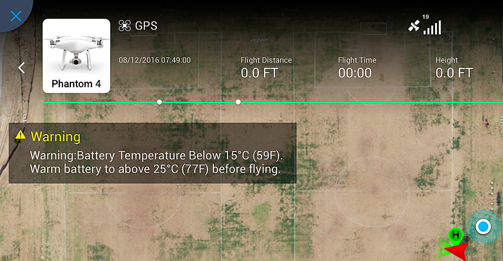

I started the P4 up today for a flight and saw this:
I would think 59 degrees would be okay to fly with, but warming it to 77 degrees? Seems they want a warm battery, warmer than my house and car?
This was with GO 3.1.1 and iOS 10.1.1. Battery was recently updated too with the P4 firmware.

Yep. But it's not "they." It's your battery. It wants to be warmer than your house and car. And you don't want your battery to be unhappy.

Yes, I've seen it too. The warning pops up when the battery is 15C and recommends warming it up to 25C before flying.
But the warning doesn't appear if the battery is between 16C and 25C (I've noted this). I think if it were critically important to fly with a battery temperature of 25C or greater, then the warning would pop up whenever the battery was below 25C.
