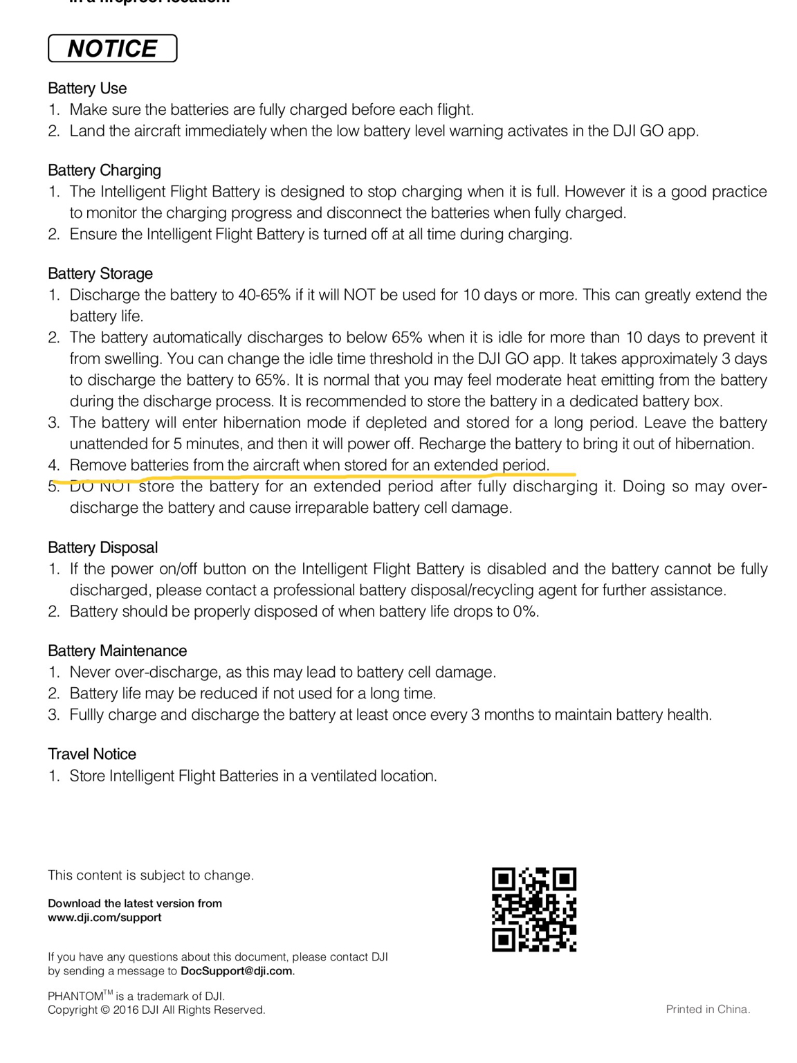

Good post but consider DJI's perspective... Warranty costs. I.e. liability for any claim alleged from such storage.
This is entirely different from the mechanics of the components.
Having said that, I do not store a battery in the craft as there is no reason for me to.
Whenever possible I separate the item from the power source during long term storage such as cordless tools to prevent accidental or inadvertent operation.
This includes items containing ordinary dry cells due to the common occurrence of 'leaking'.
Luckily OP is only thinking of doing it a couple of days and not 6 months.
