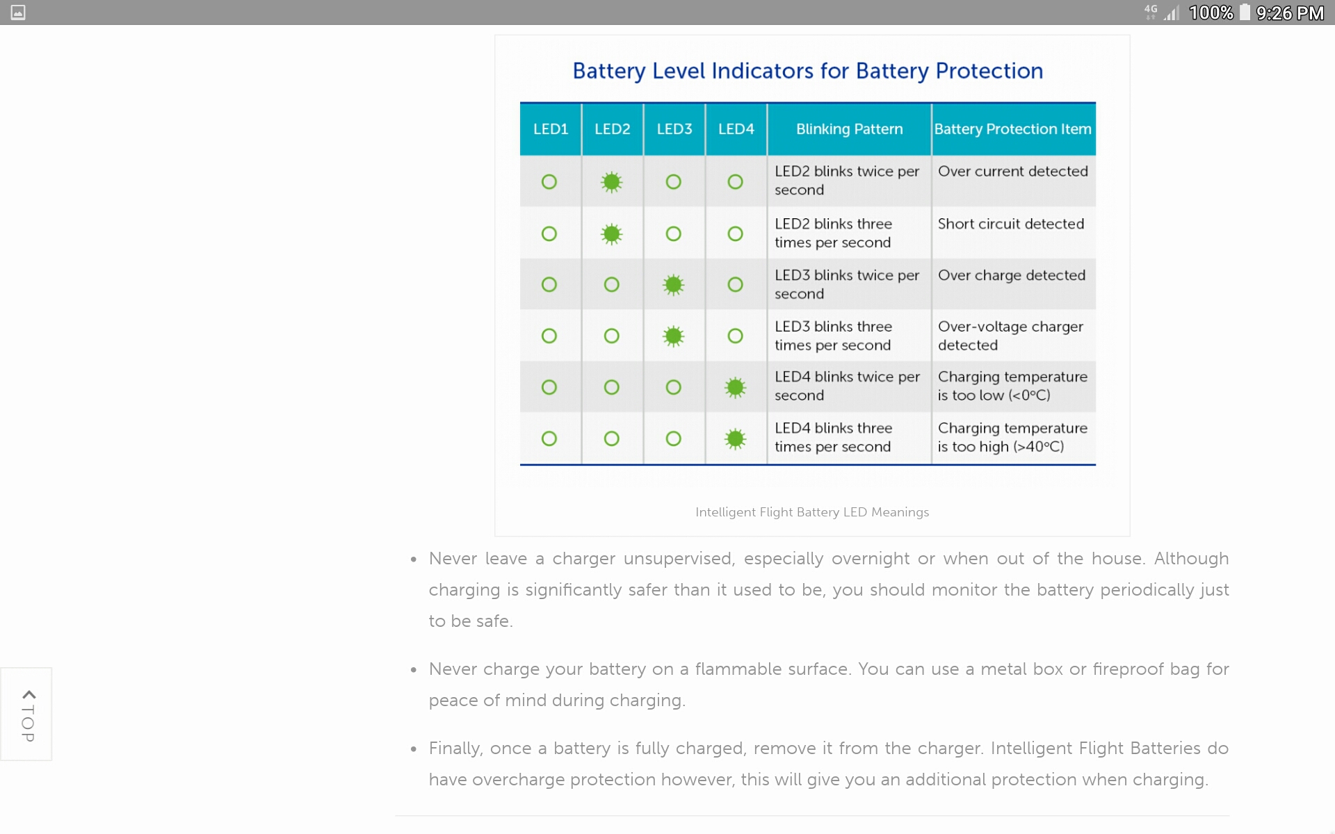

Here's a batt condition light chart,,,the tricky thing is there seems to be odd light patterns about the world so dji needs to update this area

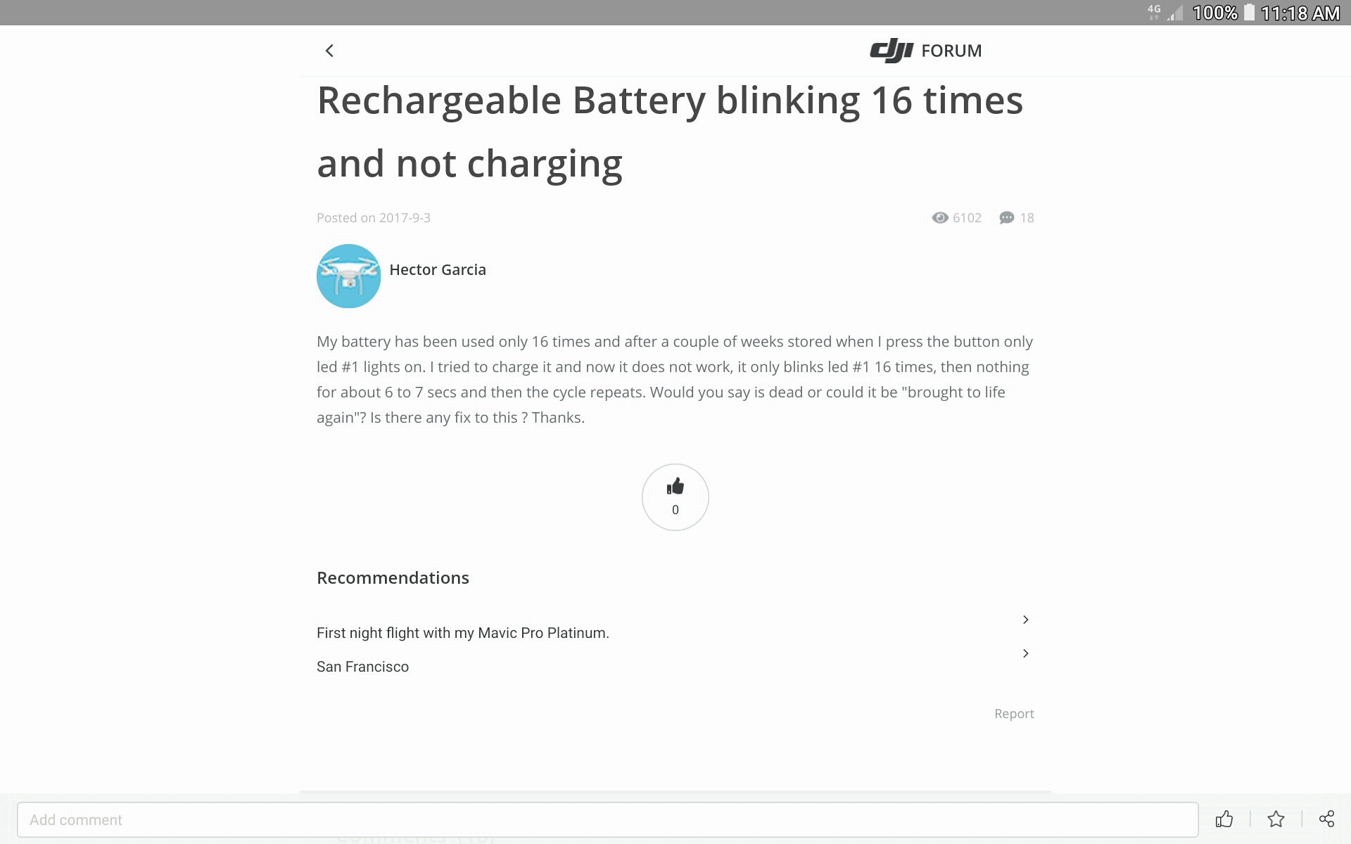

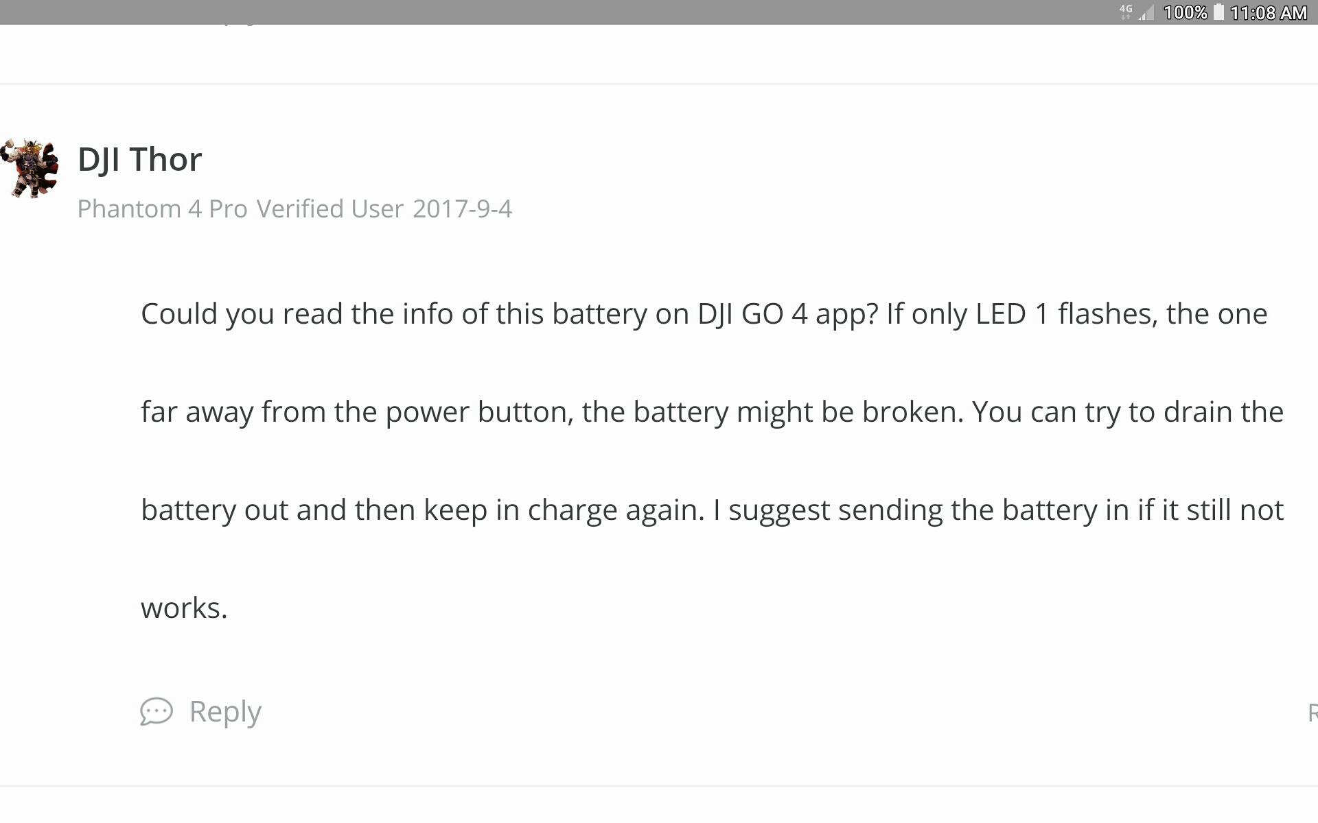

OK found this post from 2017 a reply from dji to someone who batt flashed 16 times,,,as metion hard to search even this because no light patterns been updated and seen to be different to most of us,,when battery spits out new one it's like omg,since you are unable to power drone up due to batt there no way to check ,,might have to bite the bullet on couple good Batts, 1 never enough ,,not even a batt reset will fix this unless you open batt up,only a tempt if good with tools a search before doing so,,lipo batt not like to short out,that will kill it,,anyway if I find a definite cure I let you know unless someone reply with another fix,second hand always tricky unless seller is flying it in front of you so you know it goes,I be watching and reading,,sorry for my bad info post but could not find good news

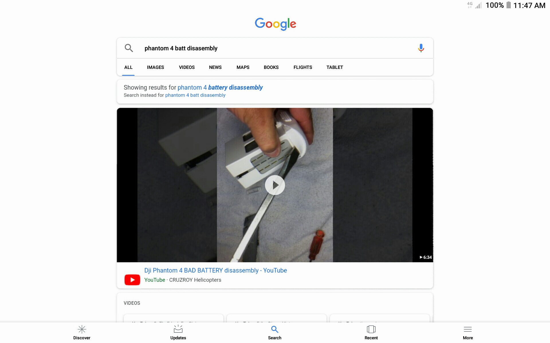

Ah ok you can take front off and take a wire off while the mains are still soilded to circut board but do a search on Google for good info cause is bit dangerous,,best of luck and take care
No idea how to find that info
I just had quick look ,,you has this one that comes up on Google search engine,,,this just screenshot not a link for it,!,,I like the screwdriver he got in hand
