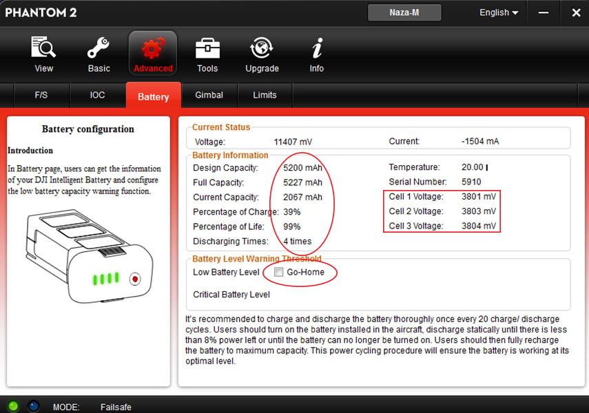

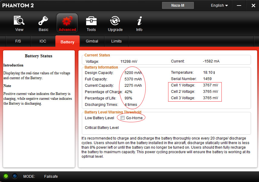

    I am having a problem that I think is battery related. The battery is recognized by the software and powers up my P2 but moments after I take off the LED lights on the P2 go red and it auto lands even with as much as 70 - 80 pct charge left. I cycled the battery by discharging down to 7% and recharging back to 100%. No change. I have the latest firmware updates. I only have one battery because I don't fly very often. I am reluctant to buy a new battery as a means to troubleshoot since they are so expensive. My P2 is configured with the Zenmuse H3-3D gimbal, Mini OSD, and AVI 5.8 xmtr. Here are the screen shots from the PT2 software.
    Any advice would be greatly appreciated.
  6. jason
    Oct 12, 2014
    4,856
    494
    Commerce Twp,MI
    From what I see this is a fairly new battery but from the battery screenshot it doesn't appear that you haven't discharged the battery for storage when not flying for a while. Would I be correct in that assumption? This your screenshot.
    Your Screenshot.jpg Those current capacities are not great and more then likely the cause of auto landing early. I am not a big fan of the low battery level either as that function is the same failsafe and you could be under something when triggered.

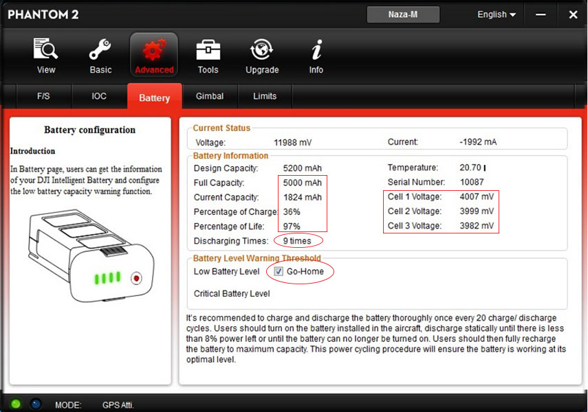

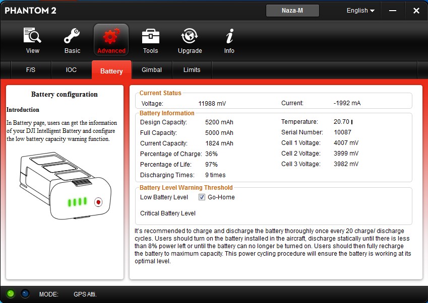

    Here are two of my battery screenshots notice the difference between yours and mine.

    Thanks for the reply. When you mention that the current capacities are not great are you referring to the design capacity vs the full capacity? I notice that your full capacities are both higher than the design capacity.
    You are correct that I left the battery fully charged for quite a while (about 9 months). It was not until I started having this issue that I learned that was a no-no. Do you think the battery has been reduced to a paper weight?

    I was referring to the full capacity to the current capacity for the number times it was cycled and the reason for the early landing.
    Yes it's time to replace the battery and as you have learnt if you do not intend use the quad for awhile discharge it to 50% for storage. Here is an item you can use to safely discharge P2 batteries for storage.
