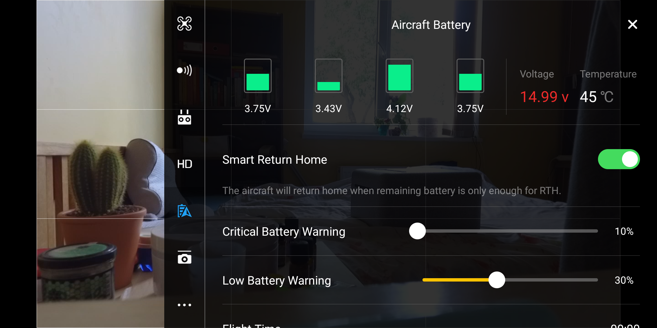

So second discharge and I put to charger... after like 30mins it stopped charging. popped battery in drone and saw this view...
Battery balancer not working? :(

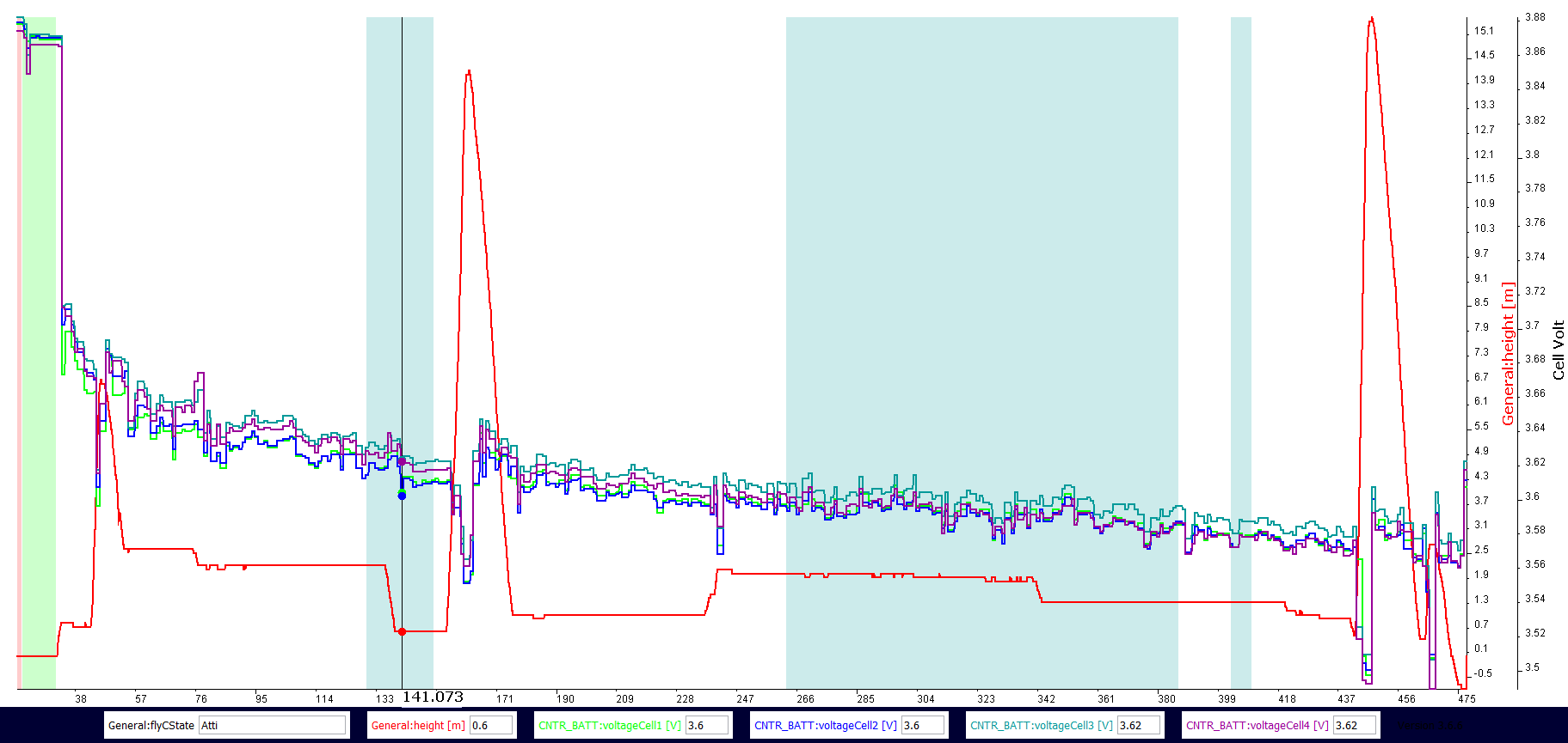

This was first flight when I saw battery damaged DJI Flight Log Viewer - PhantomHelp.com
I was trying OA near walls, to look how they work in action.

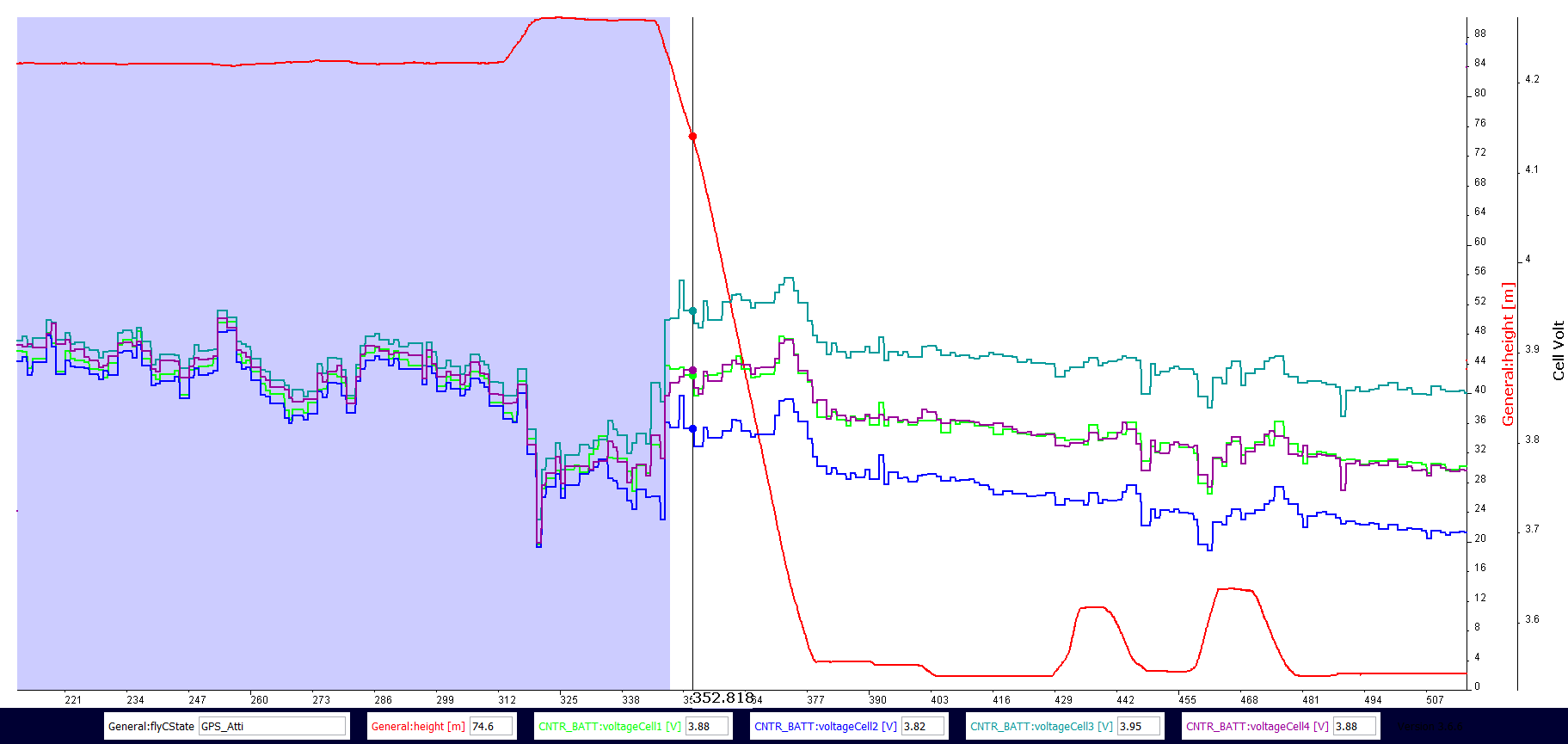

then hover test: first fly until I landed DJI Flight Log Viewer - PhantomHelp.com

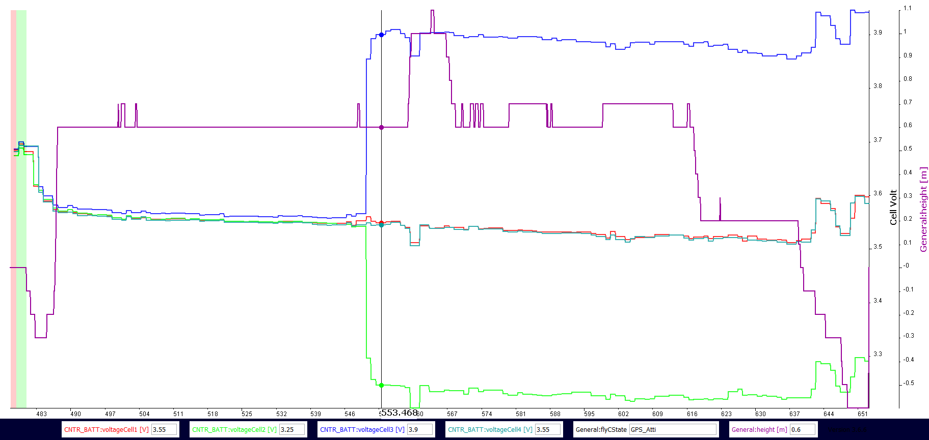

and second fly after I landed DJI Flight Log Viewer - PhantomHelp.com
in second take up you can see that cells again started go crazy.

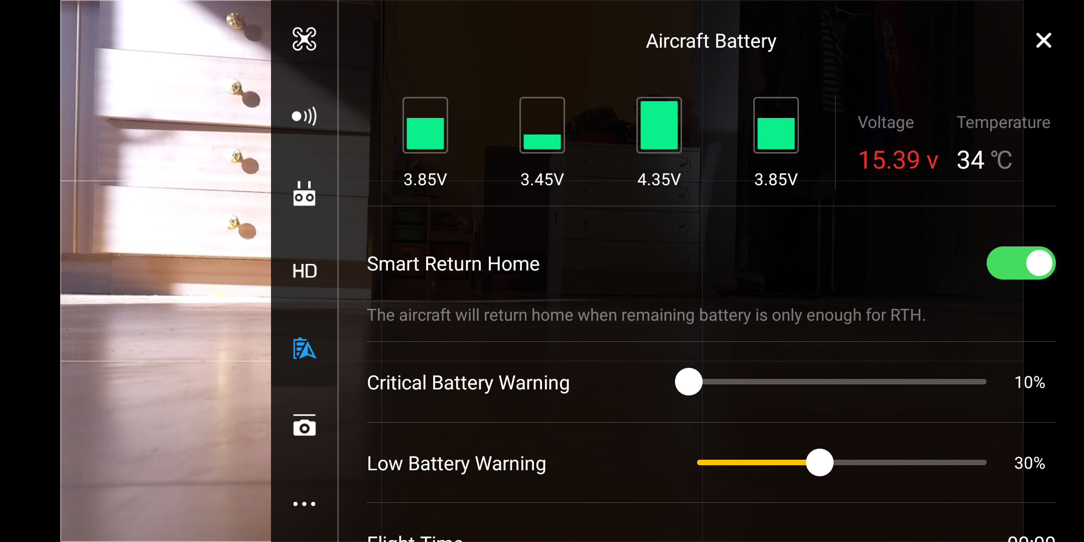

Now Im trying to charge them again... but strange thing, I always watching them how much power from the 'wall' they taking in Watts. When they start it goes like 100-120W I believe and then near end they go like ~20W. No 4 bars lighting up , like near the end and it still drawing ~90W... maybe it charging that last cell... who knows... Im each minute check battery temperature with hand, not hot, little lukewarm... jesus it headache :D

Below is the plot from the original flight where you noticed the Battery damaged message. Cell 2 and 3 became unbalanced midway through the flight
Below is from your first hover test. There is not a great deal of cell deviation in this one.
Below is the last hover flight. Again Cell #2 and #3 became unbalanced mid flight. This one much more pronounced.
First suggestion would be to first try another charger. Preferably OEM. If this appears again you will know the cells are not holding a proper charge and balancing correctly which means get rid of that battery.

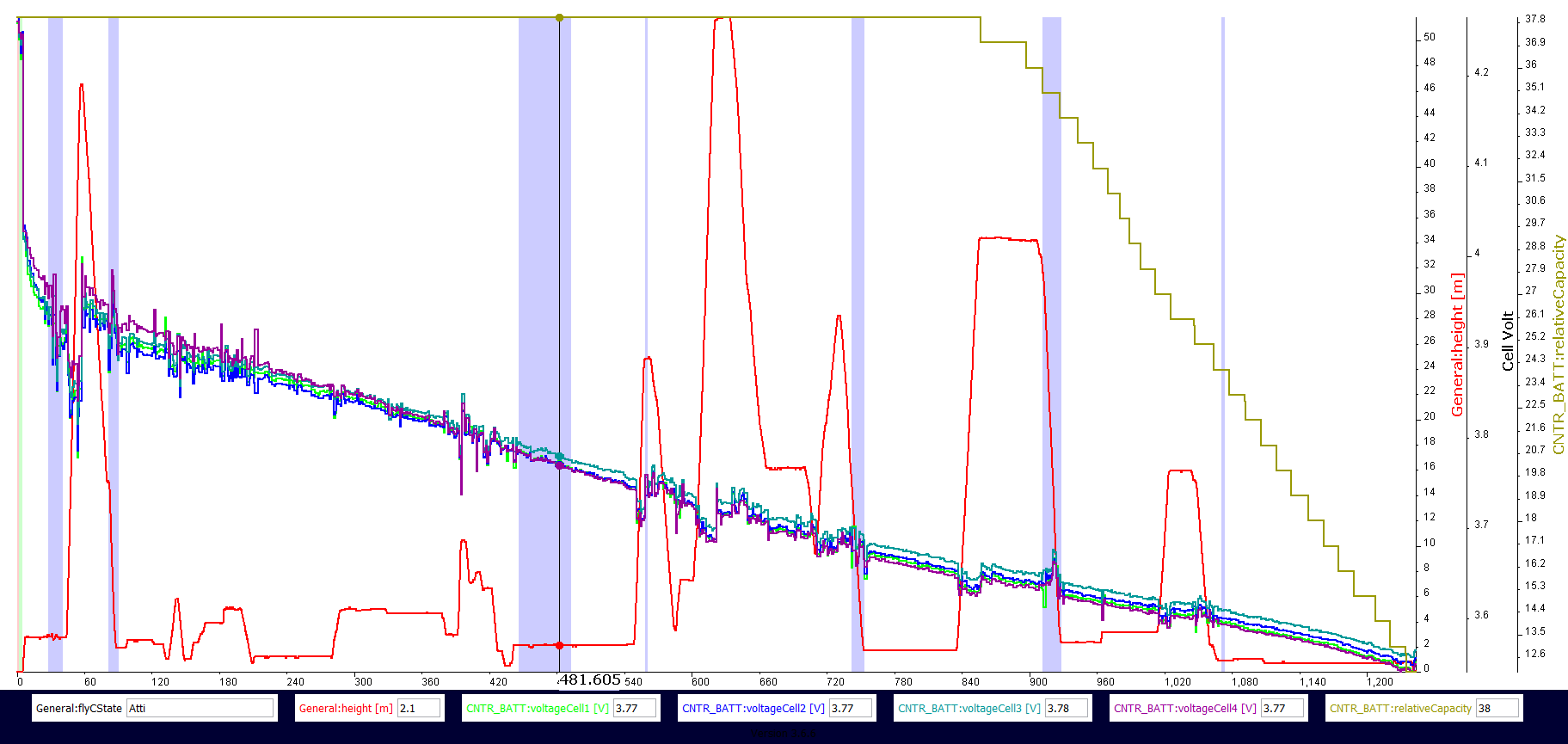

Thanks FlyDawg for graph. So charger this time charged fully(looks to me) and did again some hover(up an down) test.
hover 1: DJI Flight Log Viewer - PhantomHelp.com
hover 2: DJI Flight Log Viewer - PhantomHelp.com
this time cells voltage looks more acceptable I think. but percentage is way off... after hover 2 I left it again completely discharge until drone turned off and left to charge. Maybe it will fix the percentage issue. I will do tommorow more hover flights...
In Hover 1, ( Below ) your percentage started at 38% and stayed there until well in to the flight. That is one I haven't seen before. To me that indicates a problem with the battery. Not necessarily the cells themselves but the internal control circuits which provide the information to the FC, prior to telemetry transmission. For informational purposes, you should not discharge these batteries below 8%.
