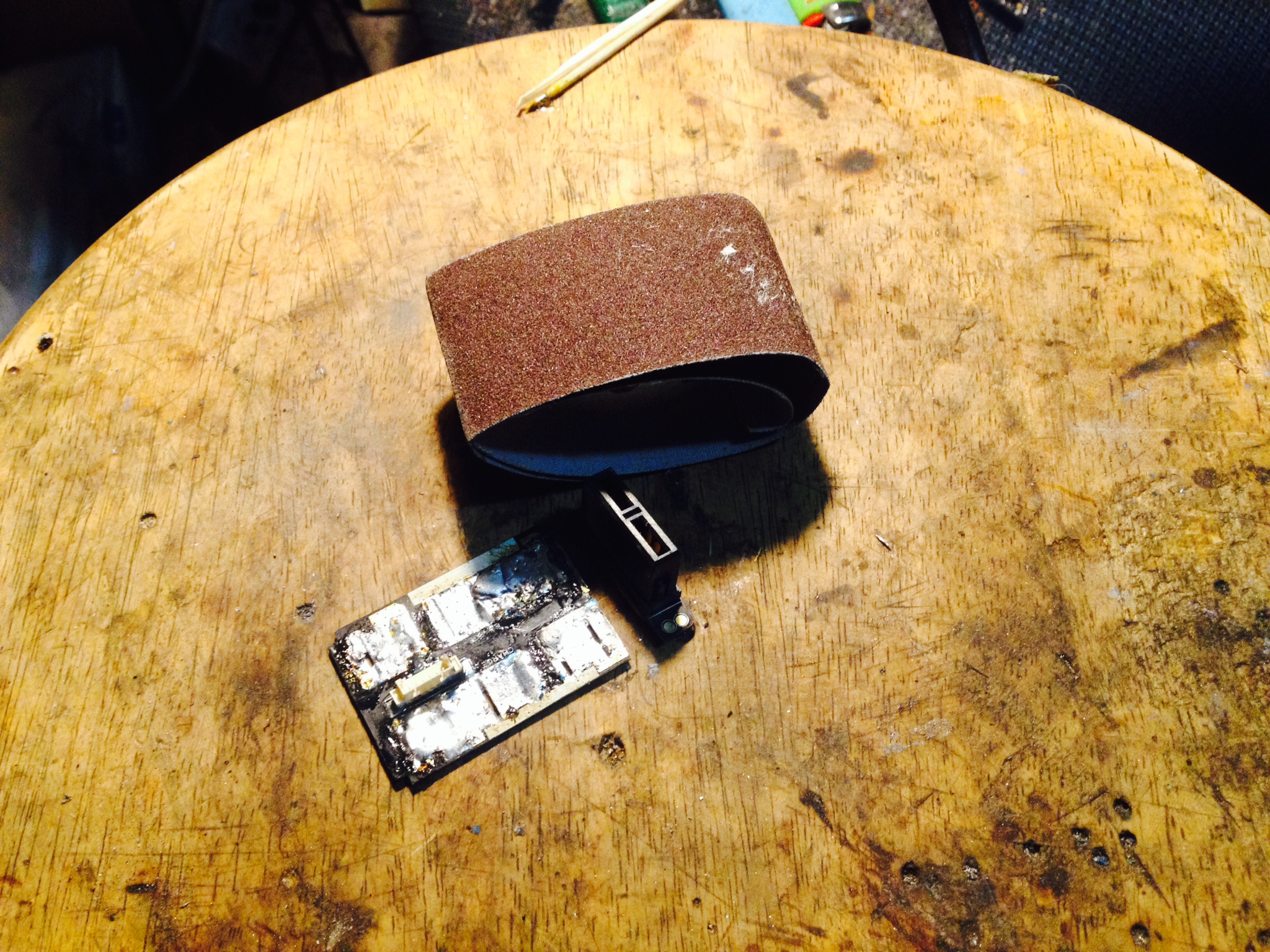

just gotta solder them balancing wires
That is an old P2 battery and will not work. What you need is one of the new batteries that have the square copper info pads. I have done that mod but never used it because the price of aftermarket batteries was so cheap. Just because that battery link had shipping charges doesn't mean all of the others charge s/h. Just go into eBay and type this in phantom 2 vision plus 5200mAh 11.1v batteries.
