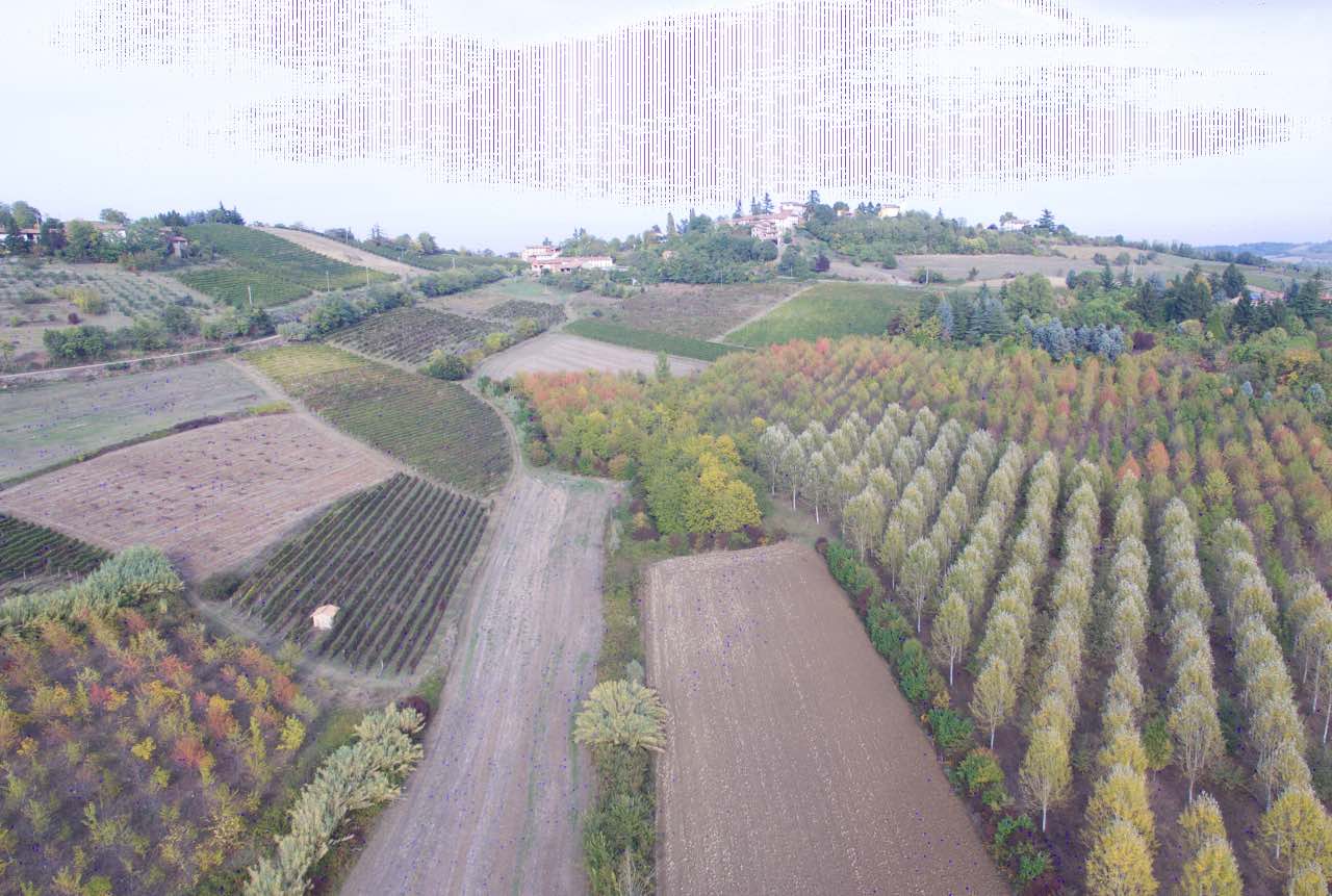

Hello guys ... I have a little problem! The camera of today has given me P3P this problem: pictures in RAW setting, vertical stripes on the sky and annoying blue dots in the picture .... app, RC, and P3P all updated with the latest firmware ... by chance happened to someone?....but I don't the same problem with movie option !

What is the source of the .jpg you uploaded (i.e. How did you get from the RAW to the jpg)? The image seems generally overexposed- it it possible what we are seeing is the viewing/editing program is simply depicting areas in the image that are grossly overexposed? That would make sense if you have provided a screenshot.
Hello everyone .... no, no accidents or dangerous landing. The image making and a screenshot of the PC screen, but the original raw and jpg and this that flaw ... and I just realized yesterday after using it ... reading the web s suggestion seems to make a calibration IMU and Gimbal ..... hope
...lightroom 6
Ok. Look at your histogram top right of screen, make sure your highlight overexposure warning box (it's in the top right of histogram box is unchecked). The artifacts in your image look suspiciously like overexposure indicating (as I suspected earlier). Let us know if this is the issue. I doubt it is the camera.
Hi...thanks for the answer but unfortunately the problem stay !...I try change microSD...format microSD...but without results; I seen that other pilot Phantom 3 in the forum had the same problem :(....start thinking that is a sensor problem but I dont want lose hope :)
See what the image looks like if you actually export it from Lightroom and open in another viewer.
