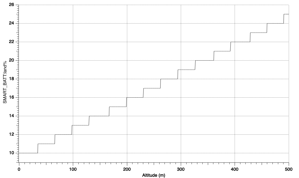

I think I can clear up all those uncertainties. SMART_BATT:land% always starts at 10% at zero altitude - the FC's target is to be on the ground at 10%. It's independent of your critically low battery setting - I've tested with that set higher and it makes no difference, as expected. As the aircraft climbs the value goes up, also as expected. The graph below shows the SMART_BATT:land% as a function of altitude for a Mavic (I don't have the exact data for a Phantom).
Thank you- explains why my phantoms consistently tried to land at 10%, that was my setting and I was at or below 30m altitude (had allowed the phantom to drop to 10m or less hoping damage might be minimised if the battery switched off before I made it home.
