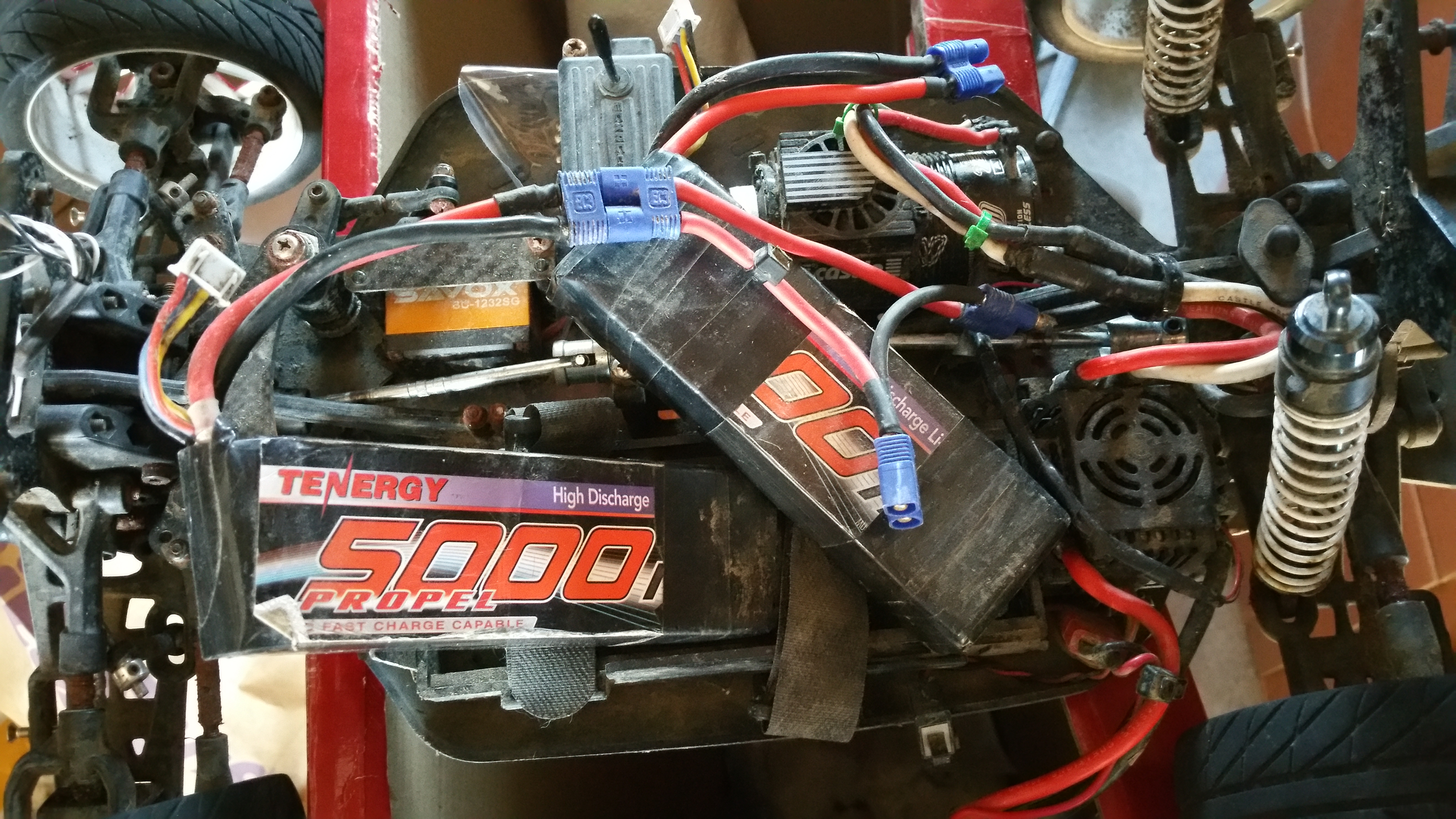

I have 6s Lipos for a RC car that have been thrown from the car at high speeds crashing, wrapped in electrical tape and nearly 3 years old that still work like a champ and charge 100%
These are beat to hell, the y connecter is actually fused together from high heat. Car does 107mph. I love Lipos.

These are beat to hell, the y connecter is actually fused together from high heat. Car does 107mph. I love Lipos. View attachment 23003
Julius,
107mp/h That's awesome. Heck, I would love to see it streak by...
It's refreshing to see others driving and flying the crap out of their models. And knowing the batteries can take a bit of rough and tumble, and continue to tick, like a 'Bulova' watch. No Timex here!!
