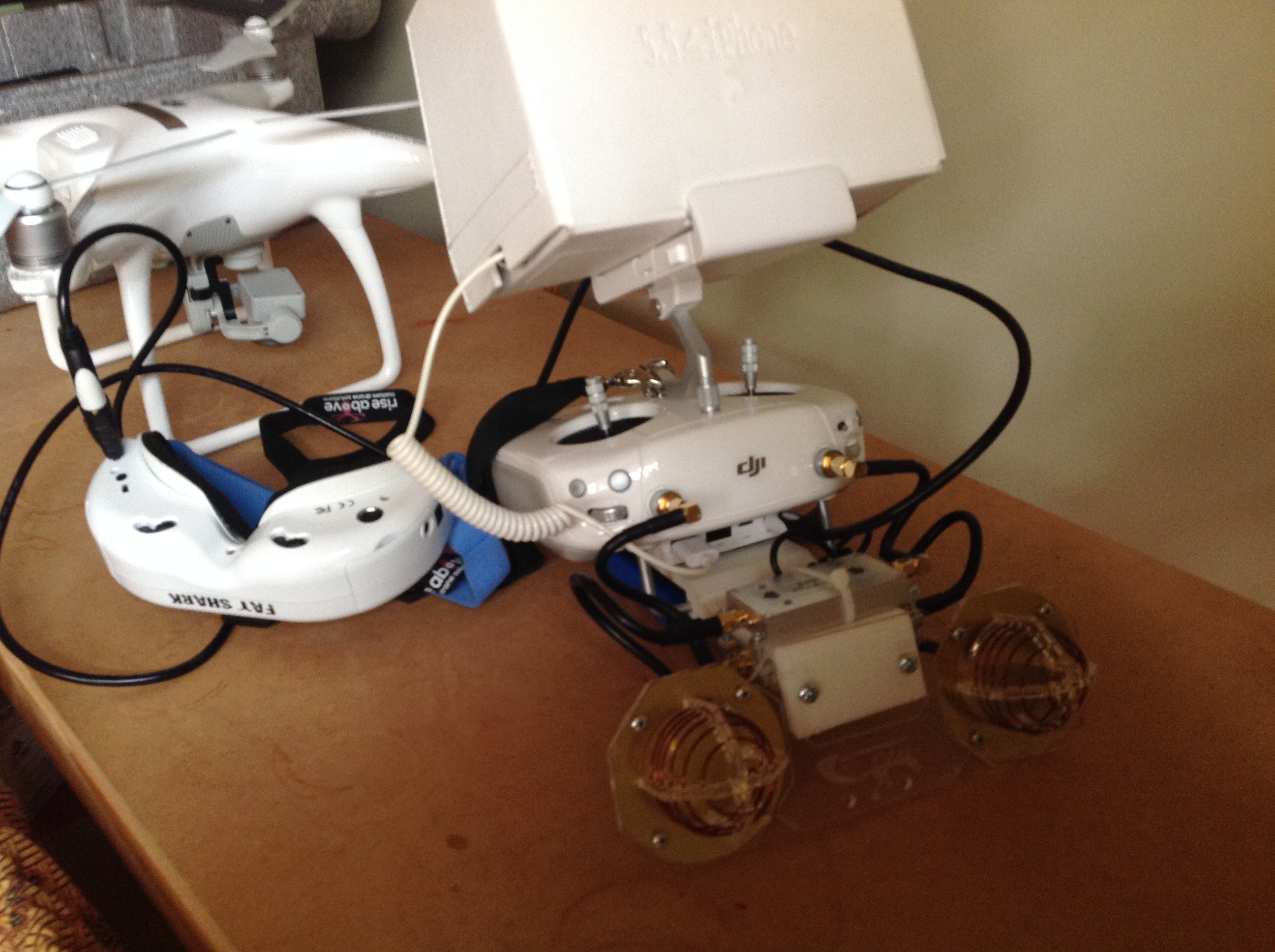

Is that a range extended antenna ? Looks interesting.

HI Yip I better start saving...picture made me drool:oops:...
Well I would have got a DBS mod but couldn't find anyone locally that supported it. Happy just the same and given the amount of flying you do, you will be impressed with a quality mod. Hate to think what antenna mods would cost in New Zealand judging by some of the costs you have posted in the past. Australian prices are absurd but yours are unbelievable.
Yip top $$$$$$ here,,sad,,,sorry for late reply dropped me tablet and it went offline till now,,,yes very nice set up,,,be easy for me just to buy complete,,,might get costly buying bits to set up:):)but saving has begun,,,,,
I thought I was the only one that dropped expensive stuff....the combined antenna/booster set up over here is about $450AUD, I got a bloke to do the RC install as I didn't want to stuff it up, the battery mod takes ten minutes and one beer to finish and test.
HI OK that not to bad I was thinking $1000 mark somewhere,,,going to look into it,,,..Yeh was my new 10/1 Samsung tablet,,$600,,,chip the corner,,,:eek: iPad I wanted bit out there on price,,,good to look at good size screen,,:)
