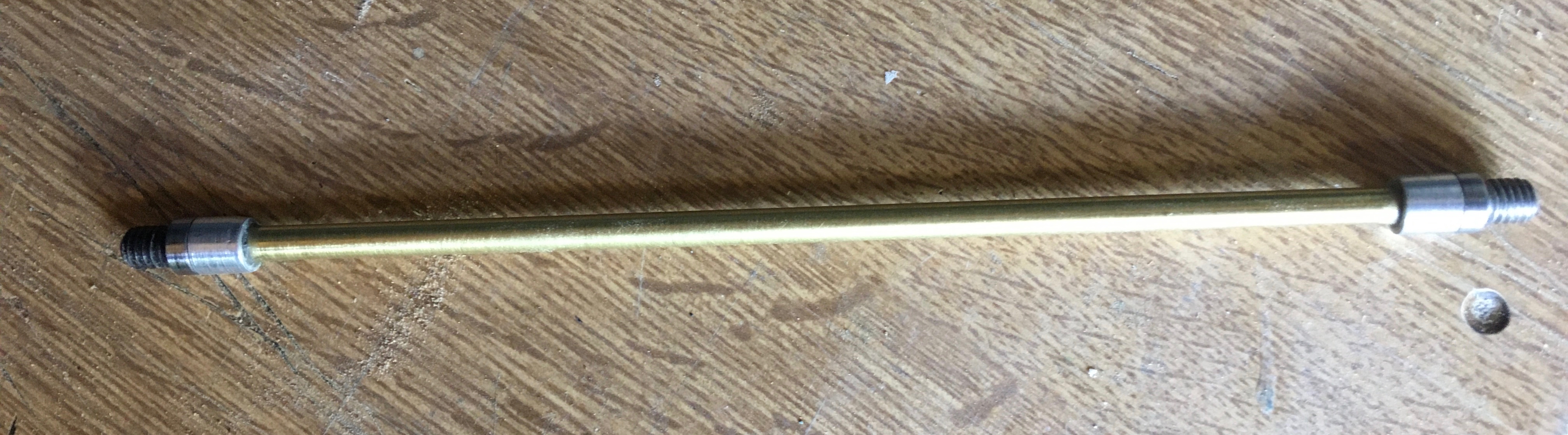

I also have the Du-Bro balancer so made my own shaft for my P3A props - the same method applies to any drone......
Get a couple of old, broken L/H & R/H motors, disassemble and remove (cut/machine off the shafts. These fit nicely into brass tube!
It is always a good idea to check the propellers now and then as they are the major source of vibration in the drone.
Also a periodic crack check, especially at the roots isn't a bad idea either.
