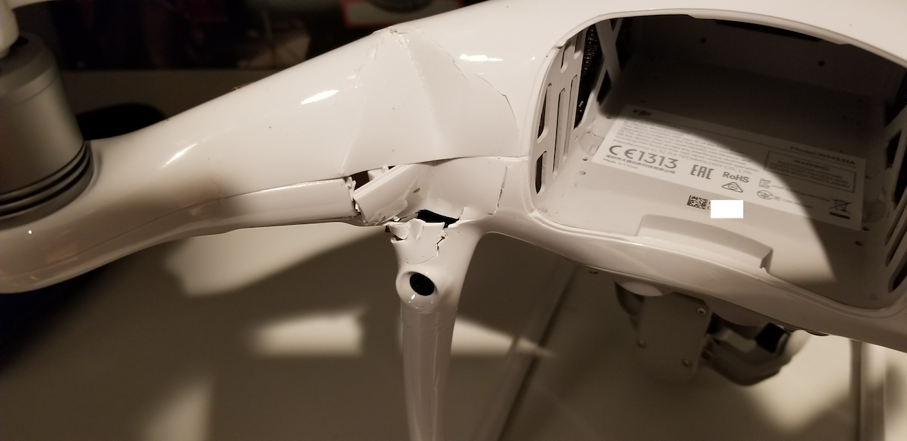

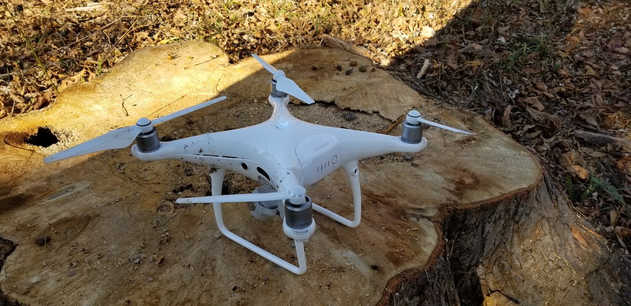

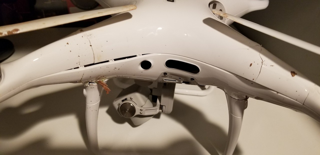

I was flying for about 20 minutes, I was starting to bring it back in and decided to try and get a shot over the water so I started to lower the P4P down, I was at about 130 feet and then all of a sudden I got a warning on the screen that I had lost the connection and about 3 seconds later it came back but within few seconds it dropped again. I hit the return to home button but it never registered.
Once I lost the connection it started to drift and went right into the trees and straight down. I dont know if it dropped any more, but id I was at 130ft, I needed 135 to clear that last one. It found the tallest tree there.
