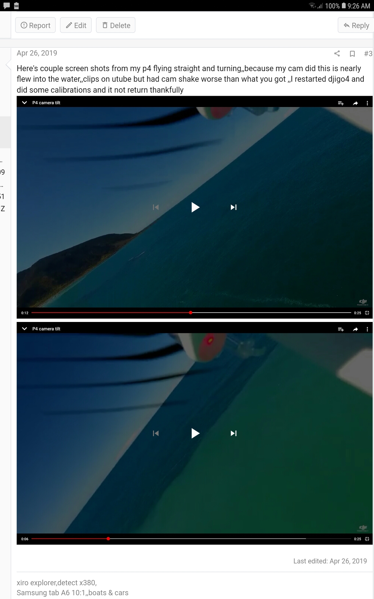

I think you have just experienced the p4 cam tilt which gives impression of nearly inverted flight,,
For some reason the cam does this and many have had it happen including myself,these cam tilts can happen in some wind,no wind while turning and some just do it,
Certainly can make things scary,I will find my picture and add,,,,,these 2 below are screenshot from video ,,,myself unsure exactly why this happens,but pretty common, sometimes I think the gimble motor just let's go for a bit !, I presume this can also happen with the p3 cause a few come up under search logo above,,you got a nice area to fly there

As mentioned above, that looks like a gimbal glitch, possibly due to wind from a particular angle.
If you post your flight data, it's likely to confirm that the drone was perfectly stable the whole time.
Temporary gimbal failure is triggered by lateral pressure. It only occurs for me when I'm flying sideways into the wind - never facing the wind.
In your video you can gauge the wind direction from the movement of the waves on the surface of the dam - visible from about 18 sec. The incident occurred as soon as your drone rotated directly into the wind. The wind speed encountered by your drone at elevation may well have been higher than 0-4 mph.
You've done well to have only had this happen once before in six years of flying. It's probably testament to how you fly or the weather conditions in which you choose to fly.
My gimbal started with small glitches, then larger movements like depicted in this video. Ended up needing to be replaced.

Yip that's exactly what happened in my above screenshot, I was flying low and because that happen I almost fly into the sea,cam tilt crossed with limp gimble,,
