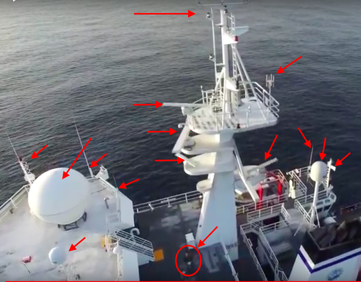

all the antenna transmitters and receivers ... lots of traffic/interference, not including that giant metal ship, and this phantom still flies ... awesome ...
Thank you for pointing this out. I was, of course, aware of those transmitters and receivers, but I didn't figure they would be using the same frequency band as the drone or that all of them would be transmitting all the time. It's a good thing that you didn't draw my attention to this before I made those flights. That factor combined with the problems with compass calibration might have been enough to cause me to keep the drone grounded while at sea.
Reactions: BoydBros
Only devices that transmit could create any interference. Receiving antennas are passive and no threat at all.
The actual sources of potential interference would just be a radio antenna or two and the radar units.
But as long as you are not flying up close to them they aren't going to interfere anyway.
I've flown close to many ships without any interference problems: Shipping - Above & Beyond Photography
I was pointing out all the possible sources of interference, that is all.
