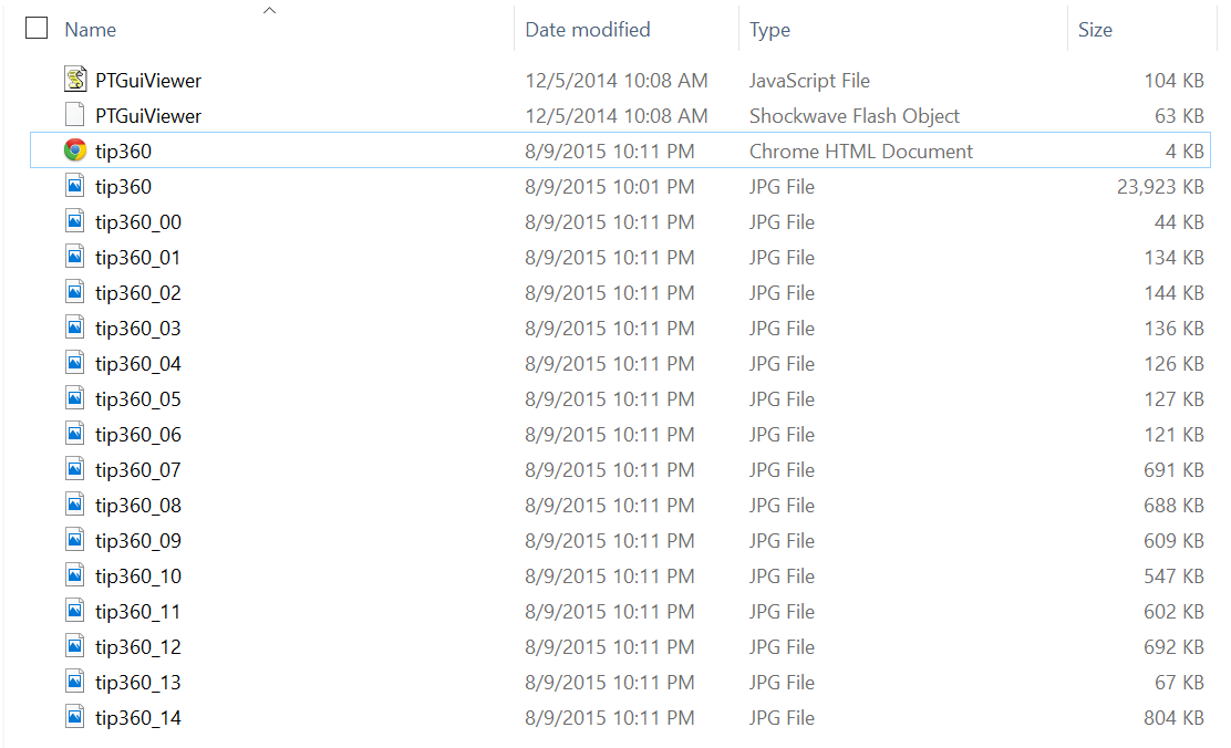

Interesting observation - the final jpg for the new version is roughly the same size as the original despite the fact that the camera only pics are higher resolution each.

I tried to upload to google but it said "Upload failed: Image too big". The JPG is 24mb. What size was yours?
