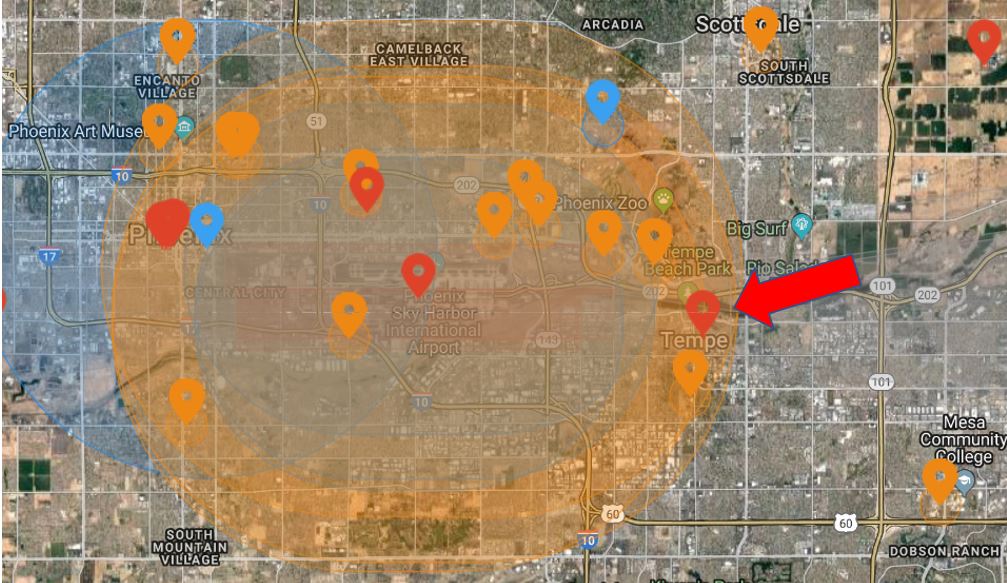

I have been flying same construction site regularly (P4P). Have LAANC authorization to fly at 250 feet in a 100 feet FAM grid. Made the mistake of accepting the NFZ upgrade on the prompt. Yesterday a message came up that I was limited to 196 feet. Is there a method to get cleared higher?
Just guessing but are you near a runway threshold? Thanks to the horrible new dji geo 2 that now has a 60meter(196 feet) to 120 meter(393 feet) near runway approach/departure you are likely limited. Even though you have your LAANC you now also need dji unlock.

I'm 4 miles away from the threshold. I'm so sick of this nonsense, everytime I think I got it all figure out, some of this same garbage crops up. How do I unlock this? Thanks.
I'm 4 miles away from the threshold. I'm so sick of this nonsense, everytime I think I got it all figure out, some of this same garbage crops up. How do I unlock this? Thanks.View attachment 105918
This is just another reason why so Many of us Preach the 509 firmware, taking your drone back to being responsible again but you do have to remember not to update , but this is the answer you seek. Having a drone with a 509 firmware on standby is the way to go.

Yep looks like you are stricken by the horrible new dji geo 2 system and altitude limits. I also am in the same situation but was able to unlock by going to DJI - The World Leader in Camera Drones/Quadcopters for Aerial Photography letting them know the lat/long of the location I wanted unlocked, just use google maps and drop a pin then copy paste the cords

It is not the firmware. It's the Fly Safe Database. My 2.0 is in it's latest firmware and DJI Go 4 on it's latest version, but my Fly Safe has been asking for update since October and Geofencing 2.0 was released in November. I flew my P4 today at 400' at the edge of the 5 miles radius (LAANC approved), but my buddy's P4P wasn't able to go past 150'. He has everything updated.
