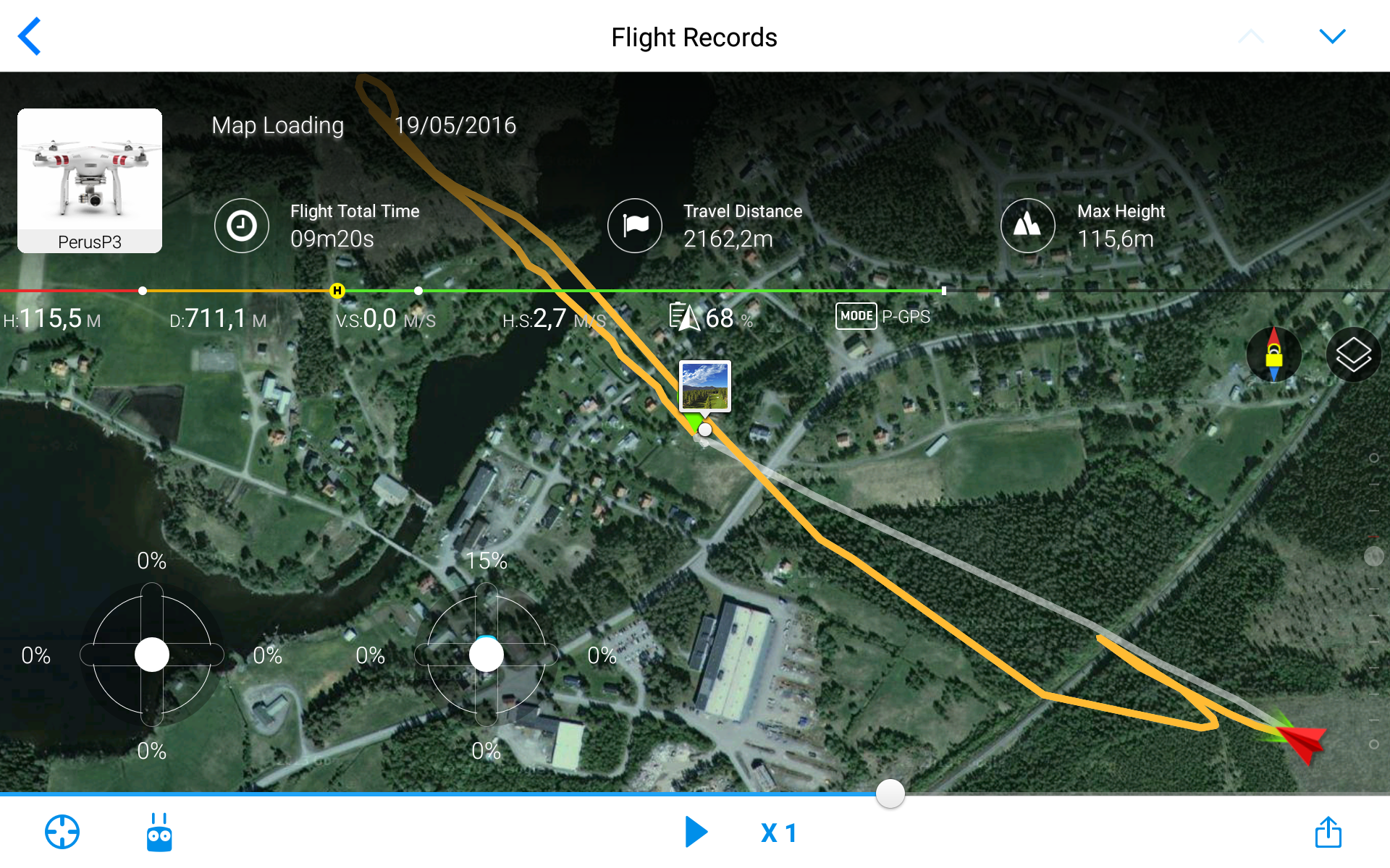

Yesterday weather allowed for a longer flight in Sweden (CE) and this time the purpose was to examine if the 1.6.80 f/w changed the range in some way (compared to 1.3.50+)
Screenshot as proof below ;)
At 700m+ - started to get weak videosignal but no loss of 5.8G RC signal, returned home manually.
This is in CE-mode and no modifications whatsoever, going to try the limit this weekend if it only could stop snowing :)

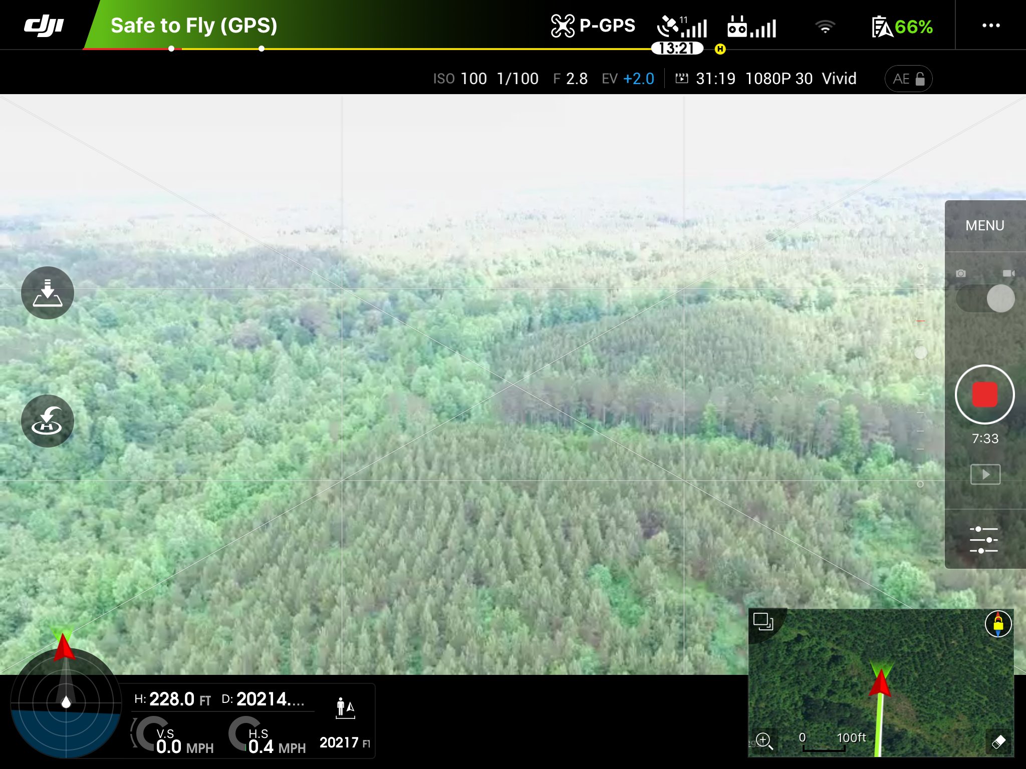

That's all I fly around is trees and water here in N/E MS and have read that also but it doesn't seem to bother me .
Maybe shooting the signal through the foliage but over it , I dono . My 4K
IMG_4378.PNG now I do use itelite panels on that and have got 3.02 miles with my standard a little higher.
From what I have seen as long as you have LOS tree's don't hurt ya .
Or not me anyway .

View attachment 55106 now I do use itelite panels on that and have got 3.02 miles with my standard a little higher.
Or not me anyway .
Those MOD antennas are what helps. Stock, not so much. It's not going to completely wipe a signal anyway, but it can on occasion, depending of course on all the factors at play, density of foliage, humidity, temperature, focal point, if your left toe is crossed towards the left foot or pointed southwest, etc etc etc
