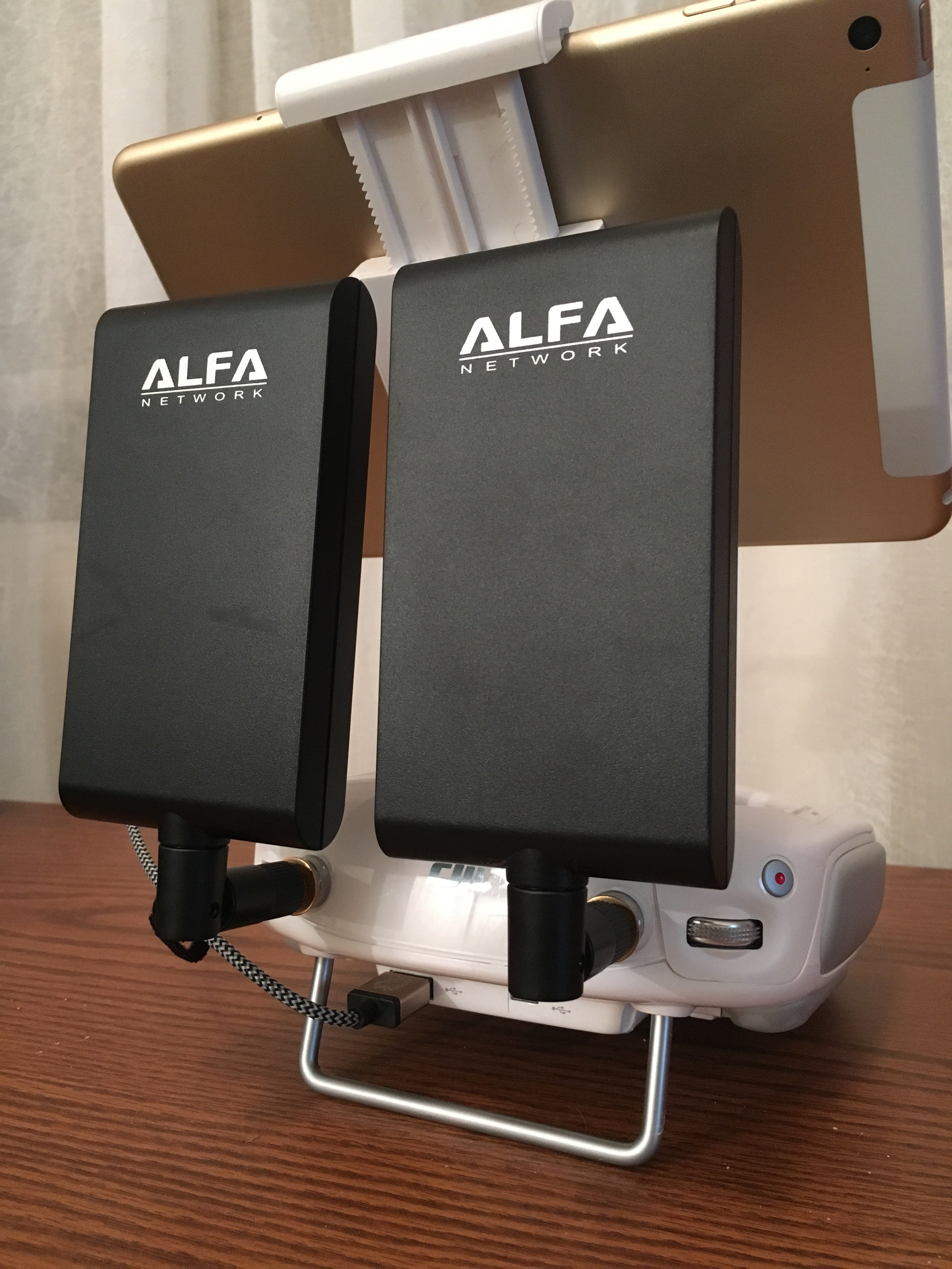

Alfa 2.4HGz 7dBi RP-SMA Panel = AWESOME!
Ok thanks. So what if any increase in signal would someone see in just replacing the stock antennas with some of these paddle ones?
I was getting less than a mile with the stock antennas where I live. With the panels I'm getting well over 3 miles, I run out of battery way before I run out of signal.

On the order page it gives you an option for inner or outer bore. Beats me lol. My guess would be female(inner) and male(outer)
You want the antenna lead to be female rp sma.

I believe you want male (as shown in the picture) coming out the front. Most screw on antennas are female SMA connectors..
These will come right out of the stock antennas holes after the stock antenna are removed. No holes to drill and you can put everything back to stock anytime you want.
