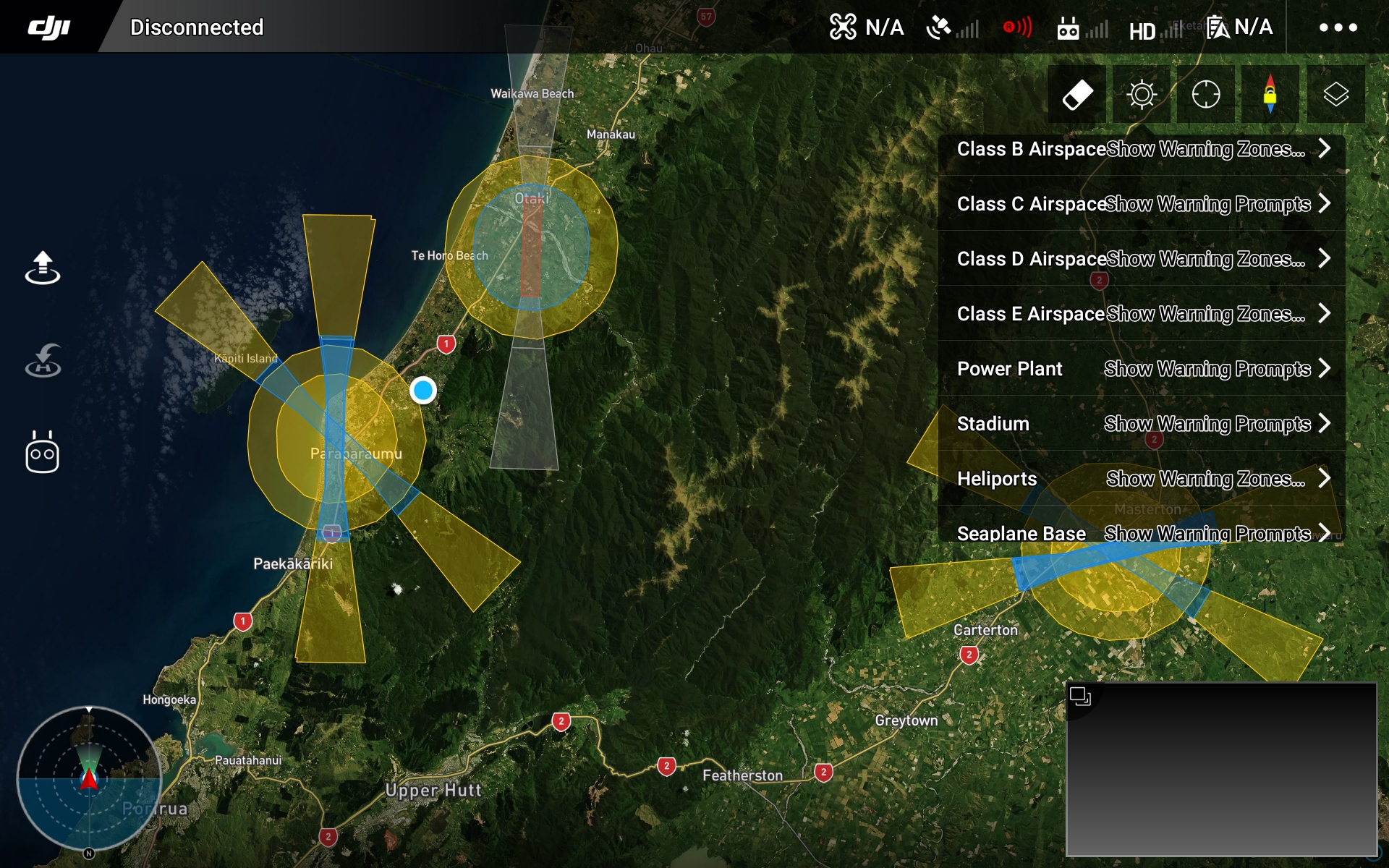

Cool hooked now ,,um you not mention which pro p3p or p4p,,this what comes up with my p4...i certainly ain't the cleverest one to comment on this but I prsume heliports would be classed as airoport,they mostly take off from our local ones,,,the odd farmer might have one but would still have to land at some heliport--airport,,and welcome
