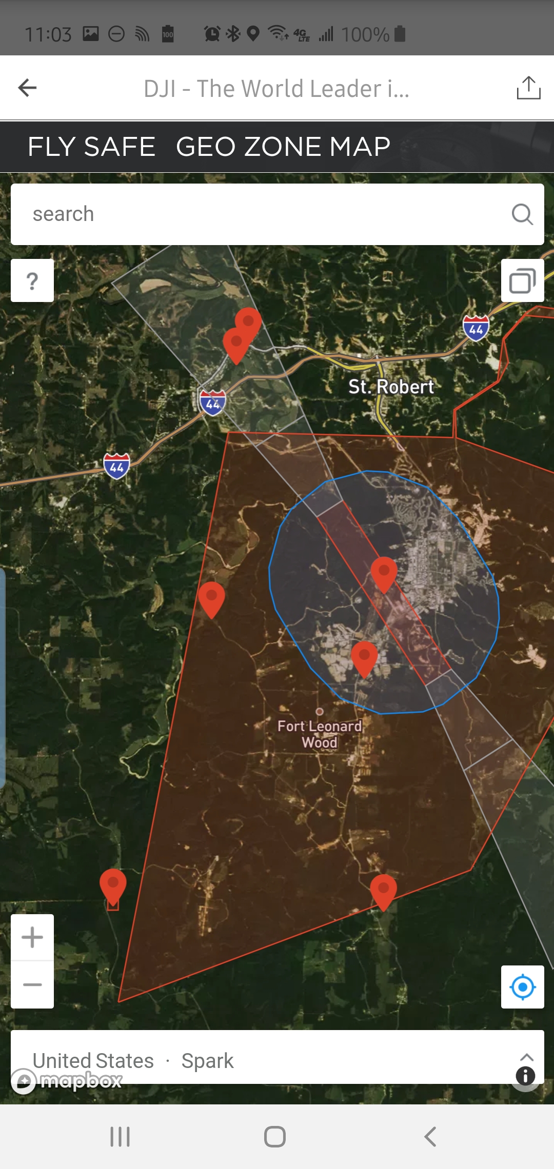

@sar104
So I finally got a chance to open the go app and see what I have. The Fly Safe Geo Zone Map screenshot is what I got.
This is the version the app is showing. I'm not sure how to go about updating it. Need more help!

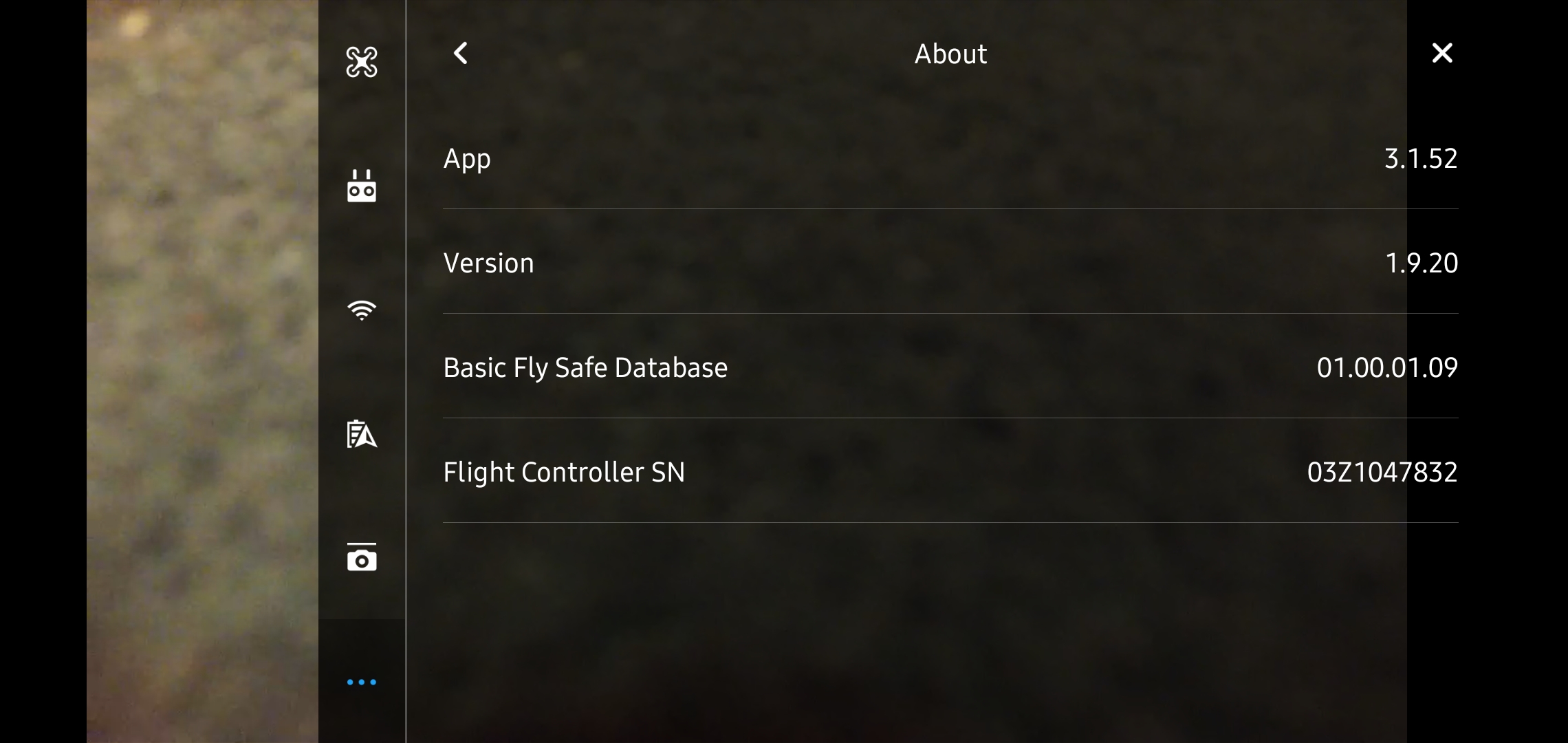

Yup. Unfortunately the area in question is under the app's geo fence as well as the birds' software. I was using Litchi at the time. Switched to GO to find out the problem. All red, "NO FLY ZONE" No prop spin at all here. Waiting for the expert to give me advice on the basic Fly Safe database. Mine has not updated, and if it's a firmware update needed, I'm not doing it. Bird flies just fine everywhere else. The suggestion was given by an "anonymous friend" to use foil over the GPS antenna, and it does indeed work. My biggest concern is the closeness of a Cannon Range the A-10's use regularly. I'm not even remotely interested in destroying a multi million dollar aircraft and possibly killing/injuring civilians or pilots. The damage my equipment will suffer, not being able to fly this field, is very minor in comparison. If everything else works out, and I'm able to use LAANC to fly this particular field, then great! Otherwise I'm done trying. Not really worth the extra effort these guys are putting into it. I'll hire a bunch of high schoolers to walk the field next time I have a problem!

@sar104
Yes - that looks correct and up to date.
113358

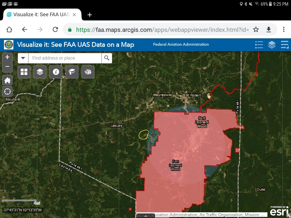

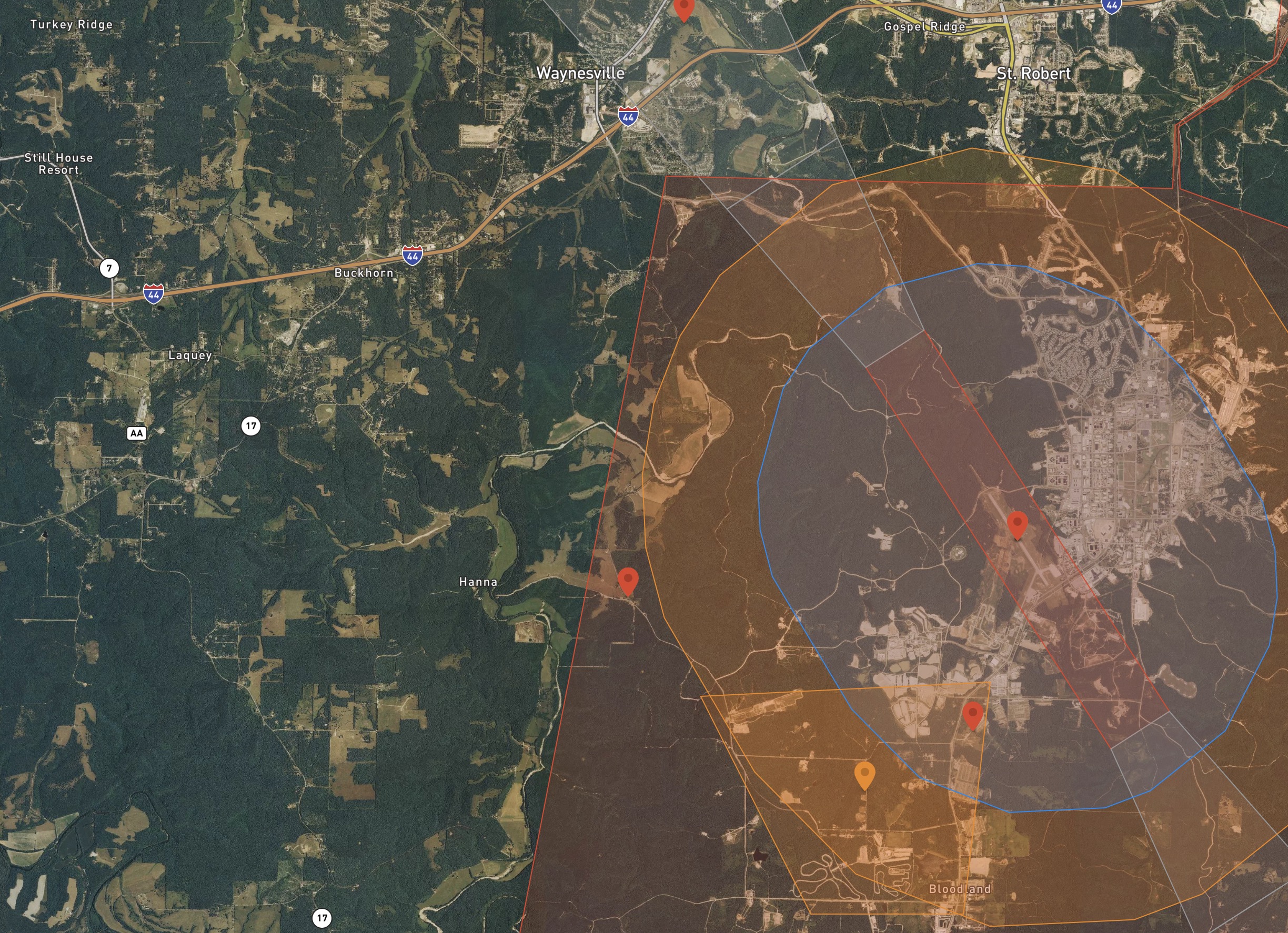

Your field is outside those zones - as we discussed above - unless you have another location in mind.

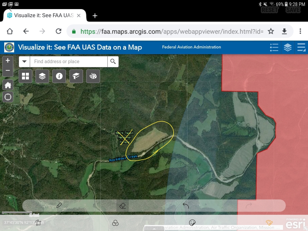

Autels are GPS enabled, however, they do not have geofencing. Looking at some of the images of the airspace around you that sar104 posted, looks like you are at the edge of active airspace? If you are outside of that, you should be fine. Toss an Autel Evo or Autel XStar up and find that piece of equipment...IF you are not encroaching on controlled airspace. If you are, use LAANC to get authorization for the flight. Point here is that the Autels will NOT stop you from flying like the DJI's will.
