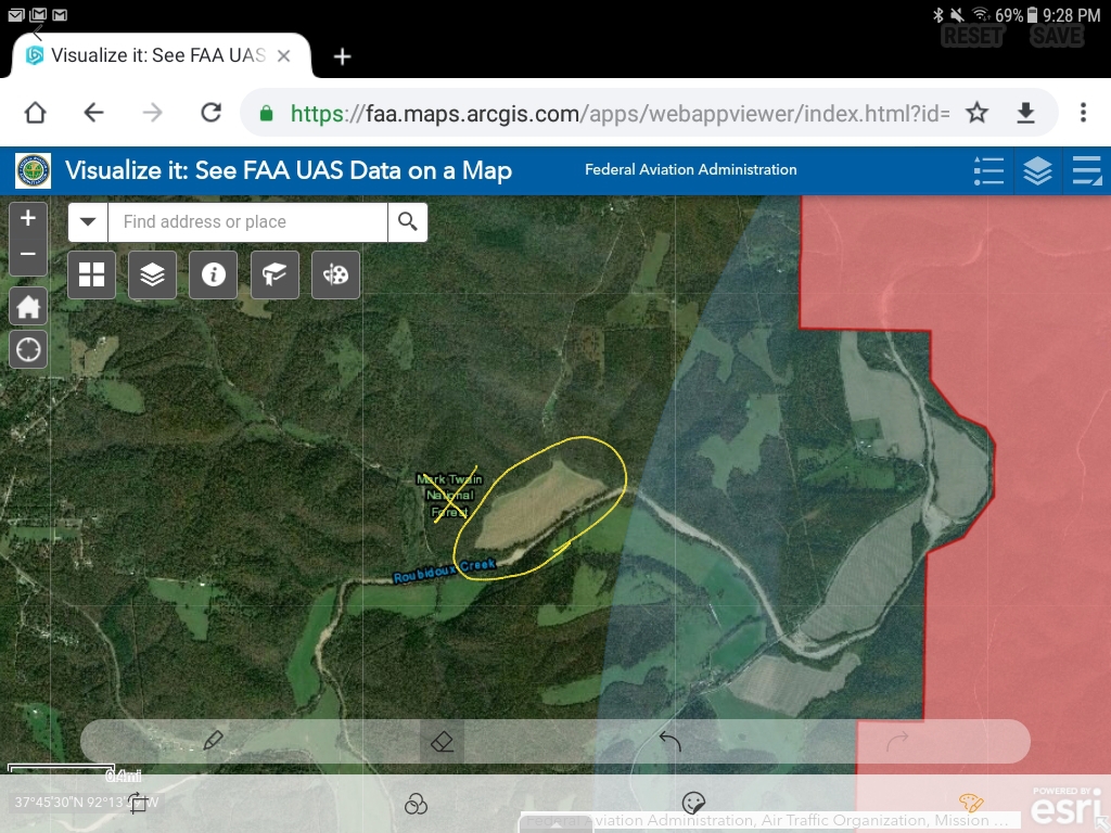

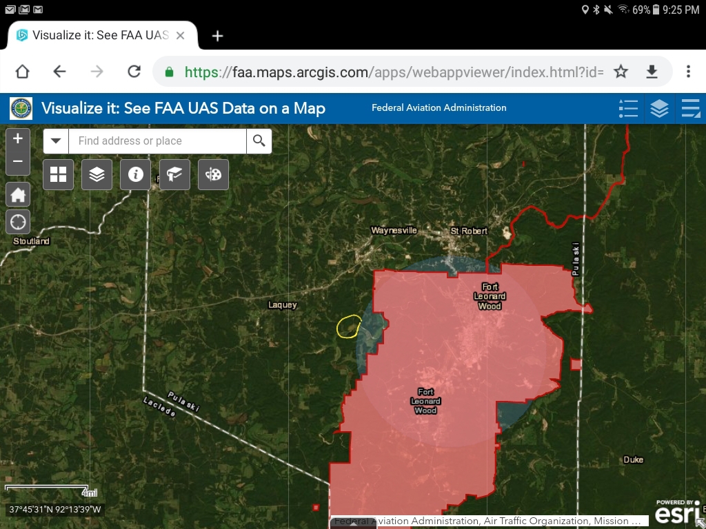

I posted a while back on this, and got a few ideas for helping resolve the problem, but they went nowhere. The issue is this: I have a field I need to fly over that lays just outside of Ft Leonard Wood's NFZ. I have contacted FLW ATC and discussed the problem with them, and they told me to fly a kite... Ok, not literally. They said it's not THEIR problem, and that's true. It's DJI's problem, but how do I go about resolving this? There's a very valuable piece of equipment, in the neighborhood of $250k, that will be in this field in a few months, and I'd REALLY like to find the OTHER piece of valuable equipment that fell off the spray company's rig BEFORE it runs thru the combine! The field is in the neighborhood of 52 or 53 acres. I know that doesn't seem very big, but it is when you're looking for something that's about twice the length of a kitchen broom, and a little wider than your standard one gallon milk jug. And it's black, with a steel bar mounted at a right angle to its long axis, and weighs about 250lbs. And it's now in corn nearly 7 ft tall. That equals several thousand dollars damage to the combine I would very much like to avoid. I may not be able to locate it in time this year, and I've repeatedly warned the various possible operators to remember this thing they may run across, but when it's not THEIR money on the line, they're far less likely to be as diligent as the owner. I want to fix this problem in case there are issues in the future. I have a couple screenshots to show the NFZ, and the field that DJI is keeping me out of with their geofence. It actually covers the entire field plus a little. Any help on this, dealing with DJI, would be greatly appreciated!

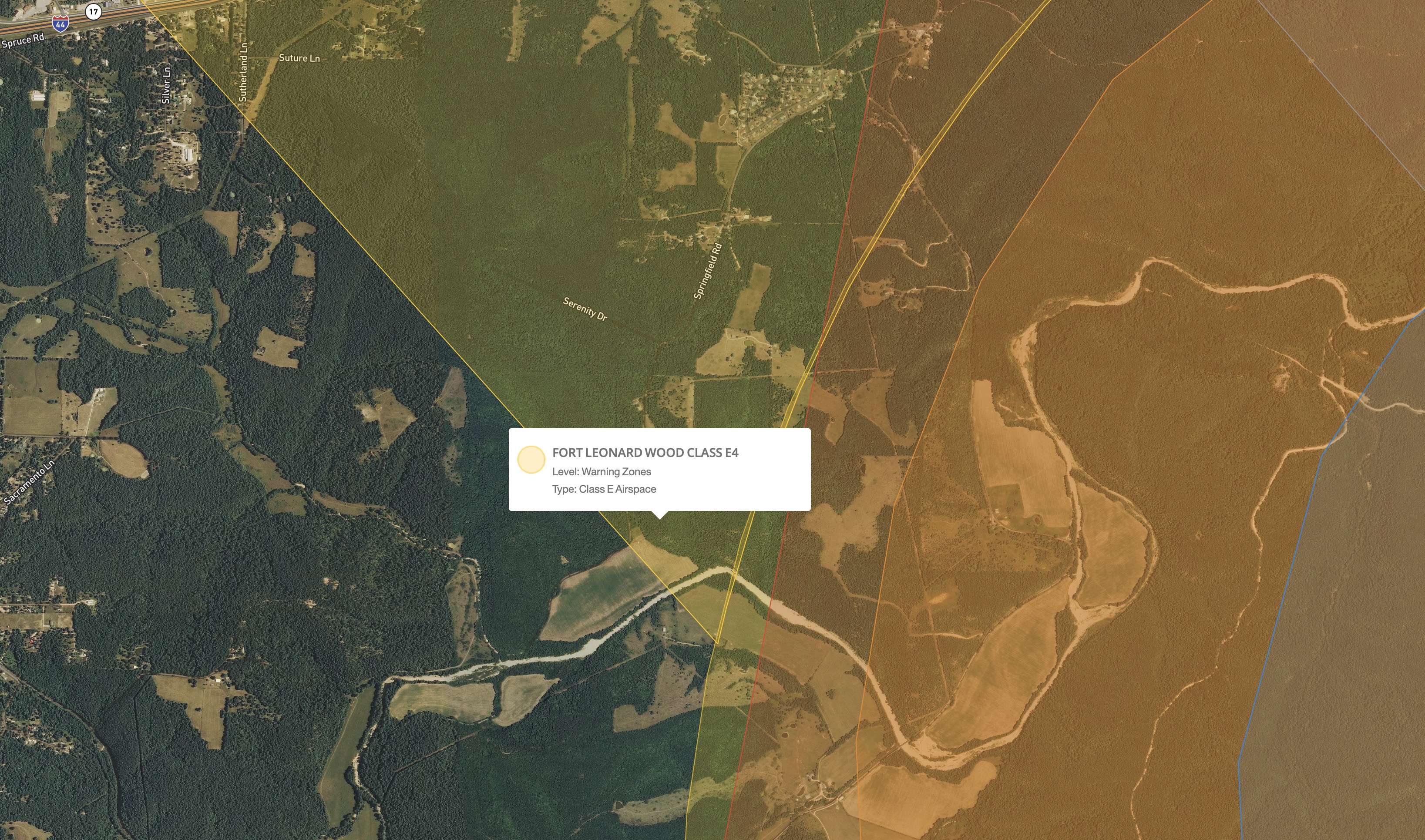

Have you updated the flysafe database? Because according to the latest DJI Geo system maps, that field is not in restricted airspace. The east end of it is in Class E4 airspace, which shows up as a warning zone but won't prevent flight. Most of the field is in uncontrolled (Class G) unrestricted airspace.

I have not yet. I just got done looking at dji's flysafe map, and it was fenced initially as the page was loading, but now it won't even show FLW's NFZ... ? Thats a wtf? In my book... gimme a minute to reload this thing...
@sar104 I may have just wasted your time, good Sir! I would like to attempt a flight tomorrow before retracting this thread, but it does appear you are correct! Didn't even think to update. Guess that's why you make the big bucks, huh? ??
