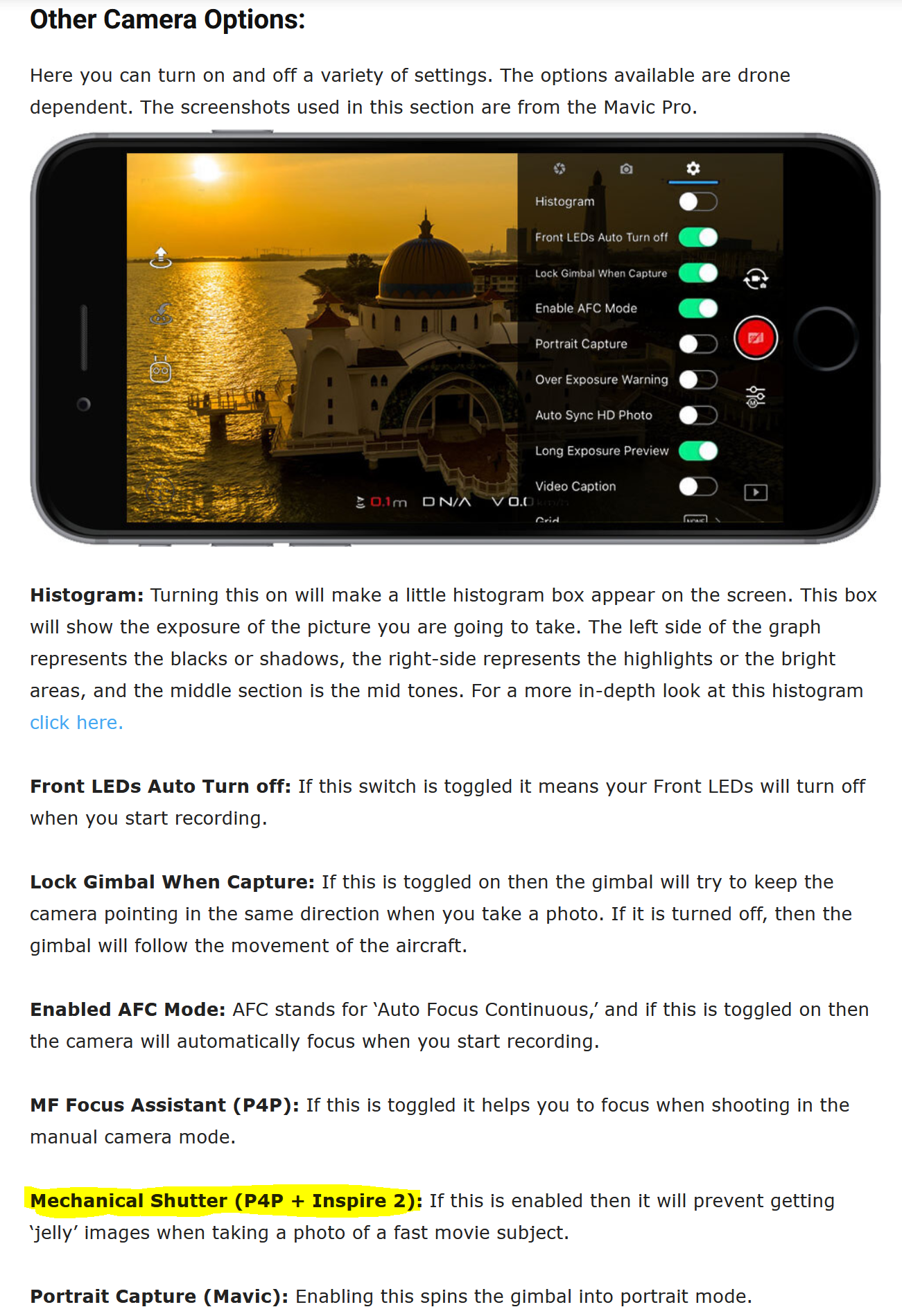

Also try turning on the mechanical shutter function and or resetting the camera functions
