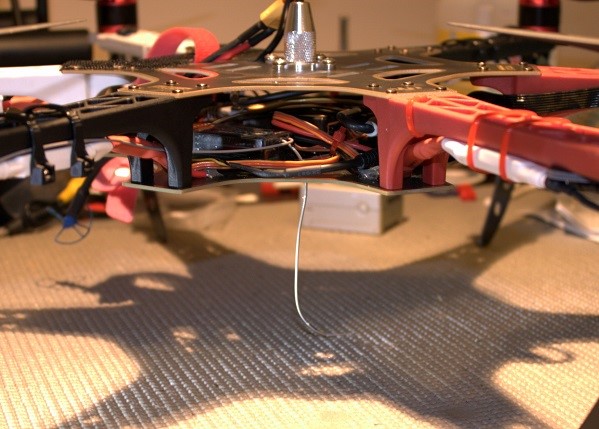

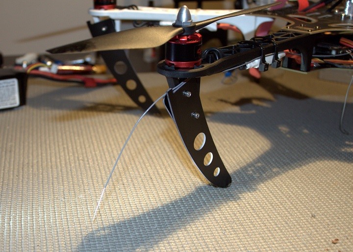

So I ordered one of the 400mm Futaba replacement antennas. They are designed for RC boats, but will work with any Futaba 2.4GHz FAAST receiver regardless of the platform. Installation was very easy. Just popped the plastic case of the receiver, pulled the old antenna off the circuit board and then snapped the new one on. Took all of 3 minutes at most. Didn't even have to remove the top plate to do it either.
I left the stock antenna hanging straight down through the bottom plate of my 550.
I routed the 400mm antenna down one of the arms and let it dangle off the end.
I took her out this morning for a quick jaunt and was able to hit 1800 meters (Yes! Finally surpassed the mile mark!) without it going into fail safe!!! Still had a great picture from my Boscam FPV equipment too! I would have pushed it even further but I stopped at 1800 meters and did a 180 only to find I had NO VIDEO when the hex was facing me! Kind of freaked me out so I really didn't want to push it any further.
Now I need an FPV transmitter with two antennas! One forward facing and one rearward... then I'd be all set! ;)

P.S. Yes the Iris Aerial landing legs are canted back instead of flush with the bottom of the arms. I did this to minimize getting the legs in frame when pointing the camera straight down.
