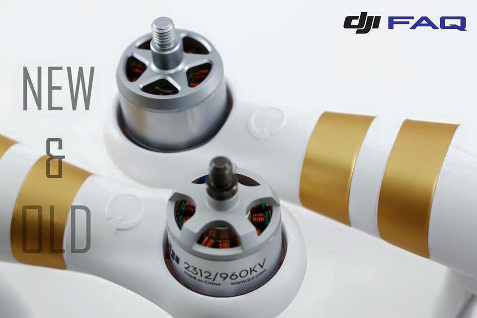

Often times it's the ESC which unfortunately is not a separate board on the P3s. The motors are very cheap however, so replacing one could be a good check unless you see something obviously cooked on the main board. If you choose to replace one or more motors, be careful to order the correct motors, new design vs. old design.

Sadly this has happened often. So much so that I included a reference to it in my tips post that I share as often as I can. Unfortunately, the guy who sold you that P3 must not have read this forum so the damage was already done when you got it. People think that if they spin motors to check for free movement that all is good to go. In fact, the motor housing spins but the windings are static and the windings are what gets damaged as was noted earlier by @N017RW.
In this case, I would at a minimum replace the two that did not start up initially. Best case is to replace all since as we've seen from your posts the original owner of that P3 seems to have jacked it up in a few areas. I'd just feel more confident with all new motors. Again, keep in mind the new motor design vs the old design as the ESC circuits are part of the main board in a P3 and there is more than one model of main board / motor design combo.
