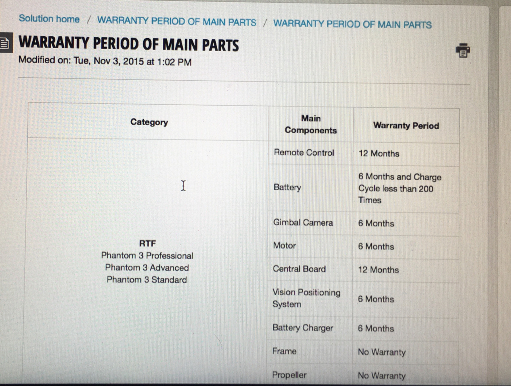

I'm getting ready to by a p3p as well and this is holding me back. It clearly says on their website that they provide no warranty on the frame. Obviously it looks like they have been warranty repairing them till now but it can stop at any time.
I'm not sure if this was their change, but it shows that the warranty page WAS changed this month even.

In1 year will they repair it for free????
That I don't know, although I'm pretty sure their maximum warranty period is 1 year. And as mentioned above, the air frame is officially stated to have no coverage under warranty at all - yet they're currently fixing them under warranty!?!
The way I figure it is: if after a year of flying, if a shell develops cracks, I would purchase a new shell and swap it out myself. To me, I'd consider that more of a maintenance issue. Similar to a cars 'regularly scheduled maintenance'.
But who knows... maybe DJI would still replace the shell after a year?
