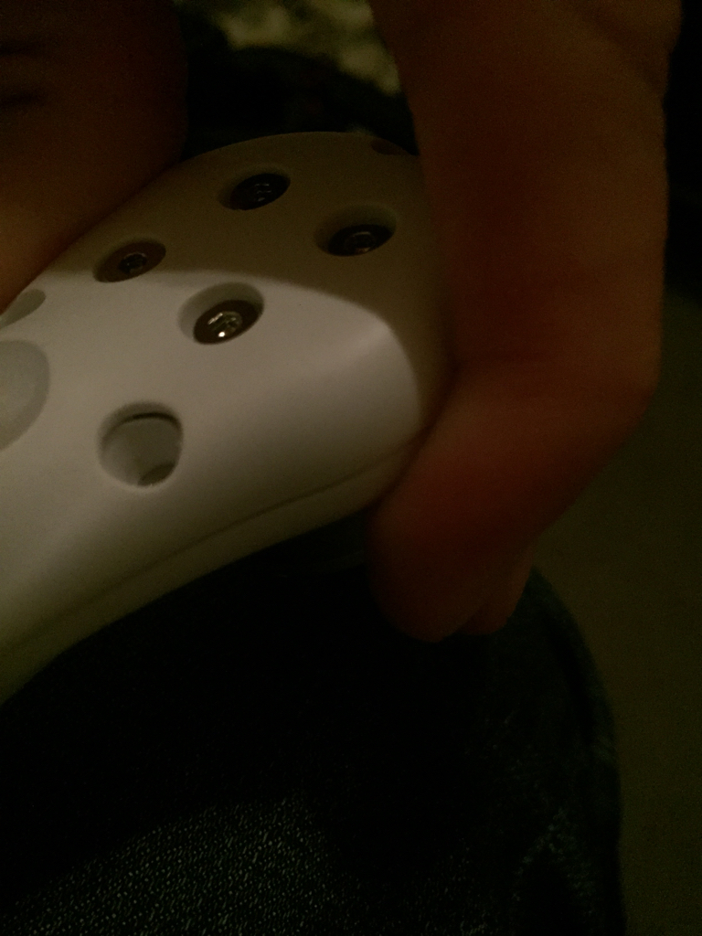

    Just picked up a P3P less than 2 weeks ago that was shipped fresh from the factory to my local DJI dealer. I'm about 10 flights in and just noticed a stress crack near the back left motor mount.
    I was hoping this defect was resolved in the latest production runs but it doesn't appear to be the case... :/

    Actually that looks like the shell connecting screw standoff but whatever you want to call it, it is really bad news. Sorry for your problem.

    In your case, the cracks are NOT motor mounts stress cracks. Get cable ties and tie all 4 arms closest to the motor and fly the tits off it until it gets cold and send back to DJI in the cold break.
    My stress crack appeared after 2.5 hours of flight. It's spring here in Aus so I cant afford to wait 2 months. I ended using hobby glue to minimise vibration (though I think its combination of both heat on vibration on brittle craplastic).

    RMA it for warranty work. It doesn't look like the shell is the newer design some people have been getting that is suppose to address the issue. Don't goop up the cracks with glue etc. DJi won't accept it as a warranty repair if you decide to do that then return the P3 under warranty for that issue.
    On a side note I have a P3A and P3P bought early so original shell design. 65 flights on the Pro and 91 on the Advanced and neither have cracks. So it's not happening on all of them.

    Hi - I do a thorough check of the airframe every 4-5 flights and I just noticed 2 cracks, similar to the one you have shown. Were you able to get this matter resolved?

    I think a lot of it has to do with how tight the screws are in.

    My 2 day old P3A from DJI direct looks exactly the same with new motors. I think their shells are just all over the place. You think that its not newer because no indented ring around the screw holes correct? I havent taken my motors out yet but I can see it has the X design with no indents around the screw holes

    That may be true.... but honestly, that's totally on DJI. I can't have my phantom fall out of the sky cause the screws are too tight. (Sorry, not trying to shoot the messenger or anything... just venting that this could happen after so few flights).

    My personal opinion of that photo is that you can still fly it with no issues. Do as the other guy states and just put some zip ties around the arms and send it in when it gets cold out.
