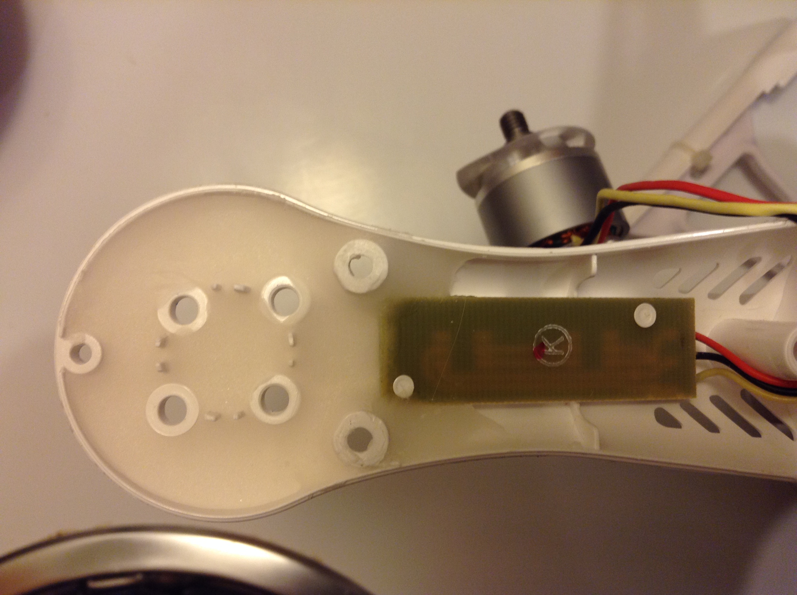

Use this material, I Used it on a Fresh out of the box P3P before ever flying it This stuff is like Steel, Super strong an easy to use, mix it up thin and pour it around the base of each moor mount area to a thickness of about 1/4 inch, just short of the screw holes for the motors. Allow it to harden an hour and it will become super bonded to the body shell. It is Miracle material, guarantee never a stress crack. Plast-aid® multi-purpose repair plastic for your repair solutions.
If folks cannot find this stuff easily, I'm sure JB Weld would work exactly the same.
I haven't a clue maybe some data on the website but it adheres wonderfully and becomes one with the body material.. and is incredibly light and strong. You can even drill and tap it.
Here is a photo from my arm reinforcement using Plast-Aid. It is strong as steel and bonds to the shell as if it were original material. Over 100 flights and not a hint of a crack anywhere.
Just received my P3P today. They gave me the old shell and motors. Should I purchase those reinforcement plates before the stress cracking begins?
Here is a photo from my arm reinforcement using Plast-Aid. It is strong as steel and bonds to the shell as if it were original material. Over 100 flights and not a hint of a crack anywhere. View attachment 34319
In fact this stuff is so strong a piece 1/4 inch thick and 2 inches long you can not break with your bare hands..

I know I sound like a salesperson for this product but I'll say this much.. It is so good, I'm confident that in a crash the only thing that will not be broken is anywhere the Plast-aid is applied.. It will survive
I've check my p3a, bought early Oct in Canada... has old motors and shell. I've only got a few flights with it, but no cracks... yet!.. Martin Smith how have you put on the plast-aid? just around outside the screw holes inside of shell? great info, thank you!
