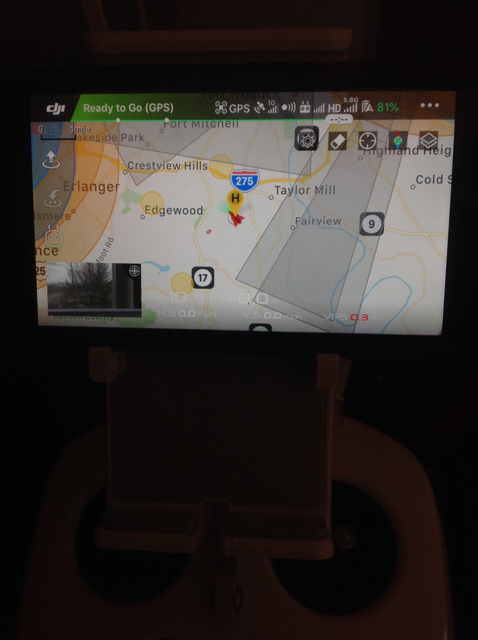

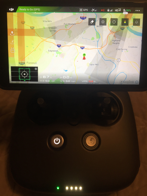

Here's my Green & Yellow Home Point bubbles.
First when paired to Pro PLUS controller
Second paired to Pro controller / iphone 6
DJI Pro +
DJI PRO with iPhone 6
