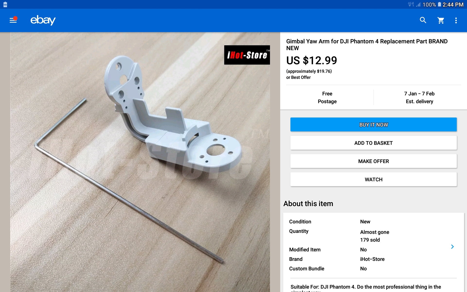

You have to watch those trees that jump out,,Ebay has lots of parts and cheap too,,bit pointless trying to power up cam cause it not mounted and might tear ribbon cable,,,do they look ok,,it might pay to order a cable set aswell,if cam broken off there's bound to be ribbon damage,,
