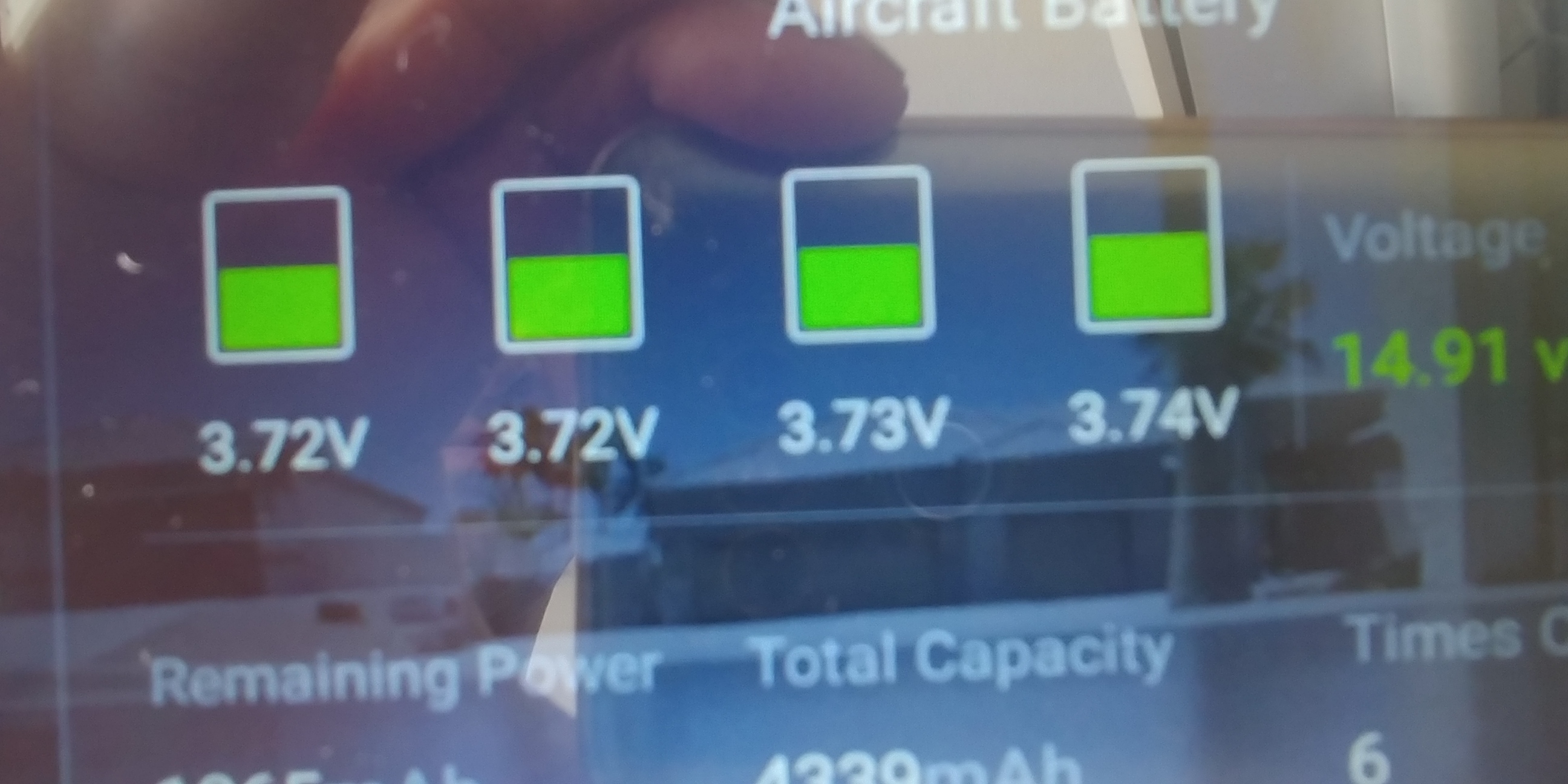

Would you fly with this battery?
Aug 20, 2016
286
73
65
Only 5 charges on this P3A battery.
It flies fine but then I saw the battery status.
Cell 4 looks to be weak. If it's an old battery it could be due to prolonged storage. It might come back to life if used a few times. I wouldnt fly too far or too high and I'd definitely keep an eye on the battery status in the Go app while flying. If it was mine id hover close by until the battery is low enough to auto land, let it cool, then power the battery on before connecting the charger to let it properly fully charge and see how the cells look then. Good luck!
I should add, whenever testing a "suspect" battery during flight its best to keep the AC close by and low. And disable "smart RTH". You don't want the AC trying to climb to the default RTH altitude with an untrustworthy battery.

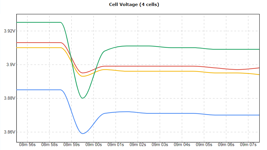

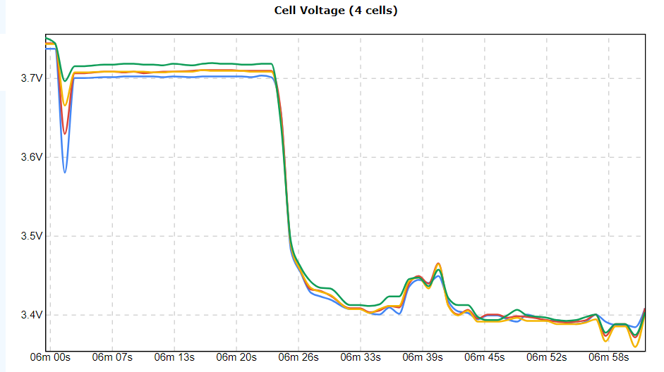

That's a very short flight time, assuming you started at 100% charge. For it to autoland on critical battery at 37% one cell had to have very low voltage. Would have been interesting to see the cell voltages just prior to the auto landing.
Not full charge. I was at 44% and just trying to wear the battery down and give it a good charge.
This was cell volts at 35% charge
The blue line is the cell in question
That's quite a variation in cell voltages. Oddly it was the yellow cell that ultimately caused the critical voltage level. I would try what I originally suggested, power on the battery BEFORE connecting the charger and allow it to fully charge. Then when you have about 25 minutes to spare, take off and hover continuously until it auto lands. Monitor cell voltages throughout the entire flight and see which cell drops the quickest.

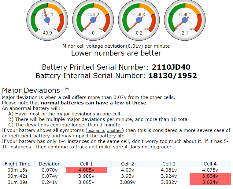

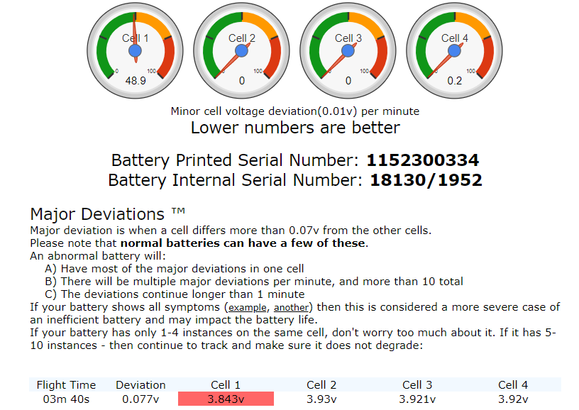

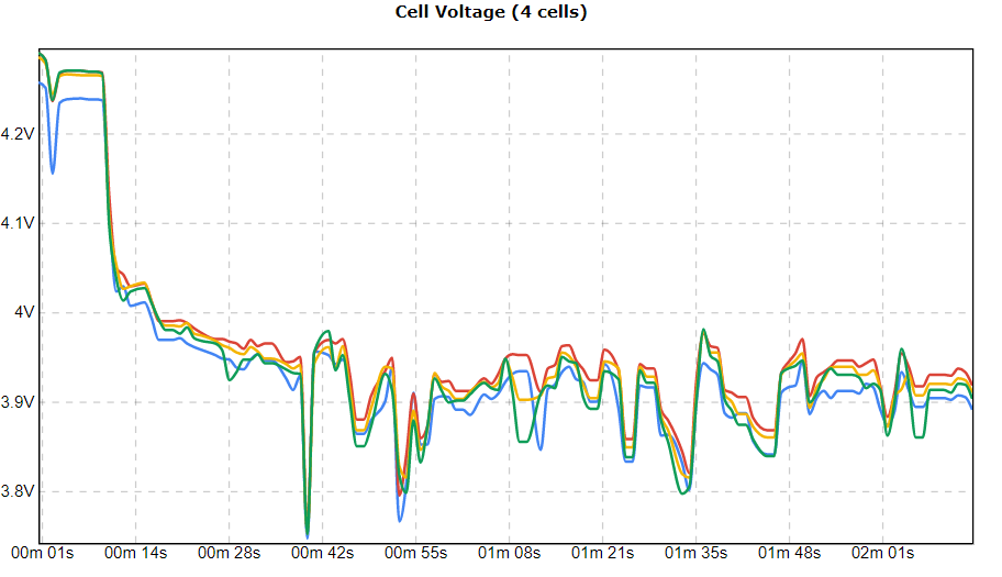

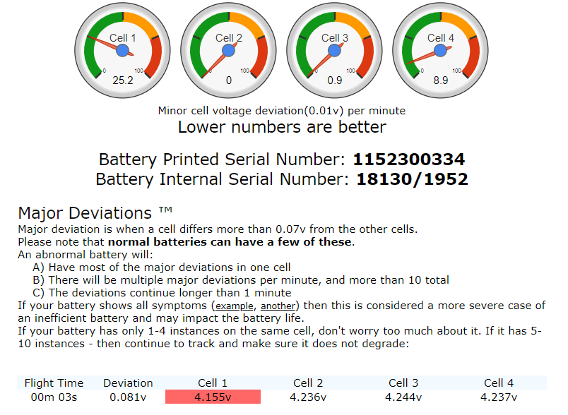

I drained the battery down to 2% and recharged as 3rdof5 suggested
Took it for a quick flight
Cell 1 got better. Cell 4 changed a little
It's probably coming back to life. I'd still do a full length test flight right from 100% down to autolanding to see how each cell withstands prolonged drain and warming up. Short flights here and there don't really stress the battery enough to learn anything.
