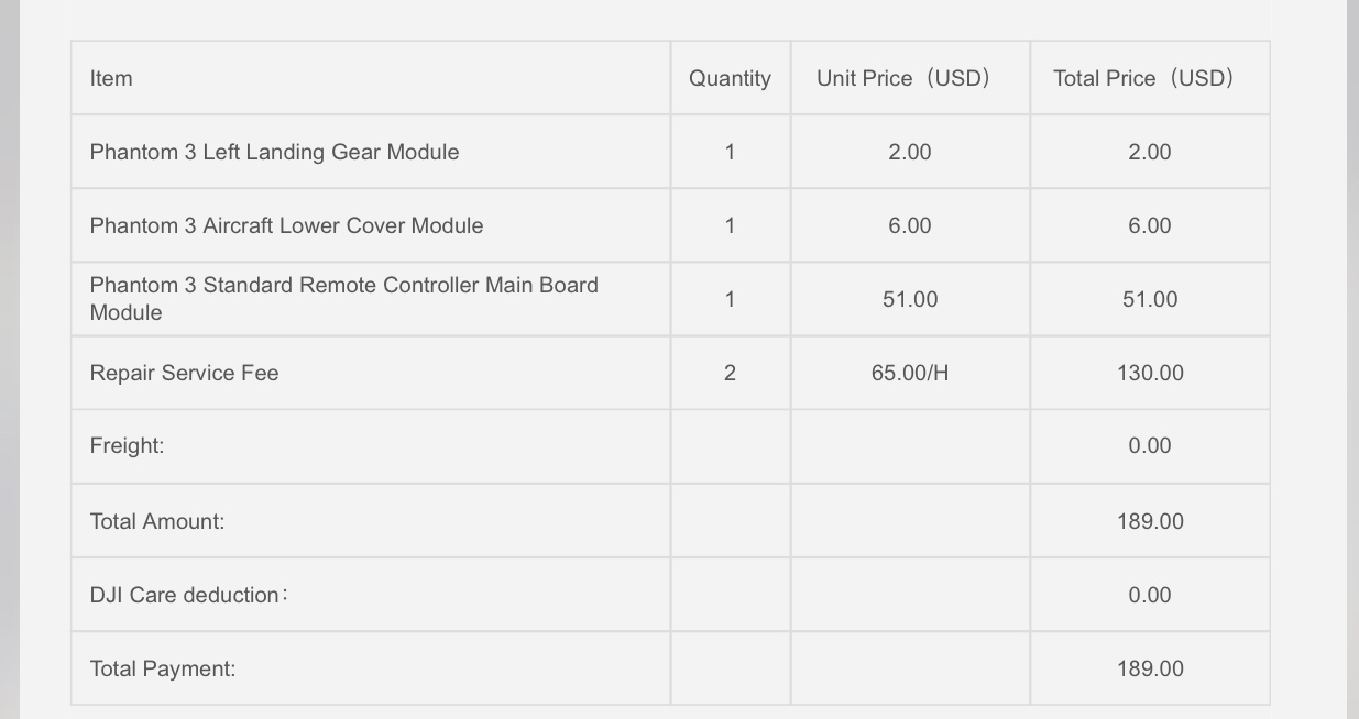

They charge $65 dollars an hour to fix the drone. With the main board we had to replace it was $130 for working on it and $51 for the phantom 3 Standard Remote Controller Main Board Modulehe part they are also fixing the cover for $6 and apparently the landing gear that got messed up when it got shipped and that's $2 so for every thing it was $189 to have it fixed. Which is not as bad as I thought it was going to be.

We sent the drone in and the problem was we had a bad Phantom 3 Standard Remote Controller Main Board Module they replaced it so hopefully when we get it back it works!

Do you have a receipt you could take a picture of, like the picture in this post. Terrible signal performance
Just cut off the personal info like I did and post it? ;)
Rod
Here ya go!
