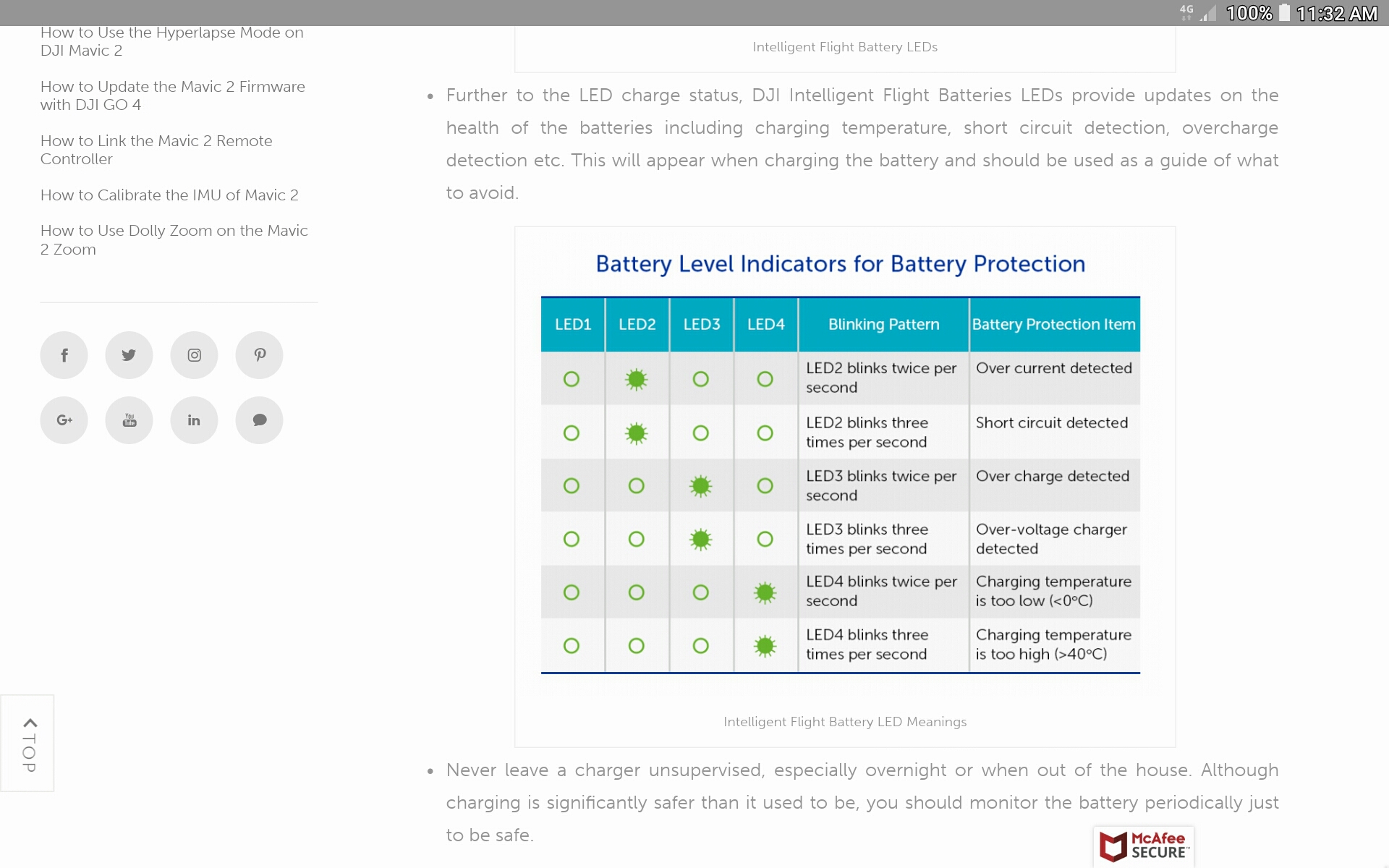

Try press and hold finger on batt for at least 5 sec and see how many lights come up,,it's possible the short has done something to batt...got another batt just to try
