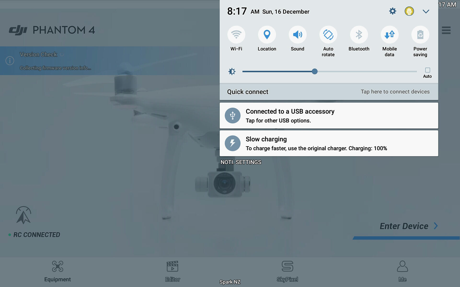

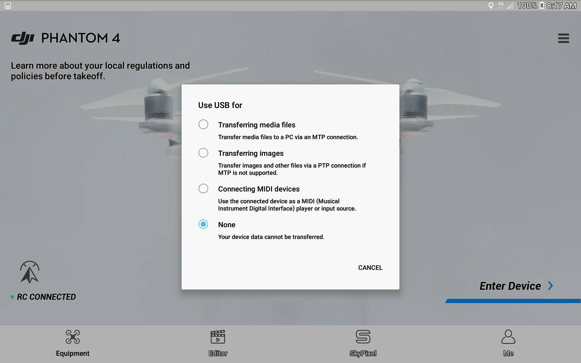

When conect usb swipe screen down to select what usb does,,see if this change anything,,I use Samsung devices...tap where it says tap for usb options
