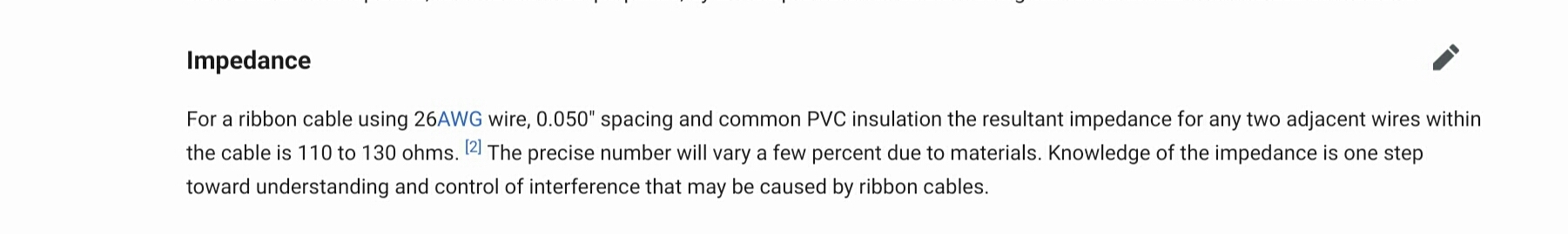

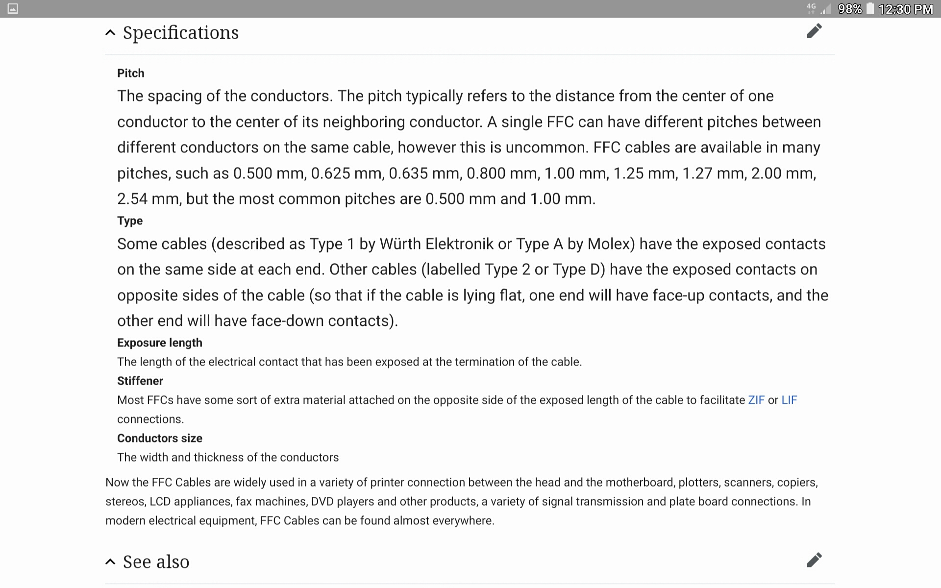

$60 is getting up there,phew,found little bit of info that might help answer,,mayby a spacing issue or coating on cable and something down bottom about impedance ,,(big word for satuday):)
