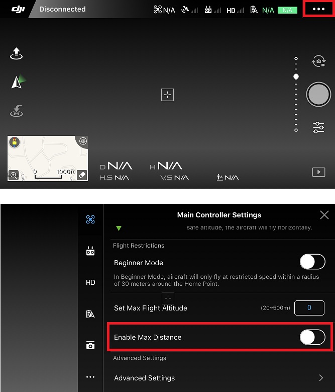

I have just recently started flying my P3S again after a few months of being stored away and have found It is now limited to 500m distance. Is there anyway of over riding this?
Did you disable the "Enable Max Distance" setting in DJI GO?
Yup I've tried that but is still stopping me from going passed 500m. Enable max distance is on but has a 500m limit box right below it. It sucks
Post #2 asked: Did you disable the "Enable Max Distance" setting.
And your answer was that it's enabled.
That setting is to have a Max Distance limit.
If you don't want a Max Distance limit, disable the Enable Max Distance setting

I've tried with it on and off. I will get out tomorrow and do some more testing just in case I have missed a step along the way. Thanks heaps for the help

Does your Phantom stop at exactly 500 metres?
Does it show any message when you get to 500 metres?
It stops bang on 500m and tells me I have reached maximum distance.
No warning before hand. I will do some extensive testing tomorrow. Just a quick question do I have to close the app, turn off bother the phantom and the remote then turn it all back on to save the new settings?

You'll see a prompt to update the firmware in DJI GO when an update is available.
No.
Make sure your Phantom is connected to DJI GO when updating that setting.

No doubt you need to disable the distance limit setting as mentioned in the first reply. That will instantly fix the 500m thing.
That's telling you that you have a Max Distance limit enabled and this has nothing to do with firmware updates.
If you don't want the limit, switch it off.
To save this setting, you have to have the app connected to the Phantom when you make the changes.
This is because it is saved in the Phantom - not the app.
