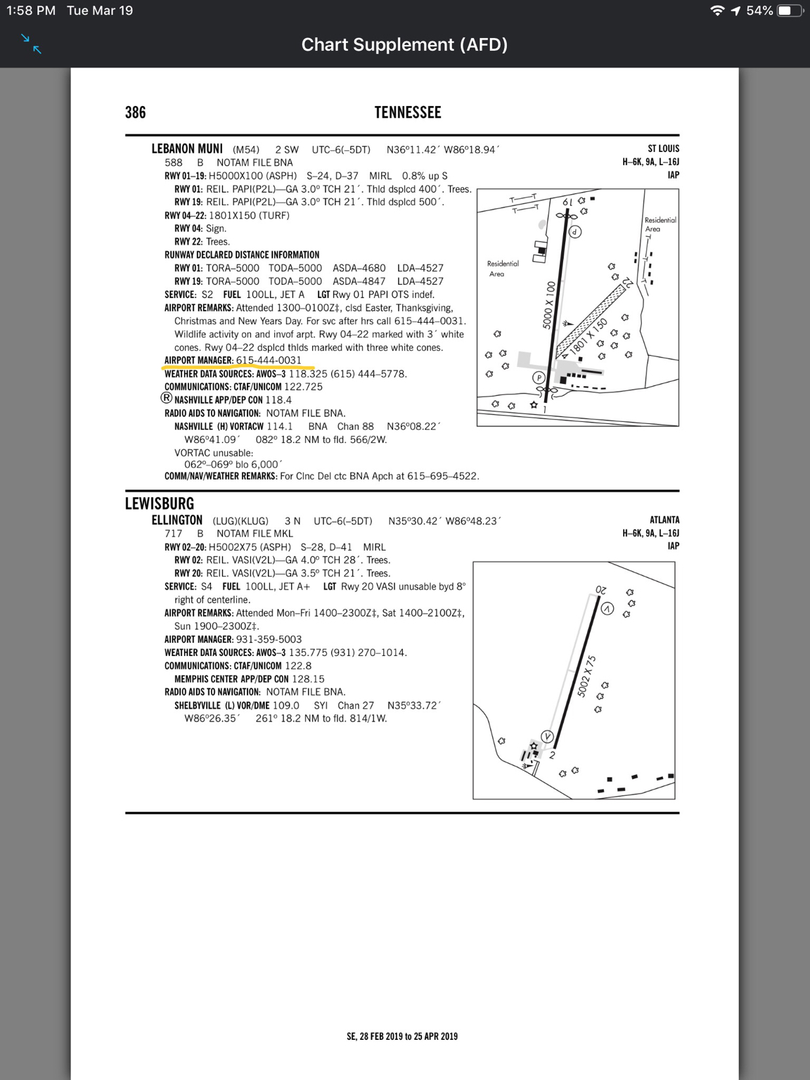

Here is the number your looking for

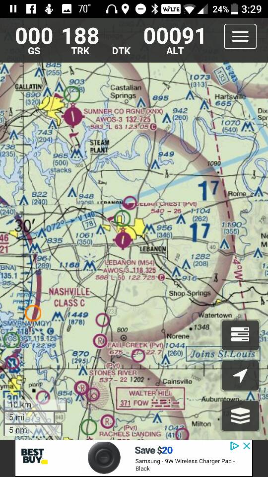

It's class G airspace below 700ft AGL for the area 5 miles radius of the airport. So if you are a 107 pilot you only need to stay clear of manned aircraft. Flying as an amateur, you use the 5 mile rule.

I’m a 107 pilot, but I thought the 5 mile rule applied to recreational as well as 107 pilots. Thanks for clarifying this difference.

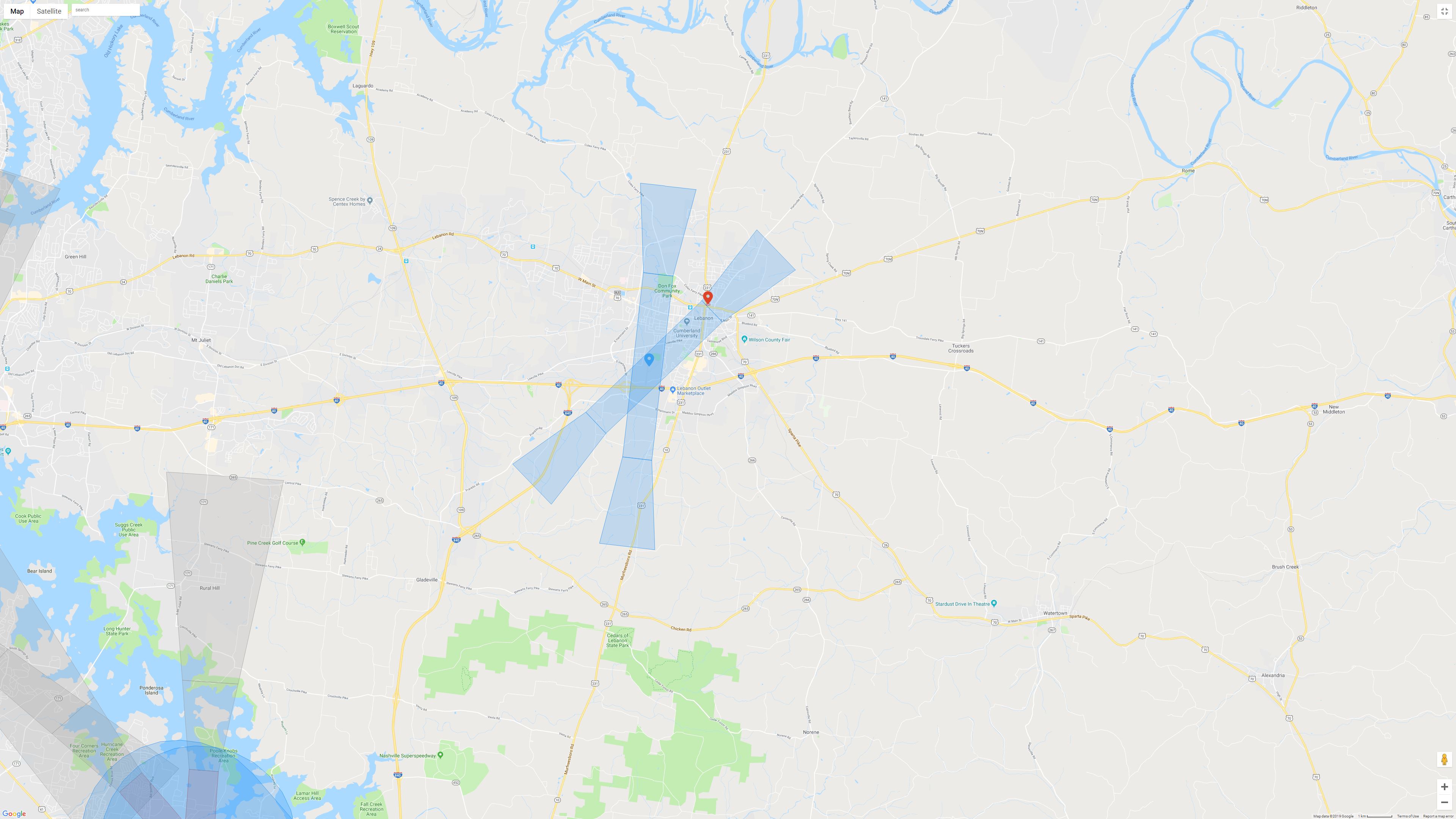

Taken from DJI no fly zone map. Hope this helps.
