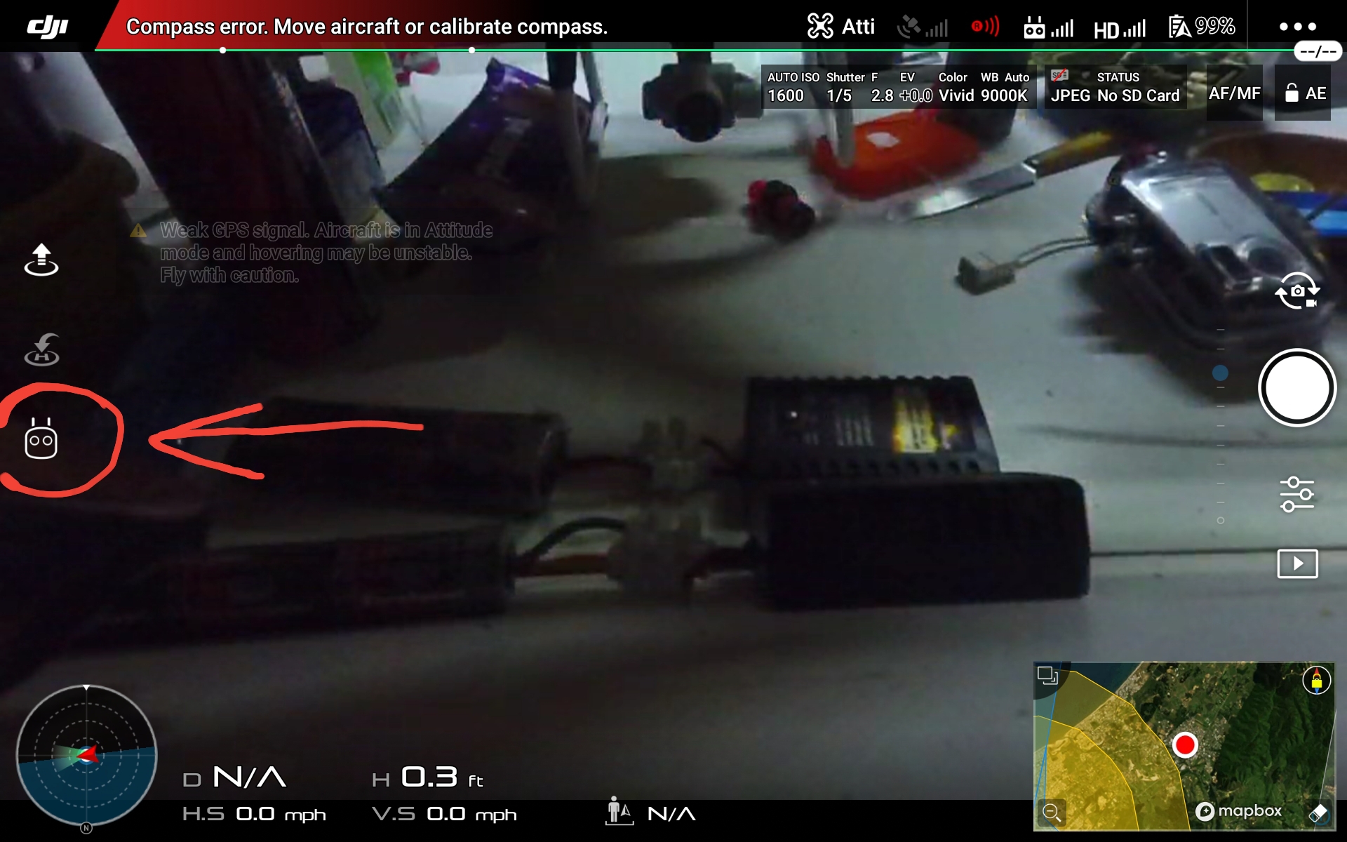

I use tab A ,,make sure drone and remote powered on,,click on the remote logo and different modes come up..I'm on new firmware and playstore app,,,

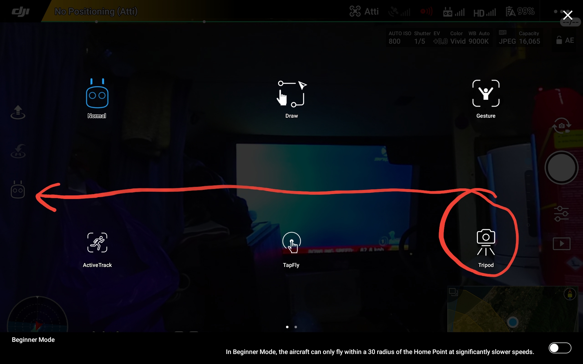

It’s There. Slide the page all the way to the right. More modes will show. ?
Do as ianzone shows but if ‘tripod' is not listed, it’s on the next page.

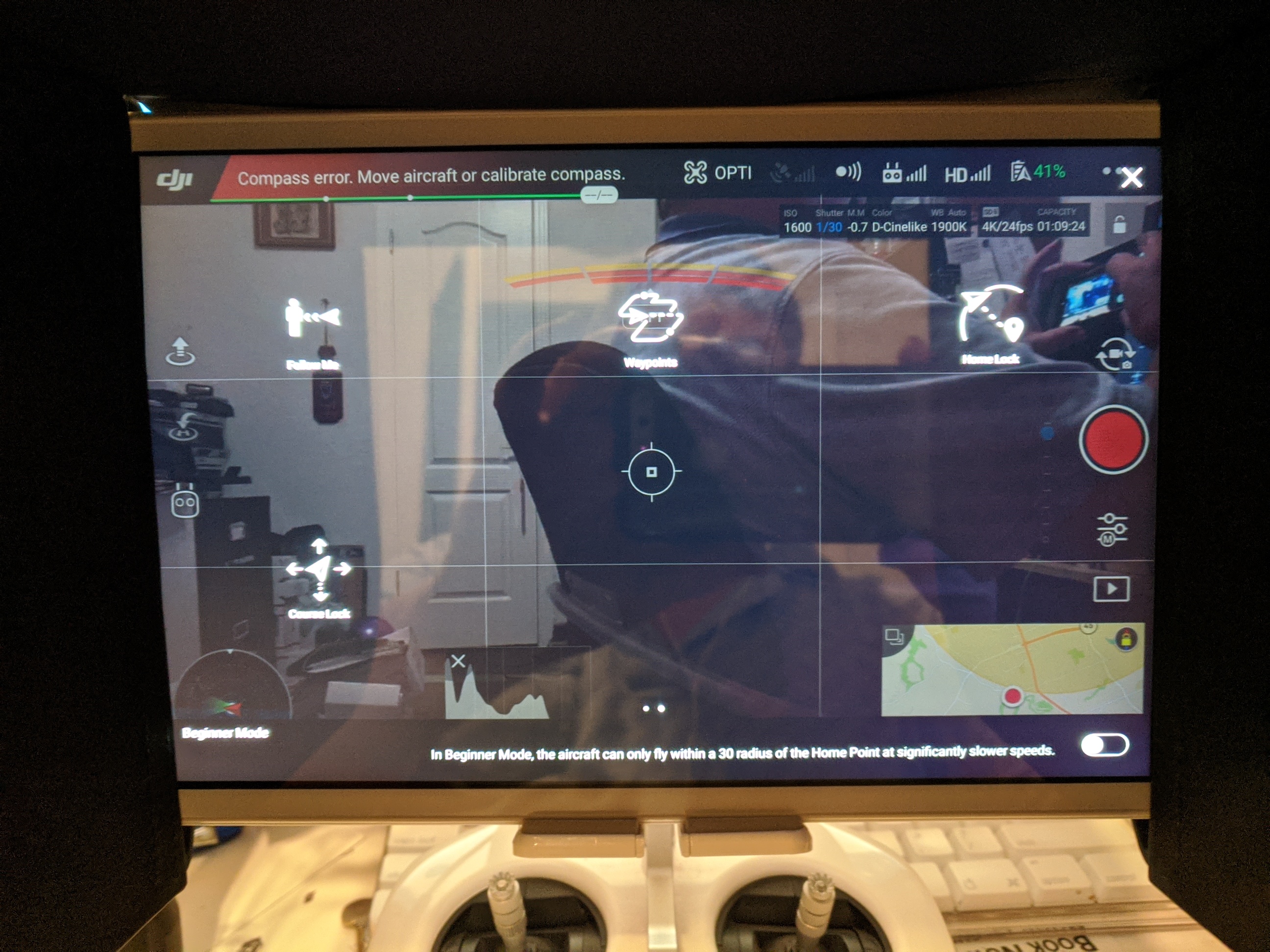

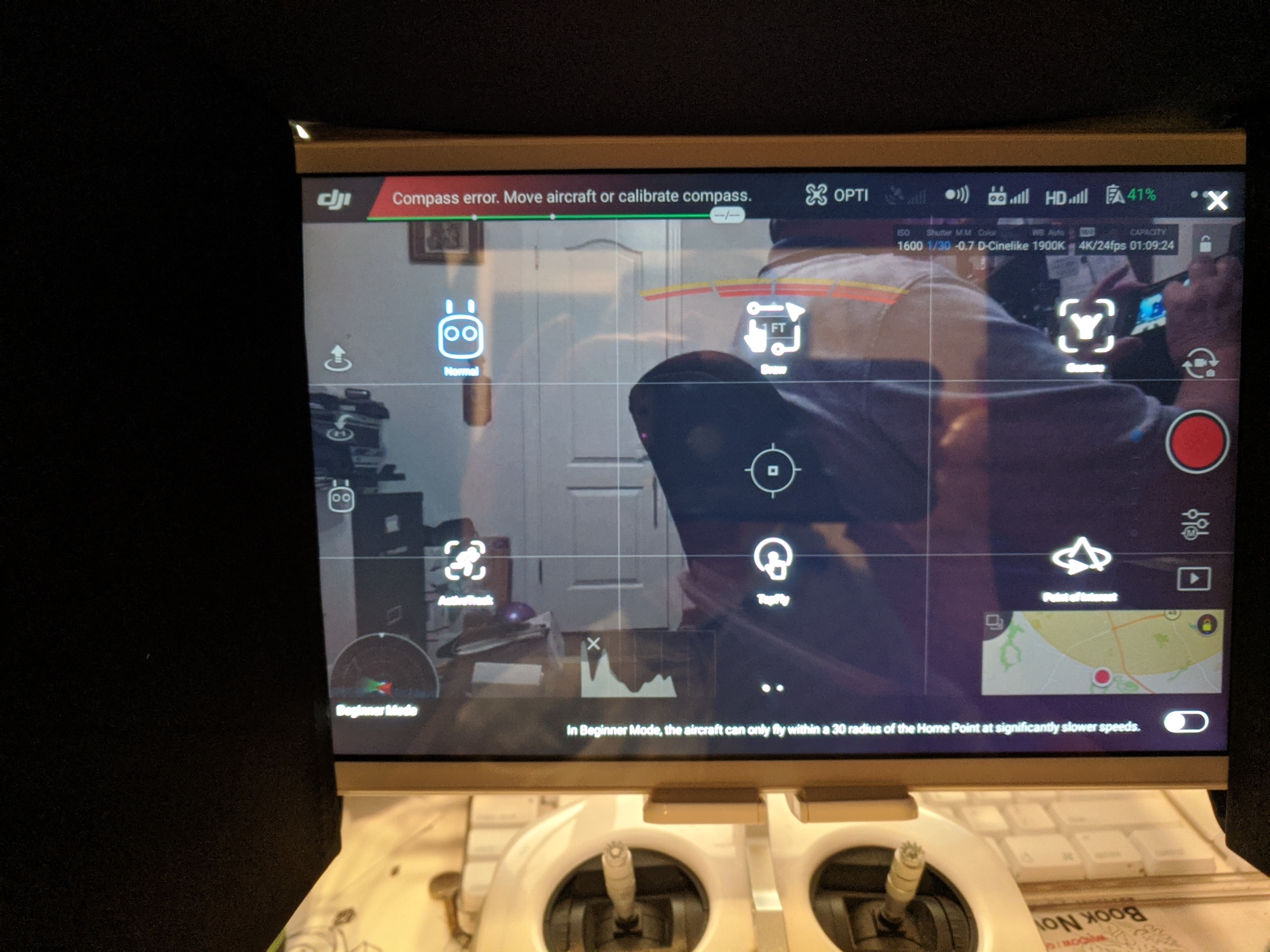

Still doesn't appear. Bought Litchi, now trying to sort out all the modes etc. with it. It does seem to have a tripod mode, but I don't know if it works with a POI circle or if it isn't needed cause you can set the speed etc. in the app.
I took two photos of the two screens of photo modes. Blurry, sorry, but you would know from the icons what they are. No tripod.
