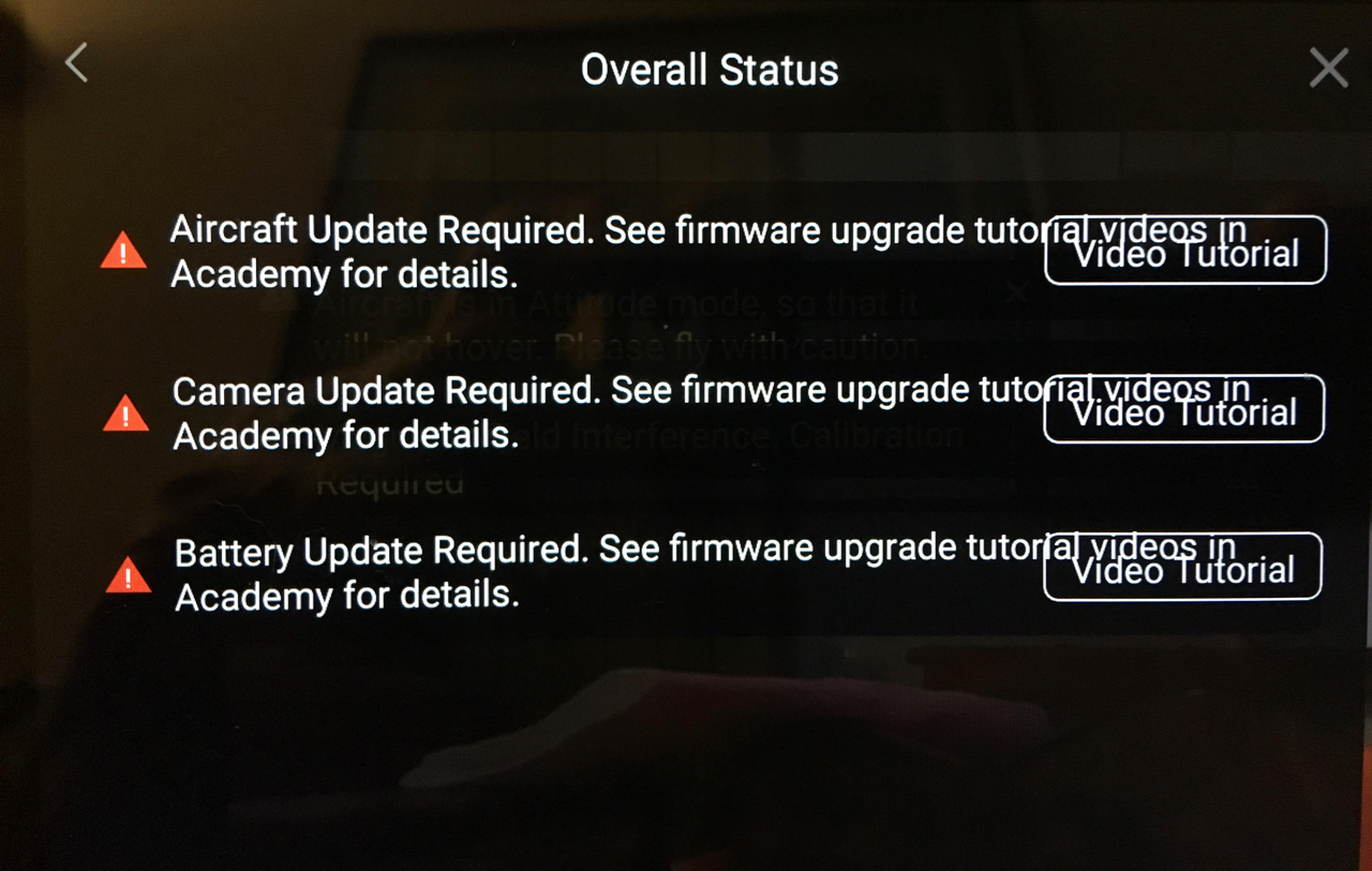

Turned on my rig (minus props) P3A so that I could go through the menus and check the settings.
The only thing I changed was the brake settings g, dropped it from 100 to 80 just to smooth it out a bit.
]Suddenly everything seemed to go mad, the LED's on the drone flashed all over the place and different colours and the display suddenly displayed the "update" message attached. As most on here know I've just done an update, not to the latest but to 1.4.10.
I turned off the drone but the battery "red LED on the ON/OFF switch stayed on. Pressed it twice and the battery turned on.
Turned off everything and back on and everything seems to be all right.
Bit scary.......
Bit scary.......View attachment 109196

Not sure but I think it might be something to do with a "magnetic field".
IThe drone was on a shelf over an large electric heater. After it had settled down again I attempted a compass calibration and it said "strong magnetic field detected" or similar, so I moved outside and the calibration went OK.
Unfortunately due to terrible weather I can't try it out!
Yeh that's OK normal if close to metal objects or steel garages,,even with magnets in tablet or phone it seems to pick up other interference rather than what's in the device,,,,,,I still find it strange myself..yes enjoy your flight,,my turn for bit of rain on the coast
